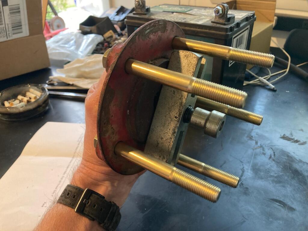

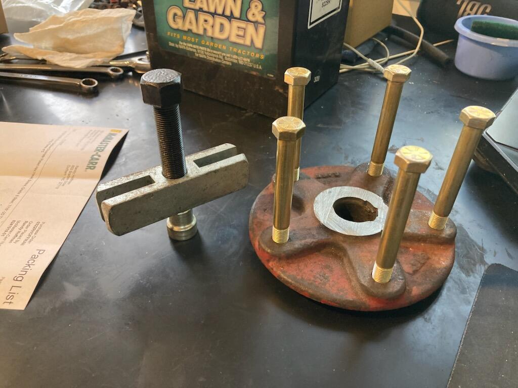

ineedanother 2,885 #3 Posted April 29 And don't use a hammer. The axle is secured with a clip inside the uni-drive and you can dislodge it which means you'll have to open the case to fix that. This is a really cheap puller that I made from an old hub. Works great with an impact wrench. 7 1 Share this post Link to post Share on other sites

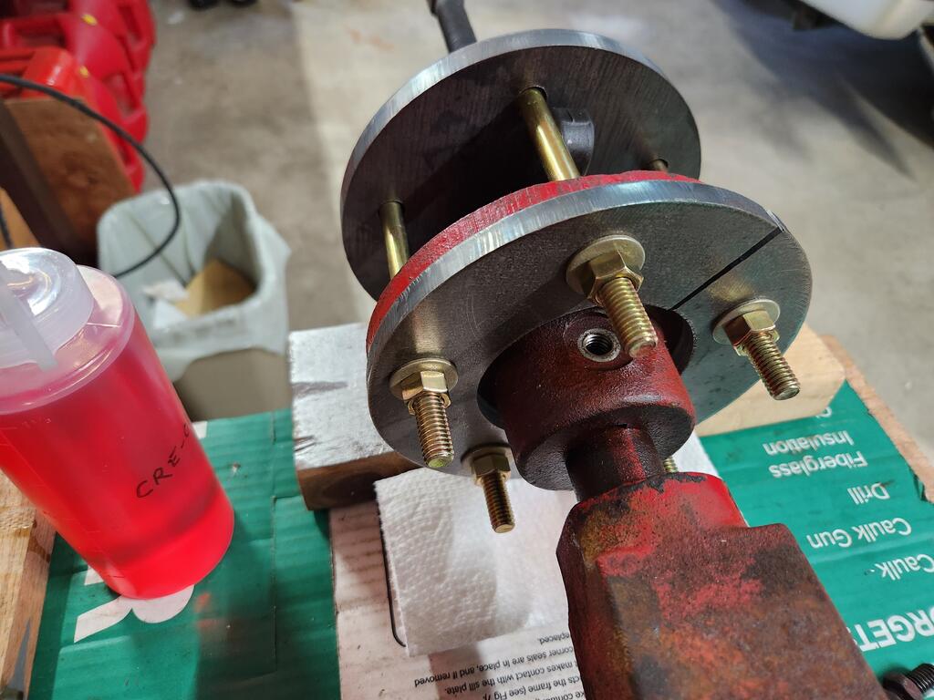

Racinbob 13,290 #6 Posted April 29 I picked up a couple round steel plates and made these. I also have a third plate with plans to make a back plate with a smaller center hole to hug the axle going behind the entire hub. That might be nice in situations where there's enough gap between the case and hub. 1 4 Share this post Link to post Share on other sites

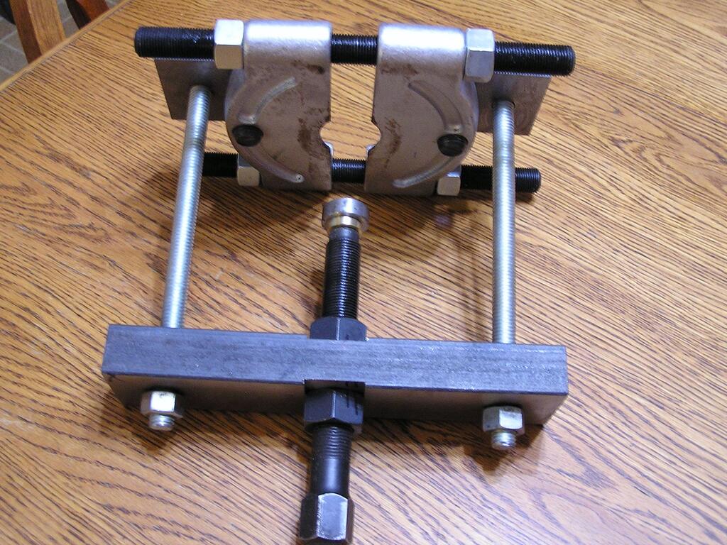

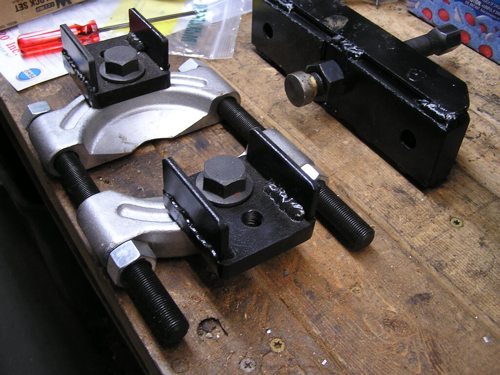

ri702bill 13,392 #8 Posted April 29 (edited) 10 hours ago, mrc said: most of the guys here make a puller.. i used an old beat up hub. DO NOT USE A 3 JAW PULLER!!! YOU WILL MOST LIKELY BREAK THE HUB. others will concur best of luck to you. hub pulling and steering wheel pulling are the worst wh jobs As Mike mentioned, a 3 jaw puller is NOT the right tool for this job. I made up one using a large bearing seperator, an existing Snap-on fine-pitch (preferred) puller screw with stationary tip, and machined parts. It pulls from behind the hub just outside the shaft... Had to add stiffener plates as pictured. It works well. ALSO - while the puller of choice is installed and under tension - tap the end of the puller to shock the hub. Sometimes, that makes the difference to get it to move... Edited April 29 by ri702bill 1 2 Share this post Link to post Share on other sites
