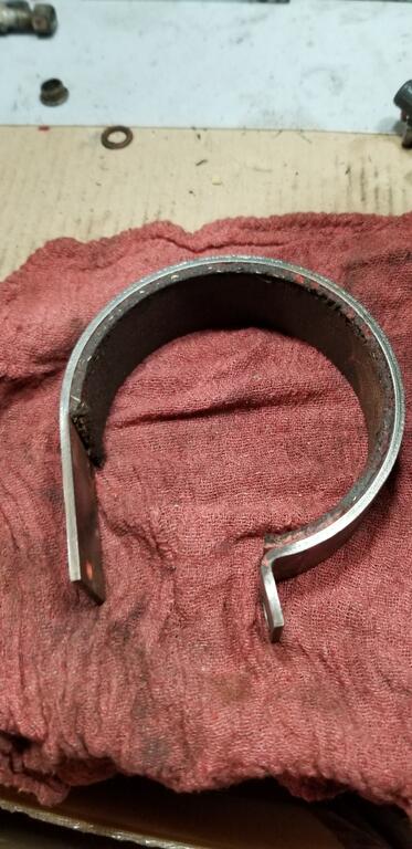

gt14rider 1,278 #1 Posted April 18 Hi all, question, how to remove old liner and not kill my self. I don't want to suck in any of that liner. 1 Share this post Link to post Share on other sites
gwest_ca-(File Mod) 12,488 #2 Posted April 18 That lining looks good. I would hit it with brake cleaner which was the original intended use of the product. 3 4 1 Share this post Link to post Share on other sites
ri702bill 13,061 #3 Posted April 18 Yup. Just don't breathe any of that in either. Spray it, don't soak it. While it is wet, wipe it with a clean rag. Repeat as needed... If you insist on removing the liner, warm it up to about 175 degrees. Toaster oven or the top rack on the grill.... The liner should then peel off. 1 2 Share this post Link to post Share on other sites

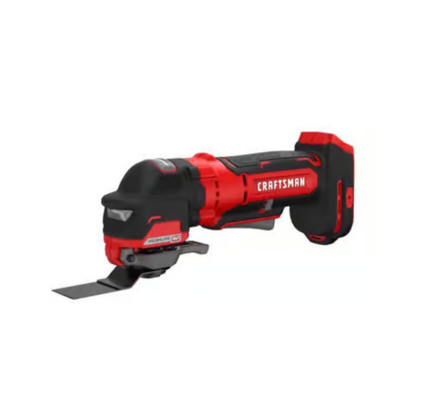

rmaynard 17,582 #4 Posted April 18 As far as removal, I have been successful using an oscillating saw with a scraper blade. If the scraper blade doesn't work, use a more aggressive blade. 2 2 Share this post Link to post Share on other sites
sqrlgtr 3,930 #5 Posted April 19 The last one I changed I just started prying it off with small stiff putty knife and it finally just popped off. 6 hours ago, gwest_ca said: That lining looks good. I would probably just run with that one myself unless it's wore a lot more than pics are showing. 2 Share this post Link to post Share on other sites
