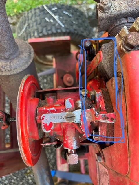

Hello,

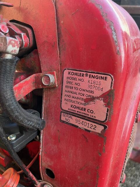

I've lost the cable that connects the regulator to the carburator on my Kohler K181s 8hp engine (see pictures). Do you know where I might be able to find this piece, or get a 3D model so I can check the dimensions?
Thanks in advance,
Romain

This may be it. Click on the > arrow to roll it over. Those are likely 1" squares.
https://www.partstree.com/parts/kohler-230078-s/

On my K181 it measures 2-⅝”  (2.625 inches) from outside to outside at the parts of the wire that pass through the governor arm and the throttle actuator. The wire is 5/64” (0.07812 inches) thick.

@Handy Don got you covered on dimensions and an old Throttle cable is good to make one out of. Couple z bends and get close to the dimensions posted above and should be good to go.
