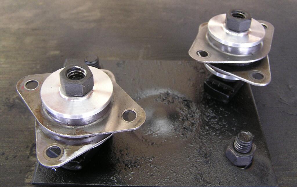

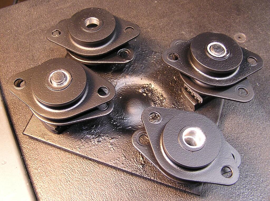

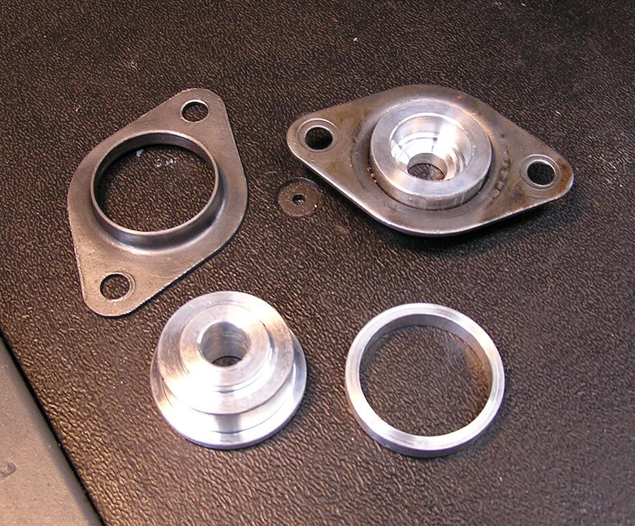

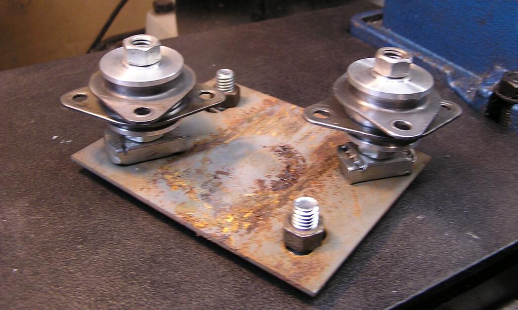

ri702bill 13,060 #1 Posted April 4 (edited) Work continues on the C81 I picked up last July. Three of the four shaker plate isolation mounts were bad - one far worse than the rest - the steel center sleeve was completely broken out of the rubber. All 4 were questionable on the parts donor too. The fix I decided on was to reuse the eight steel flange shells and discard the rubber & sleeves. I made up four make & four female aluminum inserts - they pilot into each other when assembled. An 8 inch length of 1-1/2 diameter aluminum set me back about 14 bucks. Additional centering rings were made to pilot into the steel plate. Not having CNC capability on my lathe, it was fairly labor intensive to turn up the aluminum parts, but the result almost looks like the originals when I did the powder coating... Edited April 4 by ri702bill 5 12 Share this post Link to post Share on other sites

ri702bill 13,060 #5 Posted April 5 (edited) 47 minutes ago, Dan 312-8 said: Definitely! @ri702bill You had me at doing your own powder coating! That was a short dollar investment my son purchased about 10 years ago. HFT had both the machine and the pound of black on sale. He went thru 2 containers doing small car parts. The other two items are a dedicated toaster oven - $5 at a yard sale and a low pressure inline air regulator and a 0 to 30 PSI gauge. The process out gasses heavily - hence the dedicated oven. Edited April 5 by ri702bill 3 Share this post Link to post Share on other sites

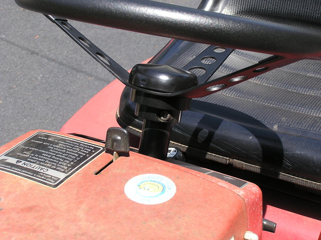

ri702bill 13,060 #6 Posted April 5 47 minutes ago, Dan 312-8 said: Definitely! @ri702bill You had me at doing your own powder coating! My first powder coated tractor part was the 2-pc steering wheel adapter for the C81 that I made about 5 years ago.. 1 Share this post Link to post Share on other sites
