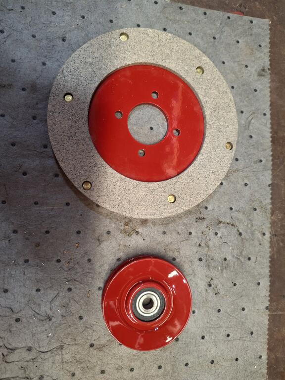

ri702bill 12,694 #3 Posted April 4 (edited) Lowell sells an aftermarket one too. You can undo the rivets and replace the bearing - reassemble with #5-40 button head screws & nuts. Edited April 4 by ri702bill 2 Share this post Link to post Share on other sites
