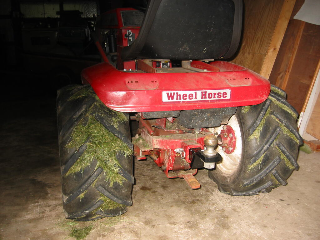

John c 223 #1 Posted April 3 (edited) I found some clean 23x8.5 wheels the other day I thought would be ideal for my B100 project. Has anybody got pictures they could share of a 10.5in and a 9.5in turf master or multi-trac tire pattern mounted on an 8.5in wheel? Also could anybody tell me the measurement across the tread of the mounted tire. I want the shoulder to be as square and the tread as flat as possible thanks Edited April 3 by John c 1 Share this post Link to post Share on other sites

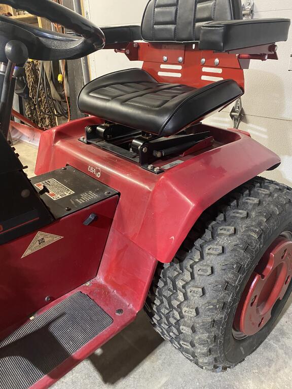

DLF 74 #5 Posted April 8 These are 23 x 10,50 x 12 on 8.5 rims with 3 1/4" back set they work as the 308-8 doesn't have a rear mounted gas tank. Share this post Link to post Share on other sites

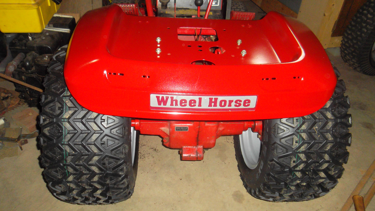

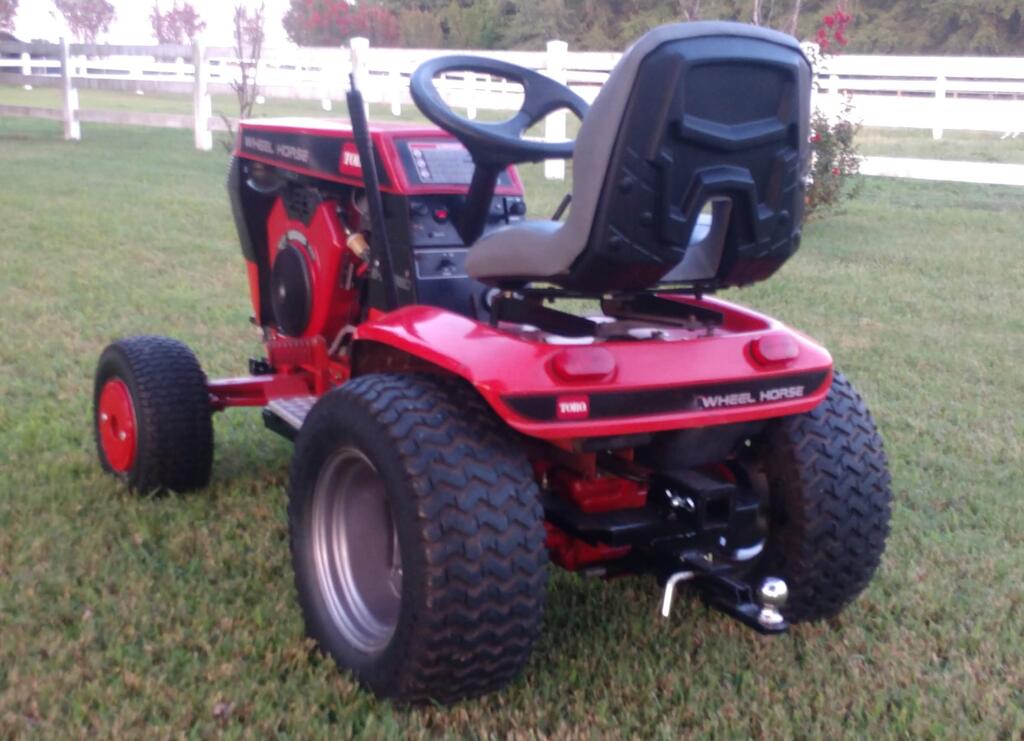

kpinnc 18,967 #6 Posted April 8 (edited) 23x10.50 turfs mounted on standard 7.5 wide Wheel Horse wheels. 1 inch wheel spacers. Edited April 9 by kpinnc Share this post Link to post Share on other sites

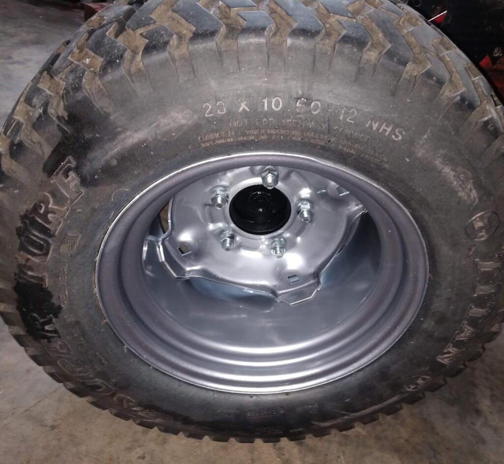

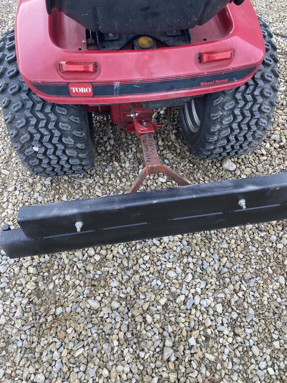

Tonytoro416 1,387 #7 Posted April 8 23-10.50 on 8.5” wide wheels 3/4-1” wheel spacer because of it being a hydro machine 1 Share this post Link to post Share on other sites
rick 316 #8 Posted April 9 I replace my tires on my WH tractors with the OEM size and type. I have one set of 71/2" wheels with Carlisle ags mounted for garden ploughing. When I need traction for snow plowing I use chains on turf tires with WH plastic covered wheel weights installed. Share this post Link to post Share on other sites

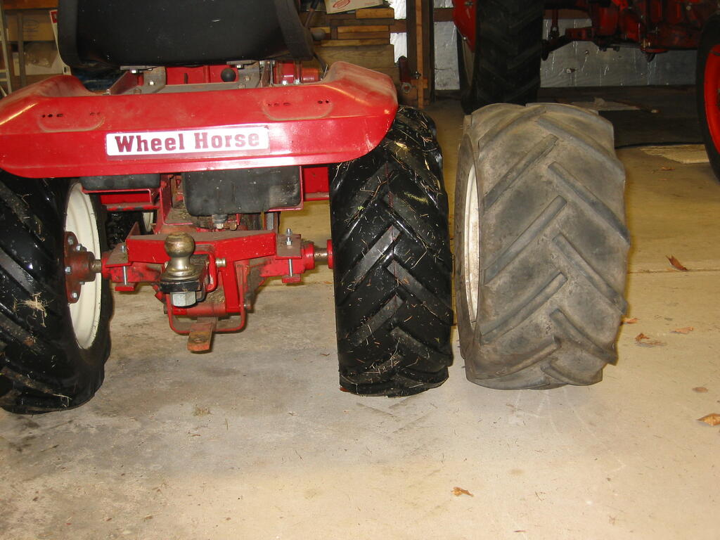

pfrederi 21,151 #9 Posted April 9 23 10.50 x12 Left Deestones on 7.5" rim Right Carlisle on 8.5" rims The Carlisle went on and have worked great I don't run chains Share this post Link to post Share on other sites
