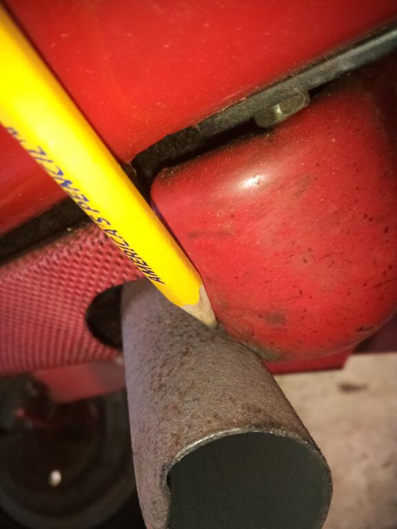

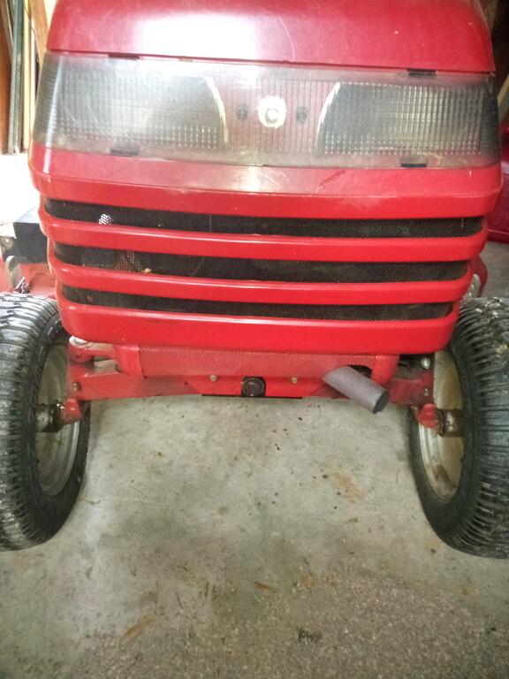

ROK2024 6 #4 Posted March 30 Hi GWest & JoeM.. BINGO.. the Muffler sounds solid with the Tap test, but when tapping I bumped the Muffler Shield and Ting there it was.. so Kudo's to Joe for a good ear calling the muffler Ting. With the engine not running with just a very light tap on the shield rings the pipe like a little bell. Oh, I'm so happy.. ;-} Thanks a lot. goes to prove three heads are better than one. Here are pics of the shield and contact point. 6 Share this post Link to post Share on other sites
