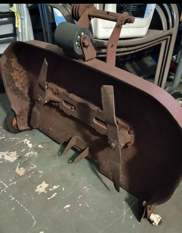

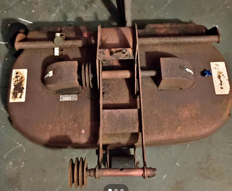

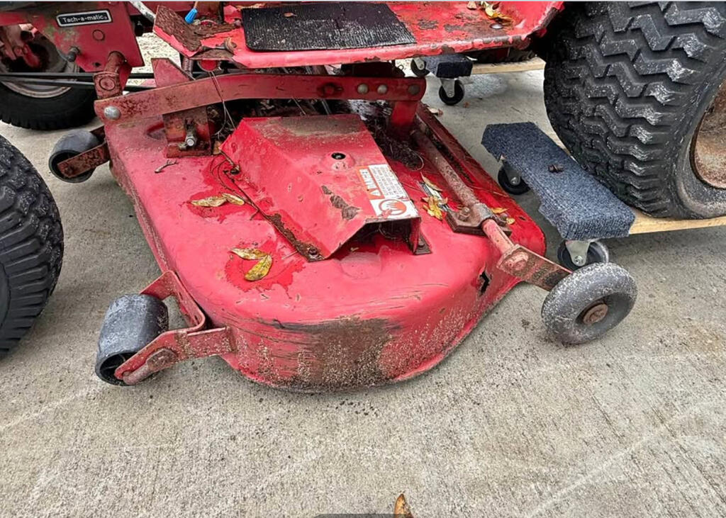

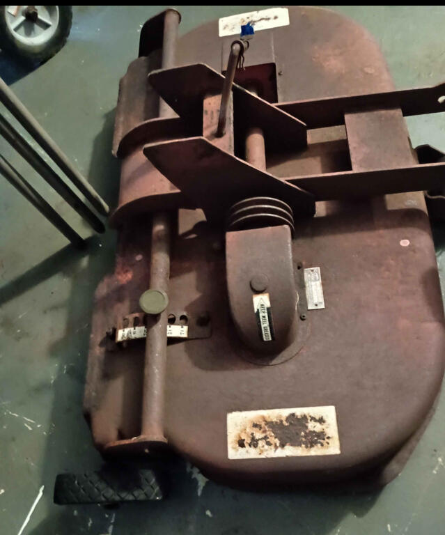

FLtractor 134 #4 Posted Monday at 02:19 AM 9 minutes ago, 702854boy said: I believe the 856s would have either a 32 or 36 inch deck, however, they do not make the 32 inch blades anymore so it would be better to get a 36 if you find one, I'll find a photo of one and post it. My 856.. previous owner told me needs new gauge wheel and spindles.. I have not yet taken off deck to look exactly how bad or what it needs.. just wondering if all those parts can add up to more than just finding a complete replacement deck.. one seller near me is selling a 312-8 deck with small hole for $85.00 Another seller selling 32 inch deck in good rebuild able condition- but as you just informed me no longer make those blades. Unless could buy them on marketplace given not many Wheelhorse deck opportunities central Florida. Have attached the for sale decks 312-8 deck 1 picture 32 inch deck 3 pictures Share this post Link to post Share on other sites
702854boy 585 #5 Posted Monday at 02:25 AM The 36 I'm not sure if it would be able to be modified to fit or not but the 32 inch deck, the blades look pretty decent and barely used, and if taken care of properly they could probably last you a while, we still have the original blades from the mower deck for our 702 and they are still usable. 1 Share this post Link to post Share on other sites
702854boy 585 #6 Posted Monday at 02:27 AM If you decide to get one of them, definitely pay attention to how the blades go on the 32, as they appear to be on the opposite sides they are supposed to be in the photos. Share this post Link to post Share on other sites

Handy Don 16,055 #12 Posted 17 hours ago On 3/29/2026 at 10:27 PM, 702854boy said: If you decide to get one of them, definitely pay attention to how the blades go on the 32, as they appear to be on the opposite sides they are supposed to be in the photos. One possible reason for the extremely light wear on the blades of that 32" gear deck (and maybe part of the incentive to sell it?) could be that the blades are on the wrong spindles and thus “leading" with their backs to cut instead of the sharpened edges. Pretty lousy cutting performance that way. Correct rotation is that the cutting ends sweep toward the rear of the deck along the outer edge and then toward the front of the deck in the center. That bracket at the rear underside of the gear deck should have an anti scalp roller in it. 1 Share this post Link to post Share on other sites
ri702bill 11,545 #13 Posted 16 hours ago (edited) The timing of the blades appears to be adequate, but not optimal. As shown, one should be vertical, the other horizontal. The swept path is an overlap - the blades must be timed so the tips do not collide - think about a WW1 fighter plane shooting a machinegun where the bullets go thru the spinning propeller. Similar results if not timed!!ing is done thru the mesh of the cross shaft end gears to the spindle gears. Edited 16 hours ago by ri702bill 1 Share this post Link to post Share on other sites
