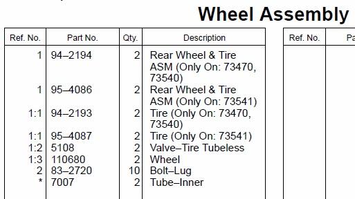

wind77west 14 #1 Posted 18 hours ago What type of tire is the wheel horse part # 94-2193 & 95-4087 Share this post Link to post Share on other sites
gwest_ca-(File Mod) 12,061 #2 Posted 17 hours ago A golden one studded with diamonds and the 2nd one is slightly lighter. https://www.partstree.com/parts/toro-94-2193/ https://www.partstree.com/parts/toro-95-4087/ 2 Share this post Link to post Share on other sites
gwest_ca-(File Mod) 12,061 #3 Posted 16 hours ago 1998 518xi model 73470 1998 520xi model 73540 1998 520xi model 73541 - Export model 520xie Share this post Link to post Share on other sites
wind77west 14 #4 Posted 48 minutes ago Thanks for the reply's. My real questions is that is either of those part numbers a bar tire or a turf saver tire and if a bar tire what size? I am trying to fine what size bar tire will fit on a 518xi with a 52 inch deck. Share this post Link to post Share on other sites
OoPEZoO 594 #5 Posted 28 minutes ago (edited) Stock rear tire size for the 5xi tractors is 23x10.5x12 for all configurations. You may be able to go larger, but that gets very setup and tire brand/size specific. Personally, I run 26x12x12 on mine but I don’t have a mower deck on that rig Edited 27 minutes ago by OoPEZoO Share this post Link to post Share on other sites
