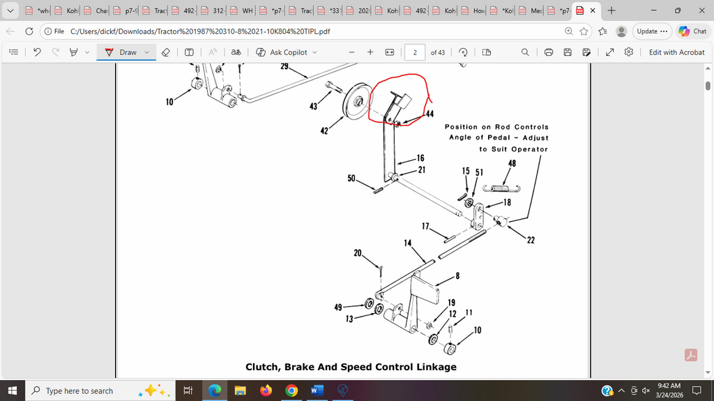

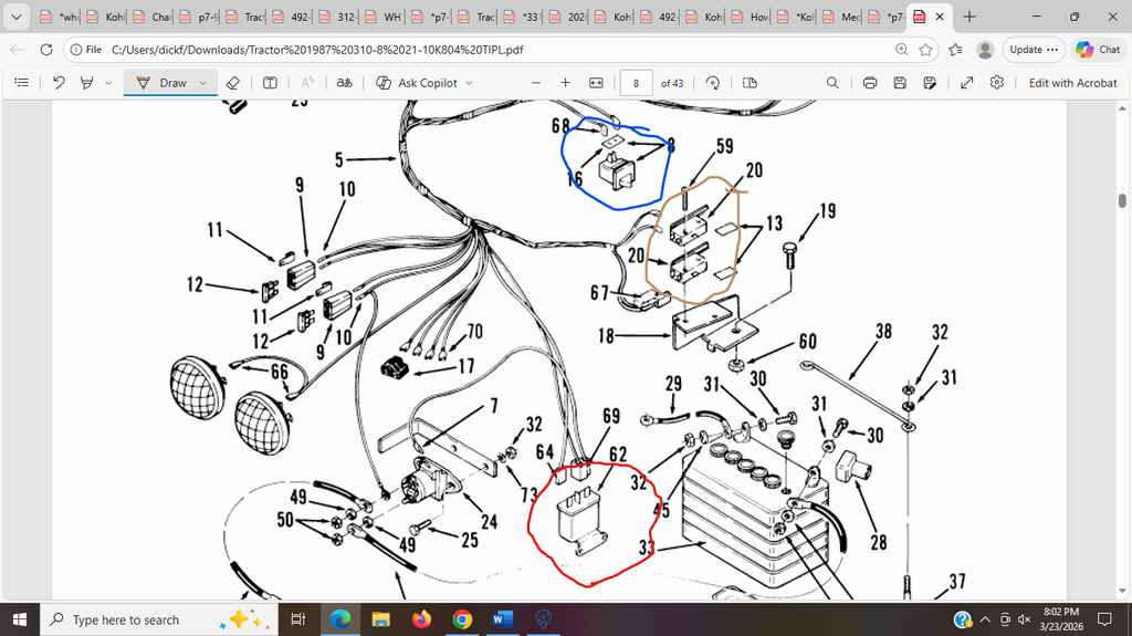

953 nut 70,661 #26 Posted March 24 I do not own this model year 310-8 so am not positive where the switches will be located. In the drawing below the low oil relay is circled in RED, the clutch switch is circled in BLUE, and the PTO switches are circled in Brown. 1 Share this post Link to post Share on other sites
JCM 11,470 #27 Posted March 24 Clutch neutral safety switch. # 8 in diagram. It's a white rocker type switch. Share this post Link to post Share on other sites
953 nut 70,661 #28 Posted March 24 Your clutch lever has a tab on the side opposite the idler pulley that will actuate the clutch switch. Share this post Link to post Share on other sites

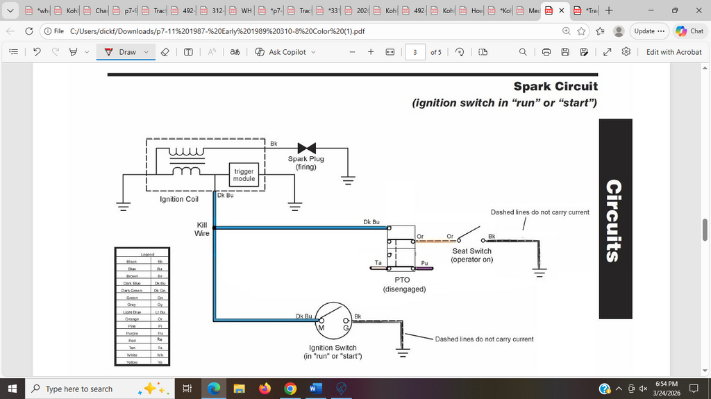

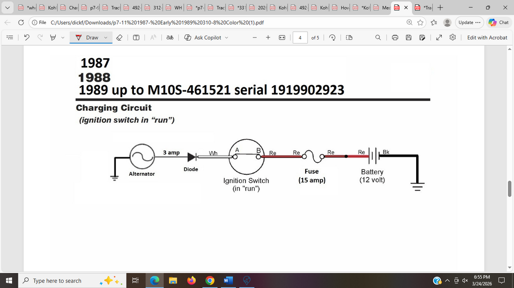

953 nut 70,661 #33 Posted March 24 2 hours ago, Railboy said: See, I am learning what the Stator is or not grounded to work? But do know it charges the battery. And the Coil, with its White Wire, is or is not, supposed to ground out doing the positive fuse lead of the battery to the Solenoid and relay at the same time. The white wire connects your key switch to the battery through the 15 amp fuse while the key is in the run position. If it is charging the battery leave it alone. The dark blue wire that goes behind the engine cover allows the magneto to produce ignition power while the key switch is in the run position, your ignition works so leave it alone. If 12 volts were to be applied to it you would allow the expensive magic smoke to come out.; The wiring on these units is not very complicated. You have no low oil switch, remove the low oil relay, (you have a picture of it to go by from yesterday's post) connect the Light blue and purple wires that are on the relay and that will be the end of that conversation. Remove all of the light blue wires and relay highlighted in yellow, your oil switch has already been removed. Share this post Link to post Share on other sites

953 nut 70,661 #35 Posted March 25 (edited) 12 hours ago, Railboy said: Hello 953 nut, First, Thing is this, I thought the White Wire was a Coil Wire that gave the Coil Power for the Spark Plug completing the Magneto to have Spark? Hence it goes to the Key Switch and when you cut the Key off, it (White wire) kills power. Magnetos are self powered, magnets on the flywheel produce electrical power as they pass the magneto coil. NEVER APPLY 12 VOLTS TO THE WIRE THAT GOES TO THHE MAGNETO! Second, Connect the Purple after the Solenoid to the Light Blue before the Key Switch? Now why am I doing this on my Tractor? You do not have a low oil switch and are eliminating the low oil relay. See, I understand that going into the Oil Sender is a Ground, and when the Oil Sender actuate's it completes a Negative Circuit? Your low oil switch is gone, please foregit it ever existed. Am I wrong? But if I am wrong I am wrong, but wondering what I am doing in doing it? ? ? What are you saying? Please explain for the Oil Sender from all I have gathered is a Negative Circuit grounding out a relay. THE LOW OIL SWITCH IS GONE, IT NO LONGER EXISTS. Something I wanted to do and this and this is not possible I don't think do to the Blown 15 amp. Fuse and tractor is running, I would like to put a meter to the wiring through there shielding to check voltage, but, with the blow fuse, I have a dead circuit to follow and its possible Power Output, which negates my intentions from the beginning, testing I ideas. Check one wire at a tome to see if any wire other than black wires are grounded. This is why I am into doing and have been doing continuity test on everything. Checking for continuity to ground could help you find a wire that is grounded causing the fuse to b low. Thing is I have not melted anything down yet, and hope to remain this way. My tractor is a 1987 Wheel Horse 310-8, so bear with me on collaborating the diagram to my tractor? But yes, see in the (Starter Motor Circuit) Diagram how things work, but how to test before just "connecting" wires? I have Alligator Clips for Jumpers. Yes, I like to be thorough, and yes, I can do circuit test before making "long lasting wire connecting" for testing to see if they work before making them permanent. And all I am trying to do is keep the Fuse from blowing and get the Dash's Voltmeter working to charge the battery. The 40 year old volt meter on your 310-8 may not work as well as your multimeter, check to see if they both read the same. Which brings me back to the mid section and beginning that we need to look into. Does not the Stator have two wires and not the White wire which I was told is the Coil Wire? Your engine runs, stay away from the ignition system and the charging system until the blown fuse problem has ben solved. On my connector they are Yellow and Black, these I was told are the Stator Wires, this is the engine side of the connector. And something here I picked up on, the Black wire and Yellow wire on the engine side of the cover do not co-inside with the diagram, forget the deal there, but the white remains white thus is the coil power supply from the ignition. The colors on the tractor side of the connector are Wheel Horse colors and are the same as the wiring diagram, the other side of the connector is Kohler colors and may not be the same. Sorry, sorry if the above is wordy. Going over a lot. None of what I have written here is new, it has all been covered before. You need to stop abscessing about the low oil switch and POLARITY. A blown fuse is the result of a wire being grounded, check the wires for a pinched wire or insulation that has been damaged. With the battery disconnected, do a methodical step by step check of your wiring, one wire at a time. When checking the wires from the ignition switch check each one in all positions, OFF, RUN, START. Let us know what you find. Edited March 25 by 953 nut Share this post Link to post Share on other sites
Railboy 13 #36 Posted March 25 (edited) @953 nut, So I have to apologize for the wrong info I had of first hand information on the way the Oil Sender worked. I was told it passed along a negative polarity if the engine ran low of oil thus shutting off the engine, or illuminating the light. I have never seen this but was told this. So, on my Oil Sender I have two leads on it coming out that were cut at time of rebuild. And these two leads were or are on the diagram positive in and positive out unless Oil Sender actuates? So, this is why I need to tie the Purple and Light Blue wires together, to mimic the positive polarity keeping a circuit bypassing the relay all together? Then, that is that? Should not blow anymore fuses for the relay has been by passed and Oil Sender out? Thank you for your time. Edited March 25 by Railboy Share this post Link to post Share on other sites
Railboy 13 #37 Posted March 25 (edited) Ok, and up date after looking over the Tractor. The relay at the Tan Wire goes to I do not have. It looks like a Seat Switch Relay. I do not have a Seat Switch, so guess that is why it was taken out. So, connect the Solenoid's Purple Wire at the 1/4" Nut of the Purple Wire to Light Blue that ties into the Ignition. Gotcha. So, in doing so, pull the Relay out that the Purple went to? This will get rid of all Electrical Safety Switches? Thank ya'll for the time. Edited March 26 by Railboy Share this post Link to post Share on other sites
