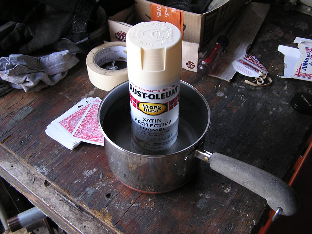

And use a trick from my old building model car days from 50 years ago. Warm the paint can in a pan of hot tap water. It raises the pressure in the can - gives a better finish. And it flashes off faster between coats....
