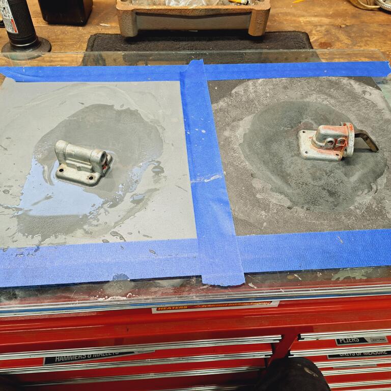

WHX??
Glass the halves and don't overtighten the screws is the best advice I can give.
