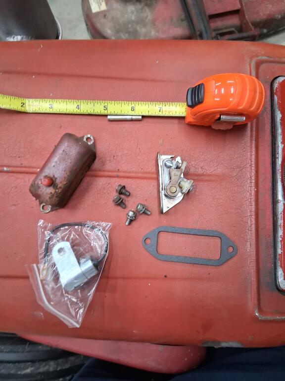

702854boy 1,199 #376 Posted June 23 (edited) @BlaineUpdate: The push rod I have is 1 1/2 inches long. If that will work for you you can have all of the stuff in the picture. If the push rod won't work you can still have everything else if you want it. Edited June 23 by 702854boy 3 Share this post Link to post Share on other sites
Blaine 276 #377 Posted June 23 10 minutes ago, 702854boy said: @BlaineDo you know how long of a push rod you need? I believe the small block is shorter than the big block push rod, i know the points are the same, and i’m only assuming the covers are the same also, but we’ll find out. Thank you. Original Kohler Part Number: 47 411 04-S (often replacing earlier 47 411 01-S or 47 411 01versions) 0.184 " in diameter and 1.550 " in length according to AI search Share this post Link to post Share on other sites
702854boy 1,199 #378 Posted June 23 (edited) According to my tape measure they measure the length you stated above, you can have them and see if they'll work if you'd like. Don't want anyone having to go home with a dead horse, thats happened to us before and its not very fun. Edited June 23 by 702854boy 2 Share this post Link to post Share on other sites
Blaine 276 #379 Posted June 23 I’m seeing closer to 1.250” on your tape measure… about 1/4” short. Share this post Link to post Share on other sites
702854boy 1,199 #380 Posted June 23 (edited) Yeah, I realized that after the fact that I apparently can't read a tape measure tonight. We do have a 14 horse that if i can get the push rod out of you can still have all of the stuff. Update, the push rod is not wanting to come out of the 14 horse but you can still have the points, condenser, and cover, and gasket, and screws to help narrow down your search. Edited June 23 by 702854boy 1 Share this post Link to post Share on other sites

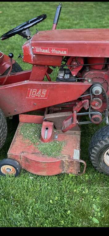

stevebo-(Moderator) 8,742 #385 Posted June 23 If anyone has a nice, original 1045 deck like this one shown (square style) I would be interested so long as price is fair. Thanks! 1 Share this post Link to post Share on other sites

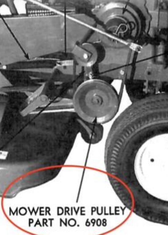

Blaine 276 #386 Posted June 23 13 minutes ago, 953 nut said: That would be a 103990 ignition switch. This drawing will give you a start in the right direction. This is presuming you have a starter as opposed to a Starter / Generator. If you have a S/G we have a drawing for that too. Yes, it has the starter. Bushings in it were dry, so i cleaned things up in there and lubed it. Brushes are looking pretty short but it sounds like it’ll work for now. I’ll have to see if my switch is a 103990, but i don’t think so…i don’t think it has that many terminals. Things might pan out to be mowing with Whitey this weekend if i can find the 6908 drive pulley, a 1563 belt, and a side PTO in Ed’s buckets. Share this post Link to post Share on other sites

squonk 48,303 #388 Posted June 23 30 minutes ago, Blaine said: Things might pan out to be mowing with Whitey this weekend if i can find the 6908 drive pulley, a 1563 belt, and a side PTO in Ed’s buckets. Belt is a 4L390 1/2" X 39" 1 Share this post Link to post Share on other sites

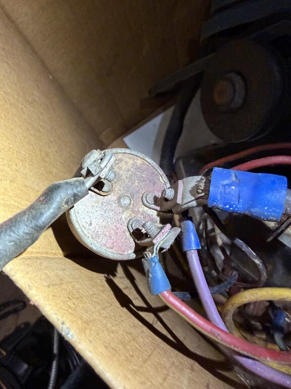

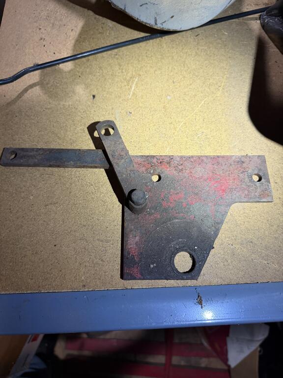

Blaine 276 #392 Posted June 23 1 hour ago, 953 nut said: Having been a breakerless ignition system on a '70s tractor it wouldn't have the five terminal more modern ignition switch. While at the show you can look for the 103990 switch and a "Pigtail" for it. Sorry, i was referring to another switch i have, maybe from my long gone 867. It’s a 3 terminal that doesn’t use a starter relay. I’m not too concerned about a switch as i can work with what i’ve got. I could just add a hidden toggle switch to power the coil. Kinda like an anti-theft device. Lol while looking for the switch i found a side PTO, but it’s not slotted, no hole for the latch, and missing the pulley, so it could be made to work, but i’ll still need a latch also. Share this post Link to post Share on other sites
