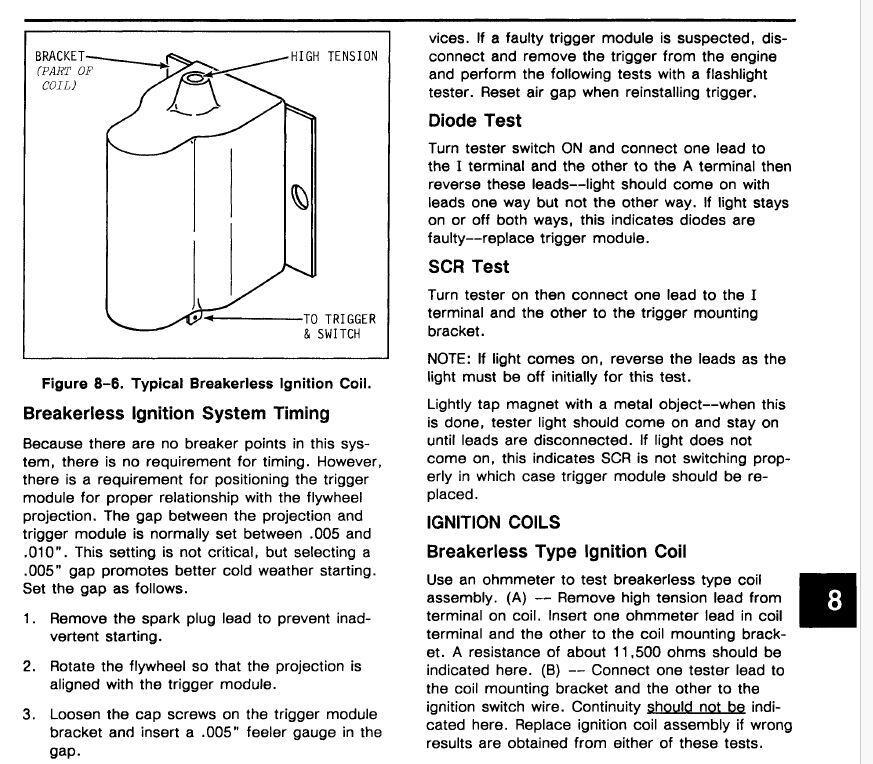

Breakerless ignition does not use points or condenser.  It is pretty much a binary system..it works great or not at all.  You might test the coil when it is hot. You could check the air gap but I doubt that is an issue.  also put a spark plug tester on it...does the spark stay strong when it is acting up?

I guess one thing that i was just thinking, is there a way to verify ignition timing on these breakerless engines? If theres a potential of the timing being too advanced?
pfrederi
You cannot adjust the timing on a breakerless system. The trigger is only adjustable in and out from the flywheel and even the manual indicates that gap isn't critical.  also there is no way it can change based on heat...
