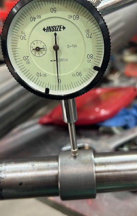

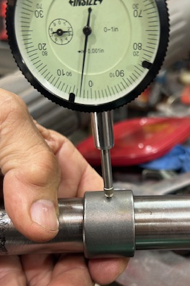

Tgalo 128 #11 Posted March 1 Well, the hub slid right off thanks to the leak. It does have some radial play but how much is normal? Seems a bit much to me. The oil seems clean and I don't hear any noise when I rotate the wheel, its smooth. Going to put a seal in and see what happens. If it still leaks, I know I can get the bearings. Thank you pfrederi for those numbers, I'm going to order two of each as I have a bad feeling. T Share this post Link to post Share on other sites
pfrederi 20,819 #12 Posted March 1 Axle move in and out about 1/8" OK Axle move up down back forward at all bad news... 4 Share this post Link to post Share on other sites
Ed Kennell 46,448 #13 Posted March 1 8 minutes ago, Tgalo said: It does have some radial play but how much is normal? If you can feel radial movement, the bearings probably are going to fail. Best to replace before a ball ends up in the tranny. 3 Share this post Link to post Share on other sites
Tgalo 128 #14 Posted March 1 Yup, I agree, thanks again 1 Share this post Link to post Share on other sites
JoeM 10,068 #15 Posted March 1 1 1/8 axle with a new bearing will have .002 to .003 play 1 Share this post Link to post Share on other sites
Tgalo 128 #16 Posted March 2 Well, were going to find out. I pulled the transaxle off the tractor last night and will bring it into work and go through it. Definitely had more than .003 of radial play. Want to power wash it before I disassemble it. 3 Share this post Link to post Share on other sites

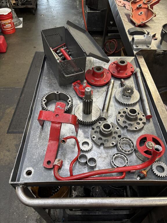

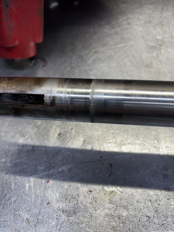

Tgalo 128 #17 Posted March 6 Got the unit torn down and clean. I have a pitted axle shaft but the radial bearings feel fine. Best place to find some good used axles? Thanks, T 1 Share this post Link to post Share on other sites

lynnmor 8,871 #19 Posted March 6 A to Z Tractor might be the best source of axles. 1 Share this post Link to post Share on other sites
