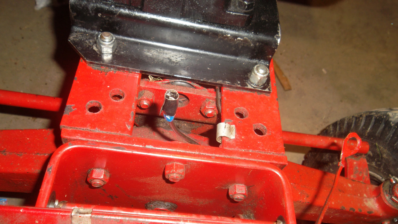

I'm swapping a K301 AQS series out of a "John Doe" into a '68 Raider 9 to replace the Tecumseh HH100. The AQS is a narrow base so I'm using the cradle mounts and deeper oil pan from a Wheelhorse with an AS series. Does anyone know if the cradles use the same mounting holes as the Tecumseh or a wide base K series?

The Cradle mount doesn't used the Kohler, Tesumesh holes. The cradle bars mount in front and belind those holes.
I think the two narrow holes on this 300 frame are for the front cradle bar. The 8 HP engine bracket is mounted in the same holes as the large Kohler and Tesumseh engines.
