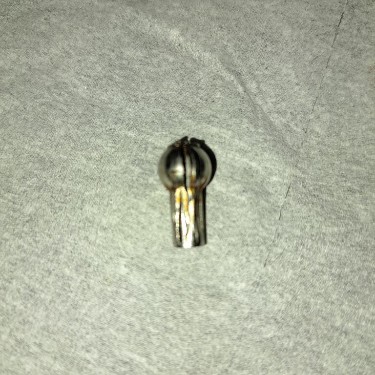

WHX?? 58,302 #26 Posted February 27 50 minutes ago, ACman said: as I’m sure you have racked your brain thinking of solutions . Ha I'm flying by the seat of my pants here! But yes a guy could just buy the ends Ineed posted and take them to a shop for crimping. The trouble with Lowell is he provides all the other items a guy doesn't need. I asked him once if he wanted the big bag of ends and sheaths I have accumulated over the years. Recycle ya know. Silly me ... he has tons of them already. Here's what happens to the ferules. Perhaps over crimped? It doesn't pass the SS magnet test. 1 Share this post Link to post Share on other sites

Lee1977 7,804 #28 Posted February 27 I have used alumiumn hex on cables drilled and tapped to hold cable with a set screw. They were used for control cables on gocarts, don't know if they would work in that heavy appaction. A friend silver solder the hand brake cable on my Toyota when I could not fine a replacement. Don't have any ideal what silver solder cost now. I do know the tempture isn't as high as brass. I tried brass and had the same results as 953 nut. 2 Share this post Link to post Share on other sites

WHX?? 58,302 #34 Posted February 28 (edited) Best he learns that slang here Don but heed our advice Boy and use it in terms of getting a ATV out of the mud. In other words stick to your engines and crocheting. Much more healthy. A $natch block is a heavy-duty, opening pulley used in rigging and vehicle recovery to redirect winch lines and technically double pulling capacity by reducing load on the winch. By attaching to an anchor point, it allows for pulling from difficult angles, Edited March 1 by WHX?? 1 2 Share this post Link to post Share on other sites
