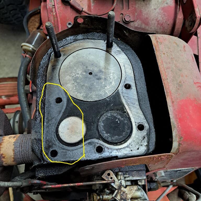

squonk 48,123 #26 Posted February 24 4 minutes ago, pfrederi said: Is there any evidence of significantly different failure rates between the two styles...assuming the head was in good shape in all instances??? I have not had any failures in ones of either type I installed. I have gotten tractors with head gasket problems of both types I think the big issue is this area of the block decks. Look at the difference with the rest of the surface. 1 Share this post Link to post Share on other sites
WHX?? 58,124 #27 Posted February 24 5 minutes ago, ebinmaine said: I don't get charged for shipping either. That is weird. Could be Squonky. I wire brushed the snot out of that area and seemed to look ok. Would stand to reason that's the area that is likely to leak since the hottest. 1 Share this post Link to post Share on other sites
Handy Don 17,474 #28 Posted February 24 3 minutes ago, squonk said: I think the big issue is this area of the block decks. Look at the difference with the rest of the surface. Highest temps in that area, right? 2 Share this post Link to post Share on other sites
WHX?? 58,124 #29 Posted February 24 11 minutes ago, pfrederi said: significantly different failure rates between the two styles. Not that I have noticed. Head bolts loosening up guess it doesn't matter what style. 1 Share this post Link to post Share on other sites

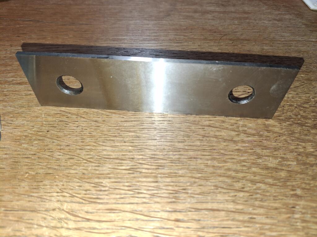

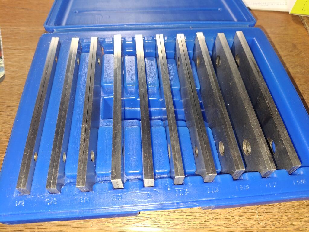

squonk 48,123 #30 Posted February 24 1 hour ago, WHX?? said: That is weird. Could be Squonky. I wire brushed the snot out of that area and seemed to look ok. Would stand to reason that's the area that is likely to leak since the hottest. I'm thinking distortion of the deck from the heat cycles. I picked up a small set of precision parallel blocks I'm anxious to try out on my Power King when I take it apart. 1 Share this post Link to post Share on other sites
WHX?? 58,124 #31 Posted February 24 1 hour ago, squonk said: thinking distortion of the deck Head wasn't bad as some. Did'nt take much glassing. 1 hour ago, squonk said: picked up a small set of precision parallel blocks pic and use??? 1 Share this post Link to post Share on other sites
squonk 48,123 #32 Posted February 24 2 hours ago, WHX?? said: Head wasn't bad as some. Did'nt take much glassing. pic and use??? Just 6" long precision ground straight edges. I can lay it across the deck and lookfora low spot. 1 1 Share this post Link to post Share on other sites
