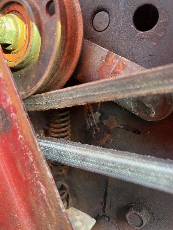

wallfish 20,576 #55 Posted February 28 (edited) It was warm enough to get out there and get that idler arm spring attached to its proper location. Changed the idler out too as it had some bearing wobble to it. I couldn't find a good spring so just used the old one for now but this will get revisited again since there are quite a few things on it which could use some attention Edited February 28 by wallfish 3 3 Share this post Link to post Share on other sites

Retired Wrencher 6,983 #57 Posted March 1 13 hours ago, wallfish said: It was warm enough to get out there and get that idler arm spring attached to its proper location. Changed the idler out too as it had some bearing wobble to it. I couldn't find a good spring so just used the old one for now but this will get revisited again since there are quite a few things on it which could use some attention John have you ever changed the bearings in one of those? Or they can not come out. I have one that squeals when you engage the belt so I’m thinking bad bearings? 1 Share this post Link to post Share on other sites
wallfish 20,576 #58 Posted March 1 1 hour ago, Retired Wrencher said: John have you ever changed the bearings in one of those? Or they can not come out. I have one that squeals when you engage the belt so I’m thinking bad bearings? No, There's always a bunch of pulleys in stock around here from so many projects that it's just simpler to change the whole thing. Seems a bad bearing would make noise all the time so I'd guess that squeal from the initial engagement would probably be from belt slip. 1 1 Share this post Link to post Share on other sites
Retired Wrencher 6,983 #59 Posted March 1 7 hours ago, wallfish said: No, There's always a bunch of pulleys in stock around here from so many projects that it's just simpler to change the whole thing. Seems a bad bearing would make noise all the time so I'd guess that squeal from the initial engagement would probably be from belt slip. They are new belts John. I guess no big deal. Share this post Link to post Share on other sites
