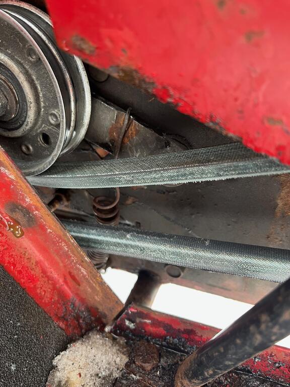

wallfish 20,618 #29 Posted February 23 UGH, tension spring for the 520-HC drive belt idler broke this morning on round one of snow clearing. Fun stuff to go back out there and repair it in the middle of the driveway under these wonderful conditions. It could always be worse! Just got warmed up so heading out to tackle it. 1 6 Share this post Link to post Share on other sites

wallfish 20,618 #31 Posted February 23 Well it was a little worse. LOL The drive belt was frayed and noticed the inside loop edges would touch each other when that idler was pushed down. Got the belt changed but still need to do the idler spring. Came back in to warm up a little. And I couldn't tell where that spring connected on the arm. 1 Share this post Link to post Share on other sites

wallfish 20,618 #33 Posted February 23 You know it's cold when you have to warm up the little propane tank with a heat gun in order to get a flame out of it! Used the torch to heat and re-shape that broken idler spring. Drive belt and tractor is back in business for now, although it will need some permanent attention when it warms up. 8 Share this post Link to post Share on other sites

wallfish 20,618 #38 Posted February 24 Got all the deep stuff done but scraping with the blade had to wait until tomorrow. This is what appears to be the spring location it was on but that doesn't look right to me. Like the notch was ground in to keep it from slipping but I'm assuming it should probably be connected somewhere else. Share this post Link to post Share on other sites

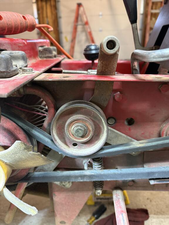

Sparky-(Admin) 26,360 #39 Posted February 24 This is my C-145…no pics of behind the idler 2 Share this post Link to post Share on other sites
Retired Wrencher 6,989 #40 Posted February 24 13 hours ago, Darb1964 said: Yes, I have the Kubota L 3010. That helps me keep the banks pushed back. That good Darb. We are getting to old to be shoveling snow. Stay safe up there. Share this post Link to post Share on other sites
Retired Wrencher 6,989 #41 Posted February 24 10 hours ago, Sparky said: This is my C-145…no pics of behind the idler What’s going on here, Mike. Are you’re having a pulley problem or a belt problem. I see the fan is got a little eaten up. Hope you can fix it and get it ready for the next round of snow. Share this post Link to post Share on other sites

cleat 9,333 #46 Posted February 25 On 2/23/2026 at 7:21 PM, wallfish said: Got all the deep stuff done but scraping with the blade had to wait until tomorrow. This is what appears to be the spring location it was on but that doesn't look right to me. Like the notch was ground in to keep it from slipping but I'm assuming it should probably be connected somewhere else. Spring hooks onto a little tab welded to the belt tension arm. Here is mine with the pulley removed. 2 1 2 Share this post Link to post Share on other sites
