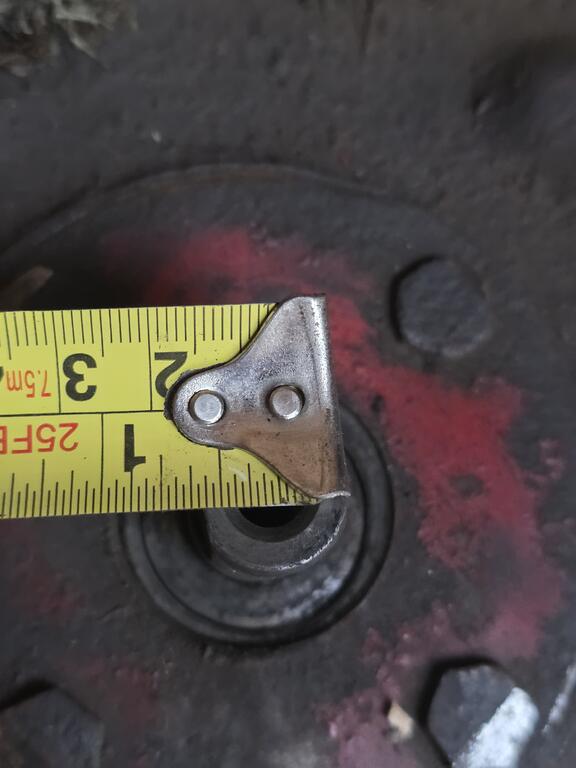

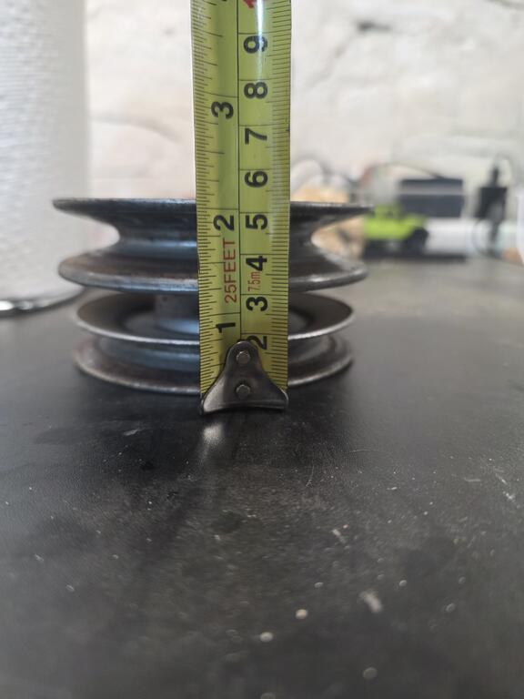

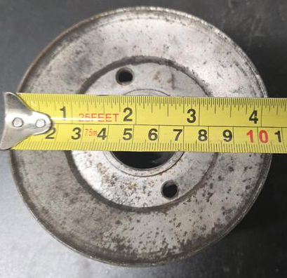

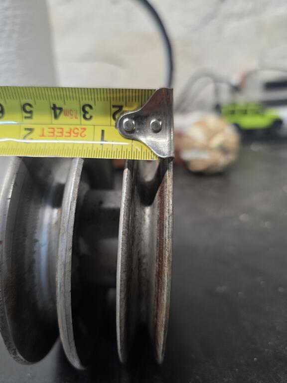

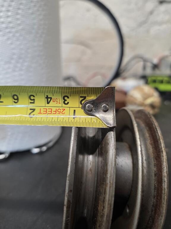

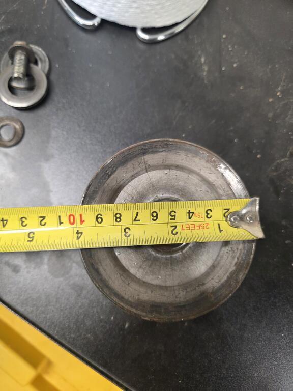

1987_WHEEHORSE312 82 #1 Posted February 19 (edited) Hey guys! So I was looking over my 36" side discharge deck and noticed that the stacked drive pulley was loose. It is a Double D style, and it seems the center bore is just a tad bigger on pulley. I have confirmed the spindle size is 5/8". I was talking to someone on Facebook and they speculated it may not even be the correct pulley on there and that someone did a garage hack just to sell it. There is no plate or stamp indicating any kind of model number on the deck even though the deck is in good shape. I was wondering if someone has a replacement I can buy or may know a part number for a website to a pulley I can buy. Here are photos of all the measurements you guys will need. The pulley with the smaller groove is the pulley that runs the belt on the deck. Edited February 19 by 1987_WHEEHORSE312 Share this post Link to post Share on other sites
gwest_ca-(File Mod) 12,092 #2 Posted February 19 Here are the possible deck models using the 5/8" x 3/4" double-D holes unless the spindle assemblies have been replaced with older assemblies than the deck. You do have 3 spindle assemblies on this side discharge deck? Never listed for the 312-8 - rear discharge only. A 2-spindle 37" side discharge deck was recommended. Mower DNA 1971 model 5-0710 - Idler tension bar mounted with two 2-bolt guides - Deck idler pulley 7434 - Mower replaced by 1971 model 5-0711 - Deck idler pulley 7434 1972 model 5-0720 - Deck idler pulley 7434 1973-1974 model 5-0721 - Deck idler pulley 7434 1975 model 5-0722 - Deck idler pulley 7434 1976 model 65-36MS01 - Deck idler pulley 7434 1977 model 75-36MS01 - Last deck to use idler tension bar mounted with two 2-bolt guides - Deck idler pulley 7434 1977 model 75-36MS02 - First deck to use bushings in center of idler tension bar - Deck idler pulley 7434 1978 model 85-36MS01 - Bushings in center of idler tension bar - Deck idler pulley 7434 1979 model 95-36MS00 - These decks use blades with 5/8" x 3/4" center hole unless the spindle has been upgraded - Deck idler pulley 7434 ----------------------------------------------------------------------------------------------------------------------------------------------------------- 1979 model 95-36MS01 - These decks use blades with a 3/4" center hole - Deck idler pulley 7434 - Deck replaced by 1980-1982 model 05-36MS01 - Last year for bearings with 3/4" ID - Deck idler pulley 7434 1983-1984 model 05-36MS02 - First year for bearings with 17mm ID unless older spindles were updated. These decks use blades with a 3/4" center hole - Deck idler pulley 7434 Share this post Link to post Share on other sites

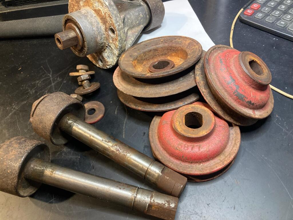

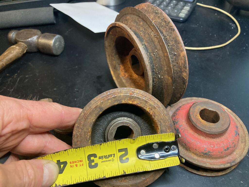

BruceK 2 #8 Posted March 30 Good morning all. My question relates to the above without providing any answers. I'm refurbishing two old 36" cutting decks which have the double D spindles as pictured in this thread above. Some of the single groove spindle cast iron pulleys (not the idler pulleys) are chipped, one pretty much beyond repair (a previous owner had mounted it upside down to stop the belt from coming off). Could someone tell me the correct part number for replacement pulley wheels please? Are they readily available (I'm in the UK) or will I be reduced to buying some cast iron pulleys (with a 15mm hole and a key slot) and hand filing them out to double D? (Not a task I relish). So far I've machined out the spindle bearing housing to 1 5/8" to accommodate standard bearings (two 3/4 x 1 5/8 x 7/16 bearings with a spacer in between) using the original spindles. Works well and is much cheaper when it comes to replacing the bearings Also, just an unrelated query. The belt covers on my decks are single piece with a hole for the stacked pulley to poke through whereas those pictured above are two separate covers with a gap in the centre. While this gap must make access to the belts easier, doesn't it allow debris under the covers and cause problems with the spindle drive belts? Thanks in advance for your help. Share this post Link to post Share on other sites
gwest_ca-(File Mod) 12,092 #9 Posted March 30 Side discharge? This list may help Mower DNA 36in SD 1971 model 5-0710 - Idler tension bar mounted with two 2-bolt guides - Deck idler pulley 7434 - Mower replaced by 1971 model 5-0711 - Deck idler pulley 7434 1972 model 5-0720 - Deck idler pulley 7434 1973-1974 model 5-0721 - Deck idler pulley 7434 1975 model 5-0722 - Deck idler pulley 7434 1976 model 65-36MS01 - Deck idler pulley 7434 1977 model 75-36MS01 - Last deck to use idler tension bar mounted with two 2-bolt guides - Deck idler pulley 7434 1977 model 75-36MS02 - First deck to use bushings in center of idler tension bar - Deck idler pulley 7434 1978 model 85-36MS01 - Bushings in center of idler tension bar - Deck idler pulley 7434 1979 model 95-36MS00 - These decks use blades with 5/8" x 3/4" center hole unless the spindle has been upgraded - Deck idler pulley 7434 Share this post Link to post Share on other sites
BruceK 2 #10 Posted March 31 23 hours ago, gwest_ca said: Side discharge? This list may help Mower DNA 36in SD 1971 model 5-0710 - Idler tension bar mounted with two 2-bolt guides - Deck idler pulley 7434 - Mower replaced by 1971 model 5-0711 - Deck idler pulley 7434 1972 model 5-0720 - Deck idler pulley 7434 1973-1974 model 5-0721 - Deck idler pulley 7434 1975 model 5-0722 - Deck idler pulley 7434 1976 model 65-36MS01 - Deck idler pulley 7434 1977 model 75-36MS01 - Last deck to use idler tension bar mounted with two 2-bolt guides - Deck idler pulley 7434 1977 model 75-36MS02 - First deck to use bushings in center of idler tension bar - Deck idler pulley 7434 1978 model 85-36MS01 - Bushings in center of idler tension bar - Deck idler pulley 7434 1979 model 95-36MS00 - These decks use blades with 5/8" x 3/4" center hole unless the spindle has been upgraded - Deck idler pulley 7434 Thanks for the reply. Those in the list all seem to be idler pulleys without the DD shaft hole. I think I've found the right number though. Pulley wheel 109967 or 106849 or 6757 Share this post Link to post Share on other sites
ineedanother 1,992 #11 Posted April 1 @BruceK, if this set is what you are looking for and worth the cost of shipping from NC, U.S. shoot me a PM. They aren't perfect but they are definitely serviceable. The casting on the single pulley shows 5877 and I think they came from an old 36" SD deck. I've never cleaned them up but the spindle shafts are serviceable as well. 1 Share this post Link to post Share on other sites
Handy Don 16,109 #12 Posted April 1 1 hour ago, ineedanother said: They aren't perfect but they are definitely serviceable Nice photos--they make the ‘double D’ really clear! Share this post Link to post Share on other sites
BruceK 2 #13 Posted April 3 On 4/1/2026 at 1:00 AM, ineedanother said: @BruceK, if this set is what you are looking for and worth the cost of shipping from NC, U.S. shoot me a PM. They aren't perfect but they are definitely serviceable. The casting on the single pulley shows 5877 and I think they came from an old 36" SD deck. I've never cleaned them up but the spindle shafts are serviceable as well. Share this post Link to post Share on other sites
BruceK 2 #14 Posted April 3 These look just the job. Thanks for the post and suggestion. I'll check the measurements (I think they're right) and send a message this weekend. Share this post Link to post Share on other sites
ineedanother 1,992 #15 Posted April 3 3 hours ago, BruceK said: These look just the job. Thanks for the post and suggestion. I'll check the measurements (I think they're right) and send a message this weekend. Sounds good. I found something here yesterday that makes me think these came from a 42" deck but that might not make a difference. I don't know for sure. Share this post Link to post Share on other sites
