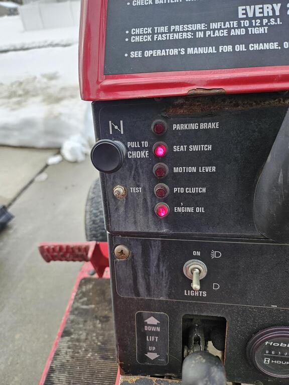

CD Long Jr 203 #1 Posted February 11 (edited) Installed new coil, condenser & seat bracket. She fired right up and ran about 20 minutes again, then died. When I attempted to restart her right away, I have no spark? I use a timer to steep my tea. Now I need one to operate the tractor. 30 minutes later, she cranks but won't start. The seat switch light is on & the engine oil light is blinking. Oil level is good. Edited February 11 by CD Long Jr Share this post Link to post Share on other sites
kpinnc 18,963 #2 Posted February 11 53 minutes ago, CD Long Jr said: The seat switch light is on & the engine oil light is blinking. Oil level is good. I can't be 100% certain, but that same oil light setup on a Kohler powered machine grounds out the ignition. This obviously will save the engine should the oil run low. But, I had one tractor that used that system and the oil sensor was going bad. It wouldn't start until it was replaced (or in my case, removed). It was a simple interlock circuit from the coil that was normally open to ground unless the oil was low. Also, the seat switch had to be closed if the PTO was engaged and the clutch pedal had to be depressed to allow it to crank. On the hydro models the left pedal may have to be depressed as well. 2 Share this post Link to post Share on other sites

gwest_ca-(File Mod) 12,488 #7 Posted February 11 Oil lamps always flash when activated (engine not running - low oil pressure or faulty switch for some or a low oil level condition on Kohler single cylinder models.) Some models the oil pressure switch controls the hour meter. Saves adding hours if the key gets left on. The seat lamp on indicates no operator in the seat with the pto engaged or a faulty seat switch or connection. This affects the ignition. Adding - I do not know what happens if the hour meter fails as the oil pressure switch provides a ground for the meter. 1 Share this post Link to post Share on other sites

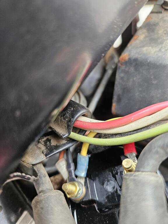

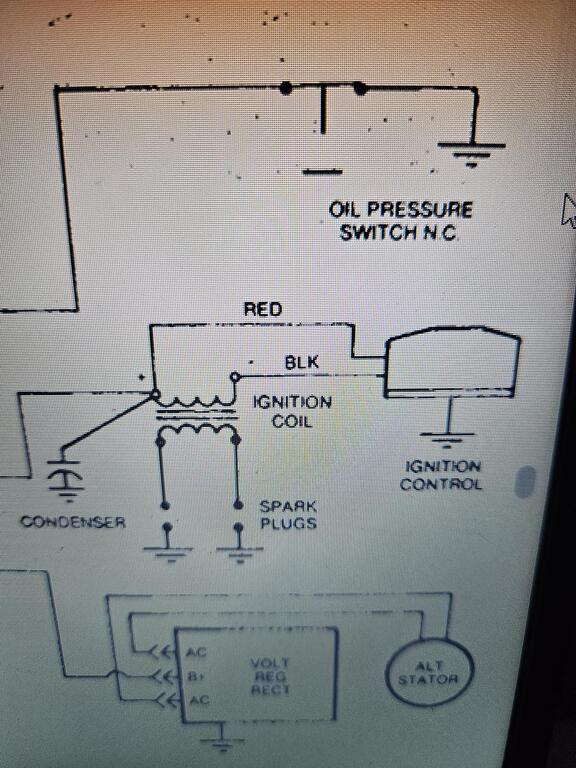

CD Long Jr 203 #9 Posted February 11 (edited) 9 minutes ago, kpinnc said: Sounds like the ignition module getting hot and opening, but I'm only guessing from a distance. Don't let it frustrate you too much. We've all been through similar things with a newly acquired machine. I'm sure you'll figure it out. If you're anything like me, you may laugh at how simple it was once you find it. I'm not much on wiring diagrams, but the Onan P216 wiring shows 2 wires to the negative(?) side of the coil. I have 3? Black wire is the condenser. Wire on the right is red. Edited February 11 by CD Long Jr Share this post Link to post Share on other sites

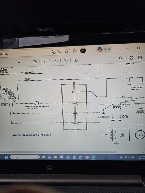

lynnmor 9,040 #13 Posted February 11 Download the Demystification Guide. Also download the Onan Service Manual. The oil pressure switch provides a ground for the oil light when there is no pressure then it provides a ground for the hour meter when there is pressure. There is no low oil pressure ignition cutoff. If you have a seat light while sitting in the seat check that switch and related wiring. Page 8-1 in the Onan Service will help you determine the ignition problem. 2 1 Share this post Link to post Share on other sites

CD Long Jr 203 #15 Posted February 11 40 minutes ago, lynnmor said: It may well be the ignition module but we talked about that before you bought a new coil. Yes we did. The coil was the lesser of two evils. I'm still trying to find out what the yellow wire on the coil goes to. The ignition coil on a Wheel Horse 416H (typically equipped with an Onan engine) uses two primary low-voltage wires, one connected to the positive (+) terminal and one to the negative (-) terminal, along with high-tension spark plug cables. Positive (+) Terminal: Receives 12-volt power from the ignition switch. Negative (-) Terminal: Connects to the breaker points or electronic ignition module. High-Tension Cables: The coil tower connects to the spark plugs. Some configurations may use a condenser wired to the negative terminal. Share this post Link to post Share on other sites
CD Long Jr 203 #16 Posted February 11 (edited) 20 minutes ago, CD Long Jr said: Yes we did. The coil was the lesser of two evils. I'm still trying to find out what the yellow wire on the coil goes to. Found it, yellow wire goes to the seat relay. The ignition coil on a Wheel Horse 416H (typically equipped with an Onan engine) uses two primary low-voltage wires, one connected to the positive (+) terminal and one to the negative (-) terminal, along with high-tension spark plug cables. Positive (+) Terminal: Receives 12-volt power from the ignition switch. Negative (-) Terminal: Connects to the breaker points or electronic ignition module. High-Tension Cables: The coil tower connects to the spark plugs. Some configurations may use a condenser wired to the negative terminal. Edited February 11 by CD Long Jr 1 Share this post Link to post Share on other sites

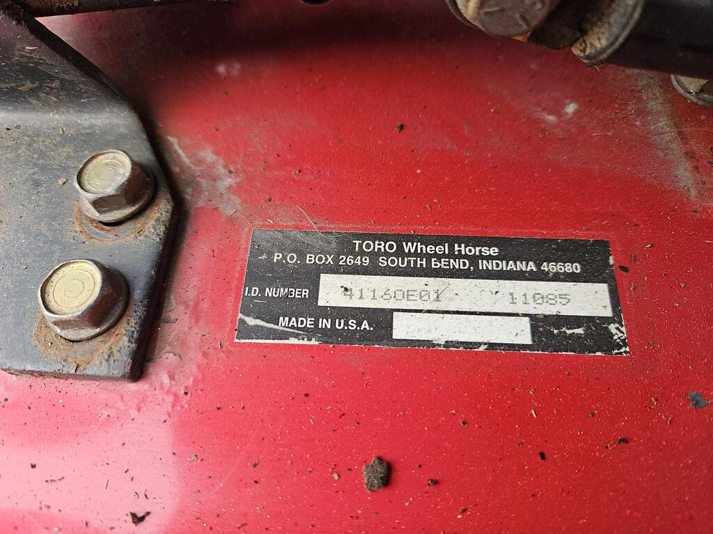

gwest_ca-(File Mod) 12,488 #17 Posted February 11 Do you know the tractor model and serial number or the model year? Want to look at the correct wiring diagram. 2 Share this post Link to post Share on other sites
rmaynard 17,582 #18 Posted February 11 (edited) My guess is that it's NOT the ignition module. In my limited experience with Onan ignition modules, it either works or doesn't. I've never seen one that is intermittent. As Garry said, please provide model number, year, and serial number if possible. Edited February 11 by rmaynard 1 Share this post Link to post Share on other sites
WHX?? 58,125 #19 Posted February 12 Yes get us the correct model & SN. Garry has some really nice color coded wiring diagrams. 1 Share this post Link to post Share on other sites
CD Long Jr 203 #20 Posted February 12 (edited) 11 hours ago, gwest_ca said: Do you know the tractor model and serial number or the model year? Want to look at the correct wiring diagram. Yes we did. The coil was the lesser of two evils. I'm still trying to find out what the yellow wire on the coil goes to. Found it, yellow wire goes to the seat relay. The ignition coil on a Wheel Horse 416H (typically equipped with an Onan engine) 1982. Edited February 12 by CD Long Jr Share this post Link to post Share on other sites
gwest_ca-(File Mod) 12,488 #21 Posted February 12 Download this file. In it is simple wiring diagrams for each major circuit including the ignition. Makes it much easier to understand. The yellow wire is powered by two different sources. With the pto on the yellow wire is powered by the seat switch. With the pto off one half of the pto switch powers the yellow wire. The wire colors on the engine side of the 9-pin connector may not be correct. They were supplied by Onan. 1 Share this post Link to post Share on other sites
CD Long Jr 203 #22 Posted February 12 (edited) Thank you. I found this file yesterday. That's how I found out the yellow wire was to the seat switch. Edited February 12 by CD Long Jr Share this post Link to post Share on other sites
