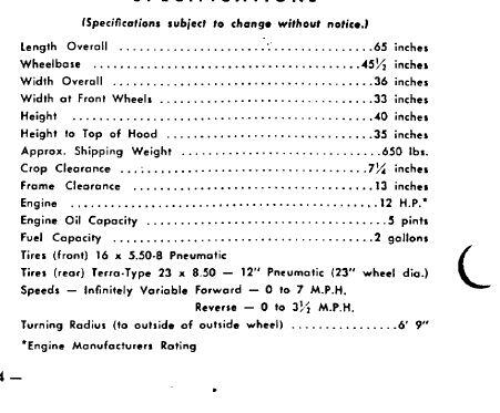

My electro 12 moves fast in forward but not so fast in reverse.
Are there adjustments ?
  • Like 1
pfrederi
WH wanted you to go slower in reverse.  Assuming your neutral adjustment is correct (she does not run away when you have the motion control in the center.) and your plastic slider is in good shape  slower reverse is normal.
One issue I have is i get the neutral adjustment set in October...but when it gets down to the single digits she will creep...
