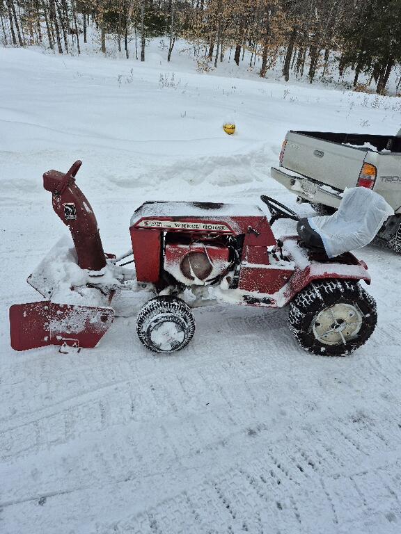

midpack 1,090 #1 Posted 6 hours ago After the walloping we got Sunday into Monday I used Mongo to clean up. Mostly it did great but it started running rich. I think the snow was so fluffy it was getting in the air cleaner. Wanted to use it the next day to clean up the plow berms at the end of the driveway and the bendix wouldn't engage. Took the cover off and there was a nice chunk of ice in the tin. Cleaned that out and still no engagement. I ended up using a propane torch on the end of the starter for maybe 10 to 15 seconds. That was all it took. 6 Share this post Link to post Share on other sites
