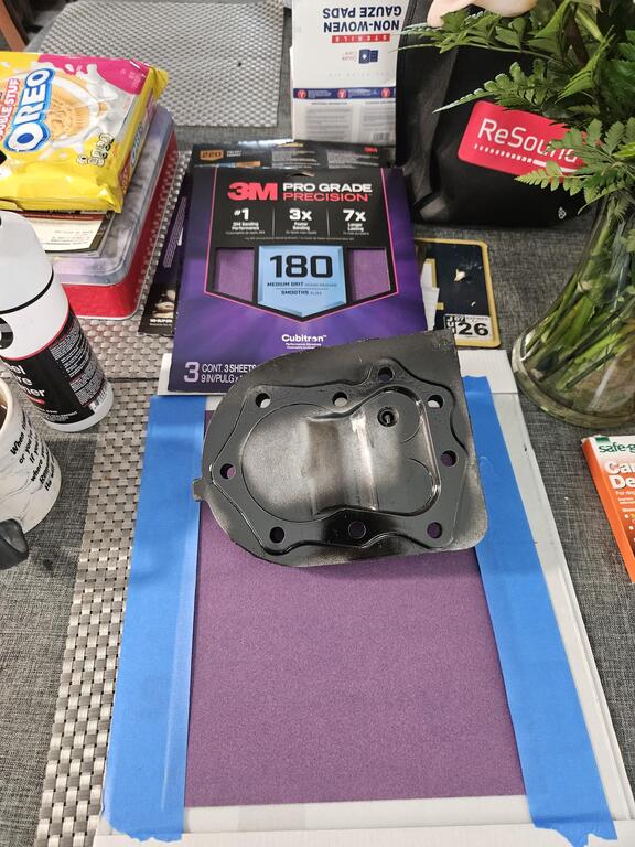

CD Long Jr 203 #1 Posted January 24 Got a pane of glass, 180 & 220 sandpaper @ HD, 24 bucks. I laid a sheet on the glass and used painters' tape to hold it. Sprayed water and sanded. Took 3 sheets of 180 & 3 sheets of 220. Too cold to do anything else. 7 9 1 Share this post Link to post Share on other sites

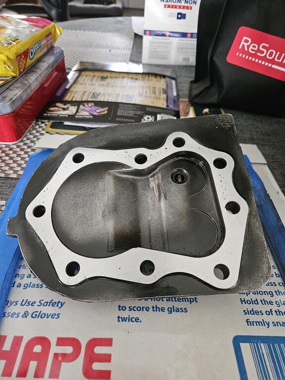

sqrlgtr 2,247 #2 Posted January 24 @CD Long Jr looks like it cleaned up pretty good. 2 Share this post Link to post Share on other sites

peter lena 9,782 #6 Posted January 30 @CD Long Jr nice job on that , personally , get some RISLONE ZDDP SUPPLEMANT , I use 4 oz , bottle specs , for 2qts of oil , that will make quick work out of those varnished piston rings , engine heat , will really help clean up whats there , would also use a 10-30 oil , for easier / quicker turnover start up, that oil transition , will give you a solid baseline , for easy running and cleanup , none of my engines , smoke in any way , been using this set up for years , good going , pete Share this post Link to post Share on other sites
