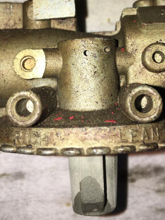

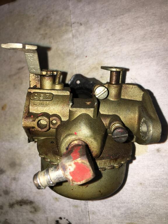

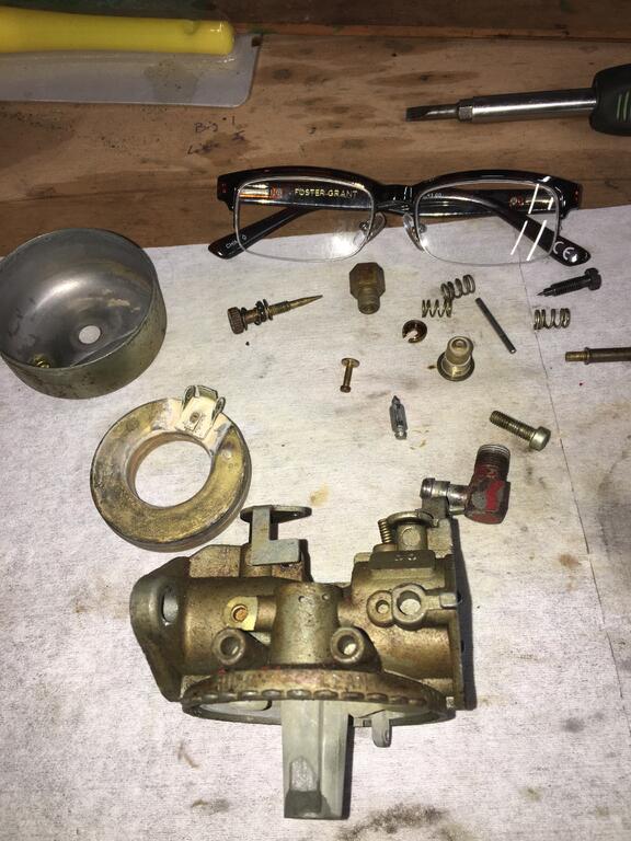

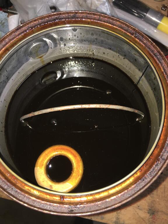

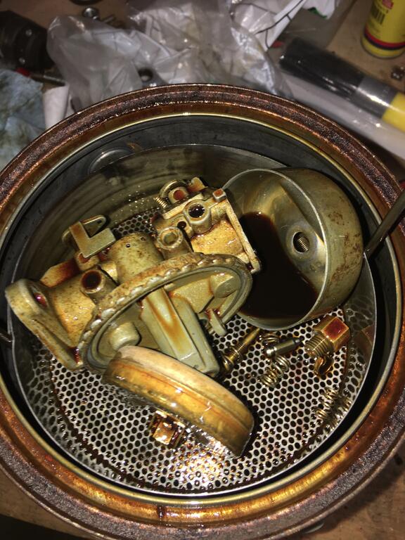

sqrlgtr 3,583 #29 Posted January 23 (edited) 2 hours ago, WHX?? said: Keep us posted on what your DMM says once you get that far. Will do I did get a chance to take carb off and get it in the Berrymans cleaner. Check out the one pic that has nothes and rich and lean wrote on carb body above bowl ???? Also left one of the most important tool from my toolbox in pic so all u old farts dont feel so bad. Edited January 23 by sqrlgtr 5 Share this post Link to post Share on other sites
sqrlgtr 3,583 #30 Posted January 24 I noticed on this parts diagram it shows a gasket part #1(looks like a fiber washer?) on outside of bowl under main jet needle fitting and one inside of bowl between bowl and carb top. The one I have did not have the one inside the bowl does anyone know fer sure if it supposed to or not? Share this post Link to post Share on other sites

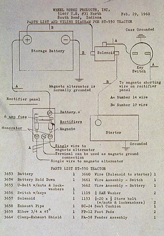

sqrlgtr 3,583 #31 Posted March 3 Ok Wheel Horse nerds I mean Guru's. Check my math on these diodes I assume I need these oriented to flow toward battery and not to mag alternator, correct? I got carb back on and runs great. Thought I would go ahhead and put a battery on her and see how that worked out. Keep in mind I have never seen this thing turn over with a battery before but it rung its tail and fired right up but smoked one/both of the diodes came home and ate a samwhich and it just dawned on me I might have put the diodes in backwards . Share this post Link to post Share on other sites
wallfish 20,376 #32 Posted March 3 2 hours ago, sqrlgtr said: I need these oriented to flow toward battery Correct 1 Share this post Link to post Share on other sites
Handy Don 17,179 #33 Posted March 4 (edited) 5 hours ago, sqrlgtr said: t just dawned on me I might have put the diodes in backwards Ok. I’m assuming you were able to start the engine using the battery. Once the engine is turning, the two wires from the stator start having AC voltage/current. They go to the diode bridge/rectifier which converts the AC to DC. The output flows to the battery “+” to commence re-charging the battery. The diodes in the bridge are supposed to be more than strong enough to do two things without damage: 1) block current from flowing in the wrong direction (i.e. allowing the battery to discharge instead of charge), and 2) allow the charging current through. If BOTH diodes were “reversed", they would drain the battery as the engine turned instead of charging it. If only ONE diode is reversed, however, charging current from the stator is blocked. In no normal situation will starting or running the engine cause a diode to “burn out" Edited March 4 by Handy Don Share this post Link to post Share on other sites
sqrlgtr 3,583 #34 Posted March 4 6 minutes ago, Handy Don said: Ok. I’m assuming you were able to start the engine using the battery. yes 6 minutes ago, Handy Don said: ONE diode must be wired to flow toward the battery and one wired to flow away from the battery. I don't think this is the way it is wired up. I am going by the schematic I have posted in above post and believe that's the way it is wired up at the moment but had to quit before I really got to check everything good before I left. I was under the assumption that both diodes charged battery, but I am by no means an authority. The battery cable did spark when I unhooked indicating going to ground so IDK what I've got yet . Share this post Link to post Share on other sites
Handy Don 17,179 #35 Posted March 4 (edited) Test the diodes with an ohm setting on the multi-meter as others suggested--often labeled with the Ω symbol. If the diode: 1. has the same reading in both directions (i.e. switching ends either the test prob), it has failed. 2. has no resistance in one direction and lots in the other, it is probably good. For a tested good diode, put the end which had the black (negative or common) test probe during the test having “no resistance” reading toward the battery Edited March 4 by Handy Don 2 Share this post Link to post Share on other sites
sqrlgtr 3,583 #36 Posted March 4 30 minutes ago, Handy Don said: For a tested good diode, put the end which had the black (negative or common) test probe during the test having “no resistance” reading toward the battery I thought that's what I had done but may have put them in bass ackwards. I should have checked them again before installing them but I didn't . Share this post Link to post Share on other sites
sqrlgtr 3,583 #37 Posted March 5 Sure enough had them in backwards. Thats what I get fur mechanician without my readers on . Spent a couple hours trying to find the extra diodes a had purchased and finally gave up and moved over to the 520H I recently bought. Got ready to leave and one last look at the 551 and found the extra diodes under the seat . Had to get home before warden got there so maybe try again tomorrow. 1 Share this post Link to post Share on other sites
wallfish 20,376 #38 Posted March 6 Both diodes flow towards the battery. Glad you got it working It's mentioned in the WH paperwork to remove 1 diode if the engine is constantly running for long periods of time because it will over charge the battery. The stator AC is rectified to DC and it is constant and not regulated to stop when the battery is full. It just keeps on charging all the time. ( 3 amps I believe ) I'm not sure reversing them would burn them out as the voltage on that engine isn't very high. Did you try just using the first diodes installed correctly? They could've seemed burned out because voltage wasn't passing to the battery. It would've been "check valved" by the diodes installed in reverse. 2 Share this post Link to post Share on other sites
sqrlgtr 3,583 #39 Posted March 6 32 minutes ago, wallfish said: Glad you got it working Hadn't had a chance to try it yet fish. Spent couple hours trying to find my extra diodes , but sure enough ruined the ones in it. One want flow either way and the other flows both ways . I'm going to try and check it out tomorrow though. 2 Share this post Link to post Share on other sites
Handy Don 17,179 #40 Posted March 6 14 hours ago, wallfish said: It would've been "check valved" by the diodes installed in reverse. Worse than “checked”, the stator would drain power from the battery while the engine was running! Yes, likely a 3 amp stator and also likely designed to max at about 14-14.5 VAC when running at 3600 rpm to help lower the risk of overcharging. Another reason to keep the revs up when in use--at low RPM, the stator doesn’t generate enough voltage to charge the battery! 3 Share this post Link to post Share on other sites
