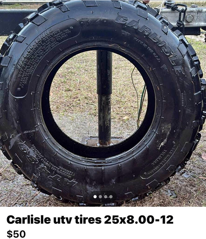

FLtractor 109 #1 Posted 9 hours ago (edited) Saw these UTV tires, will they fit these rims? They’re asking $50 for both tires. Would put them on my 856 Edited 9 hours ago by FLtractor Share this post Link to post Share on other sites
sqrlgtr 1,794 #2 Posted 9 hours ago yes those will fit year wheels, but they are 25"s tall, so will be quite a bit taller and might rub fender/seat pan? More than likely you have 7.5 inch wide rims with 8.50 tires on them. Factory Wheel Horse 8.5" rims are kind of hard to come by, especial around here. Share this post Link to post Share on other sites
FLtractor 109 #3 Posted 9 hours ago (edited) 16 minutes ago, sqrlgtr said: yes those will fit year wheels, but they are 25"s tall, so will be quite a bit taller and might rub fender/seat pan? More than likely you have 7.5 inch wide rims with 8.50 tires on them. Factory Wheel Horse 8.5" rims are kind of hard to come by, especial around here. So would it be best to get a different size tire that’s smaller such as 24 23 ect? Also being UTV tires, how would they affect my 856 towing with their load rating compared to tractor tires? Edited 8 hours ago by FLtractor Share this post Link to post Share on other sites
gwest_ca-(File Mod) 11,920 #4 Posted 8 hours ago They may be sized at 25" tall but are they actually that tall. Many are not. And they do not get taller when inflated. Being in Florida you will not need clearance for chains like many of us. Share this post Link to post Share on other sites

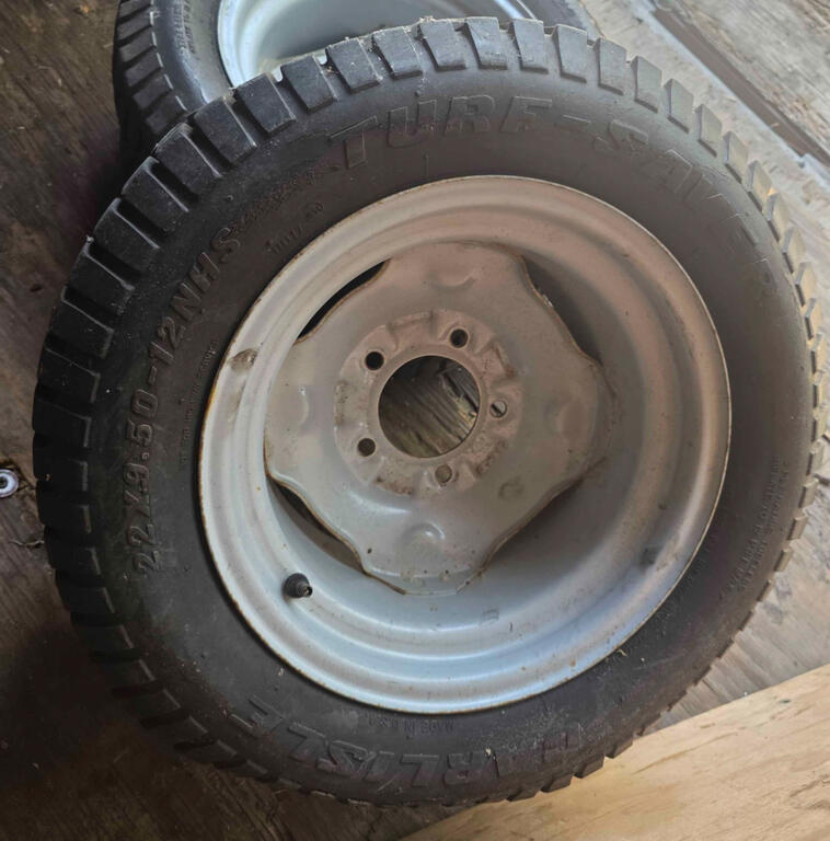

pfrederi 19,495 #5 Posted 7 hours ago The side wall says 22 x 9,50 x 12. The signage says 25 inches tall something is wrong.. 22 x 950 will fit vertically but may be a bit bulgy on 7.5" rims. Share this post Link to post Share on other sites
FLtractor 109 #6 Posted 7 hours ago (edited) 44 minutes ago, pfrederi said: The side wall says 22 x 9,50 x 12. The signage says 25 inches tall something is wrong.. 22 x 950 will fit vertically but may be a bit bulgy on 7.5" rims. Apologies didn’t explain pictures better, the tires on rims are to be throw. Away .. only bought them for the rims. Been looking for tires to put on those rear rims since mine need replacing both rims and tires due to calcium chloride. Came across these 25 inches today near me and wondered if they would work since good deal Edited 7 hours ago by FLtractor Share this post Link to post Share on other sites
rjg854 12,727 #7 Posted 6 hours ago Those don't look like rims, so the setback may cause an issue. The air nozzle is on the outside of the rim. Share this post Link to post Share on other sites
FLtractor 109 #8 Posted 6 hours ago 22 minutes ago, rjg854 said: Those don't look like rims, so the setback may cause an issue. The air nozzle is on the outside of the rim. Oh I didn’t know that would be an issue.. just thought the rim size and correct # lug holes and offset mattered to fit Wheelhorse Share this post Link to post Share on other sites

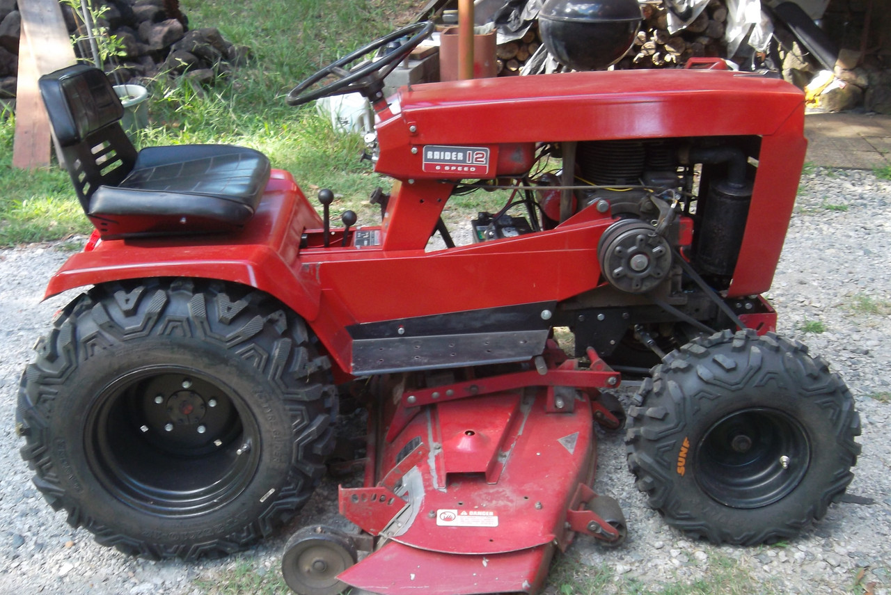

kpinnc 16,626 #9 Posted 5 hours ago The rims are a little less offset but that isn't your issue as much as the 25 inch tires. The pic below is a 23x8.50-12 on the same fender setup as your tractor. If the tires are anywhere close to actually 25 inches tall, that's a full inch all the way around. It will be very close to rubbing the fender, and that is if your pivot bushings are good. Of course you can modify the pivot and get around such things but if that isn't your plan then those tires may be too tall, and even more so on standard wheels. 1 Share this post Link to post Share on other sites
FLtractor 109 #10 Posted 4 hours ago 37 minutes ago, kpinnc said: The rims are a little less offset but that isn't your issue as much as the 25 inch tires. The pic below is a 23x8.50-12 on the same fender setup as your tractor. If the tires are anywhere close to actually 25 inches tall, that's a full inch all the way around. It will be very close to rubbing the fender, and that is if your pivot bushings are good. Of course you can modify the pivot and get around such things but if that isn't your plan then those tires may be too tall, and even more so on standard wheels. Oh ok thank you for the picture reference… will look for tires that won’t possible hit fender for less issue. Does the fact those rims I bought have an outside Air nozzle mean they won’t work with Wheelhorse? Share this post Link to post Share on other sites
Easton Rich 800 #11 Posted 4 hours ago It will work, but it's not stock. Share this post Link to post Share on other sites
FLtractor 109 #12 Posted 3 hours ago 49 minutes ago, Easton Rich said: It will work, but it's not stock. Thank you, good to know those rims I bought will work 1 Share this post Link to post Share on other sites
