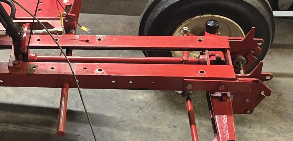

kpinnc 18,963 #26 Posted February 13 (edited) 1 hour ago, WHX?? said: A vital piece if you want to put a deck on. Another option is to get a new Tach-a-matic belly hitch and run newer decks. Factory holes are already in the frame. Fabbing a front hitch for the mule drive is easy. Also has holes in the frame. All you need are a couple pieces of flat bar and a front hitch from a newer (1974 and up) machine. I had to cut the one on my Bronco in the pic below to get around the hood stops but you won't have to on a 1257. Edited February 13 by kpinnc 1 1 Share this post Link to post Share on other sites

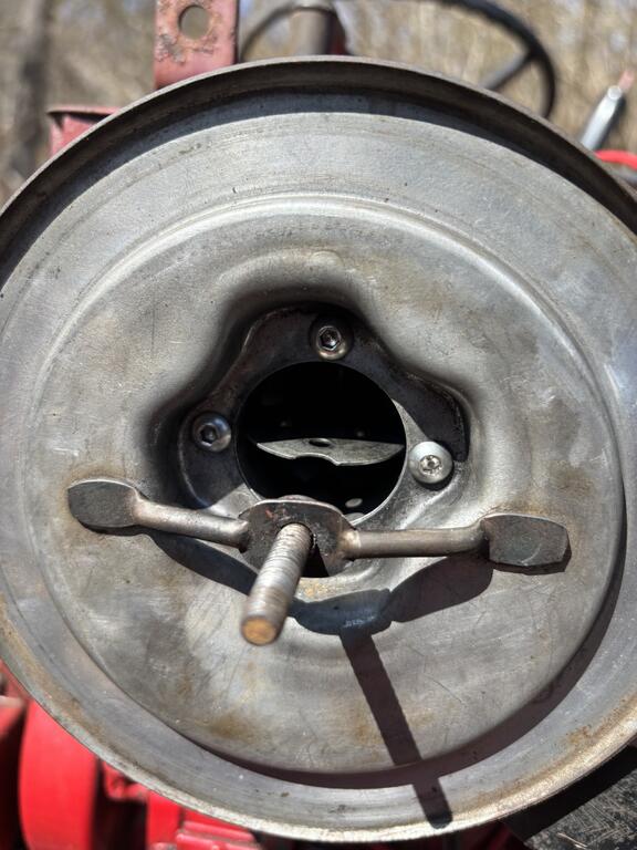

TonyToro Jr. 2,539 #39 Posted April 7 So this past weekend finally got around to working on this tractor again. Installed new throttle cable, and the carb kit. Also replaced the screws that hood on the air filter assembly. And we are now running beautifully! But wait. This tractor still isn’t finished yet. I have the starter gen light I got from @WHX?? and some new shoes to put on it! IMG_1904.mov 6 1 Share this post Link to post Share on other sites

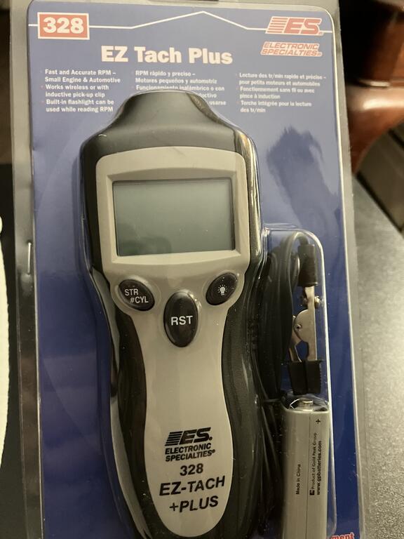

Retired Wrencher 6,989 #41 Posted April 8 (edited) Tony Make sure your ideal is around 1200 rpms. I sound a little low to me. If you can get one of these. It is a RPM meter. Very handy. Also if you ever want to sell it i hope you send me a message. Cash in hand. Edited April 8 by Retired Wrencher 1 Share this post Link to post Share on other sites
