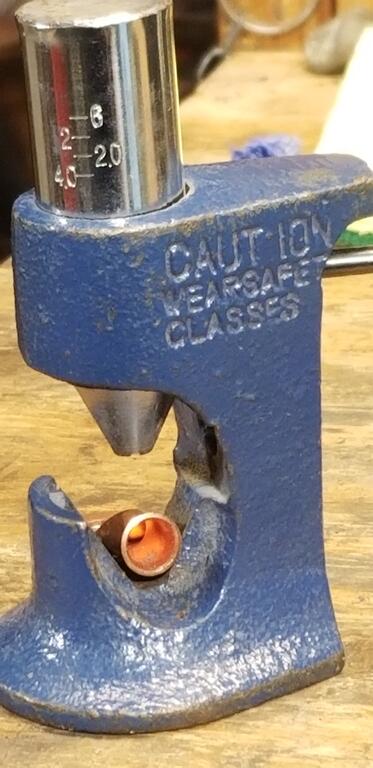

gt14rider 1,278 #29 Posted January 15 I use this style, works good. 3 Share this post Link to post Share on other sites
