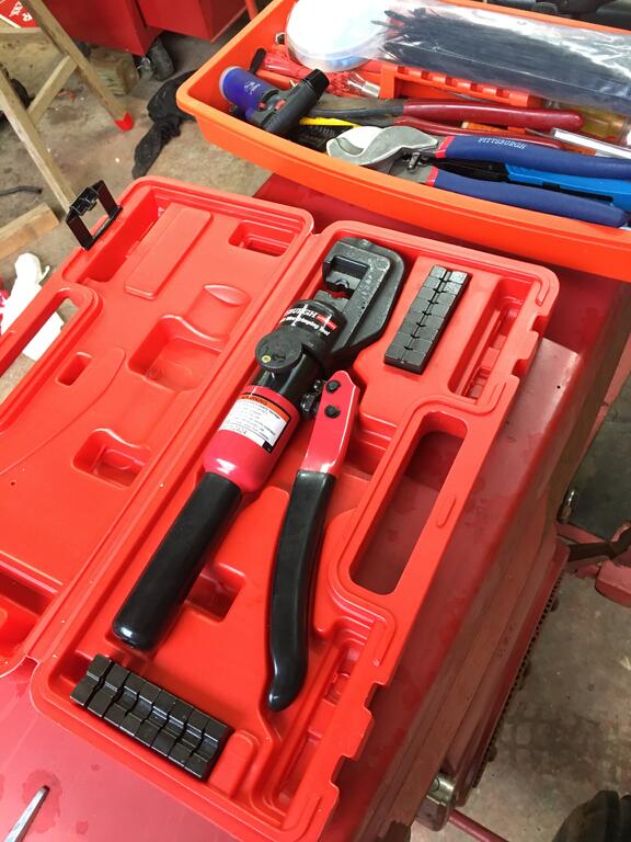

ri702bill 11,277 #5 Posted January 9 My Son & I have had good success using the HFT hand held Hydraulic Lug Crimper. Just remember to put the shrink tubing on first!! 5 1 Share this post Link to post Share on other sites

sqrlgtr 2,182 #13 Posted January 9 Pulled the trigger on this one from HFT. Was surprised how many dies came with it. Crimps 14 to 0 gauge Will be proud to be able to make my own cables. I hate haveing extra long cabels and to big ol lug holes when not needed and has to be easier on electrical systems. 3 5 Share this post Link to post Share on other sites

ineedanother 1,882 #19 Posted January 9 2 hours ago, sqrlgtr said: Pulled the trigger on this one from HFT. Was surprised how many dies came with it. Crimps 14 to 0 gauge Will be proud to be able to make my own cables. I hate haveing extra long cabels and to big ol lug holes when not needed and has to be easier on electrical systems. I did the same, and with the "Pittsburgh" cable cutters as well. My next step will be to fashion some sort of clamp for my vise or something so it can be stationary. It's a bit unwieldy when just hand-held managing the cable and lug. 2 Share this post Link to post Share on other sites
sqrlgtr 2,182 #20 Posted January 9 2 minutes ago, ineedanother said: My next step will be to fashion some sort of clamp for my vise or something so it can be stationary. It's a bit unwieldy when just hand-held managing the cable and lug. Hadn't thought about that, I havent had a chance to try it out yet. I figured it couldn't be any more cumbersome than the plier type. Maybe mount it to a block of wood first then put it in vise , probably use a set of soft jaws in vise and hold it by the lower handle, just thinking out loud here? I will find out in a day or two . 2 Share this post Link to post Share on other sites
