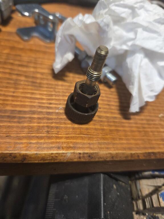

markseven 93 #1 Posted January 9 It leaks bad .? And I want to fix . Any suggestions 🤔 👀 😊 Share this post Link to post Share on other sites
markseven 93 #2 Posted January 9 I know im replying to my topic. Its like a leather material Acting as a o ring? Share this post Link to post Share on other sites
lynnmor 9,040 #3 Posted January 9 Cut off a bit of your leather shoe string on your hunting boots. They do make packing material, hopefully it is still available in the plumbing section of your favorite hardware store. 2 Share this post Link to post Share on other sites
8ntruck 9,296 #4 Posted January 9 I had a leaking shut off valve on my 14-8 no name. I picked out the old O ring/paking, then took the valve stem to the hardware and found an O ring that would fit on the valve stem. Put the nut on the stem and rolled the O ring over the threads then put the valve back together. That was about 5 years ago. Still holding. 3 Share this post Link to post Share on other sites
ri702bill 13,065 #5 Posted January 9 If you do that, use a Viton O-Ring, not Buna-N. 2 Share this post Link to post Share on other sites
sqrlgtr 3,931 #6 Posted January 9 8 hours ago, markseven said: It leaks bad .? And I want to fix . Any suggestions 🤔 👀 😊 I may have missed it but what mochine does that go with? I'm almost positive you can still get them shutoffs new if ya dont have any luck fixin it. BTW I always try and use one of our vendors here when I can if you decide to buy new. 2 Share this post Link to post Share on other sites

Handy Don 17,474 #8 Posted January 9 (edited) The viton o-ring can work ok. An alternative I’ve used is (Ace) hardware: https://www.acehardware.com/departments/plumbing/faucet-and-faucet-repair/faucet-and-valve-packing/4200366 I had some left over from fixing outdoor water spigots. Wrap around the stem between the compression nut and the shaft threads to make a donut about 1/8” in diameter. Edited January 9 by Handy Don 1 Share this post Link to post Share on other sites
WHX?? 58,125 #9 Posted January 9 I have wrestled with these leaking many times and not had much luck in getting them to quit. Since replacements are readily available I just replace them. Especially on tractors that they are hard to get at. replacements 3 1 Share this post Link to post Share on other sites
Handy Don 17,474 #11 Posted January 9 2 hours ago, WHX?? said: I have wrestled with these leaking many times and not had much luck in getting them to quit. Since replacements are readily available I just replace them. Especially on tractors that they are hard to get at. replacements Completely agree on the newer style. I wanted to refurbish one with the glass sediment bowl on the 854. 3 Share this post Link to post Share on other sites
WHX?? 58,125 #12 Posted January 9 (edited) Sentimental leak bowls don't get messed with either. Squonkies favorite ... Just replace. Guy's gotta stay orginal on a resto Mike... The original 1/8 threaded style petcocks with the round knob are still around you look. Stens or Rotary I think. Edited January 9 by WHX?? 2 Share this post Link to post Share on other sites
