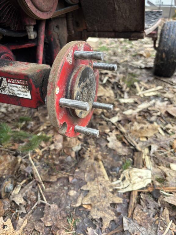

JerryLook 84 #37 Posted April 3 It’s taken me a while to get this done, but I finally got the studs installed. I got 2” long bolts from McMaster Carr. I got lugnuts from the auto parts store in town. I had some 5/16” spacers and tried them out. The chains still lightly rubs on the parking brake mechanism on the left side of the tractor. So I’ll get some wider spacers. I have to stud length to go up to an inch of spacers per side. Share this post Link to post Share on other sites
