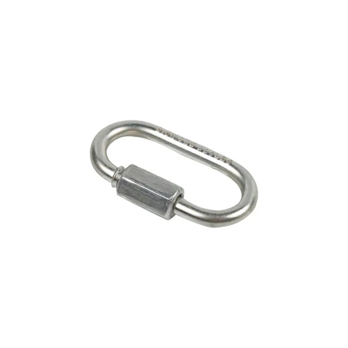

Ed Kennell 45,524 #4 Posted January 7 There is not much clearance on my 520. I always cut the inside side chain to the exact length and connect the ends with one of these connectors. Then pull the chains to the outside with the cam lock connector and install spring tensioners. This minimizes the thickness of the inside chain. 3 3 Share this post Link to post Share on other sites

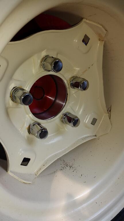

kpinnc 17,575 #5 Posted January 7 4 hours ago, JerryLook said: Has anyone had to do this? I know they sell 5x4.5 wheel spacers online for pretty cheap. I won't say I had to, but I've used spacers on several machines. They work well but you do need to be careful if using a mower deck because of the deck gage wheels clearance. You'll have to ream your bolt holes on your wheels to 1/2. They type of spacer also needs to be open in the center to fit a WH hub. You'll also need to use 7/16x20 bolts at about 1 and 1/4 length or raised head studs to hold the spacers on. I've never had good luck using WH wheel bolts with spacers. The heads are usually too large to get a standard socket on them inside the spacer. 4 1 Share this post Link to post Share on other sites

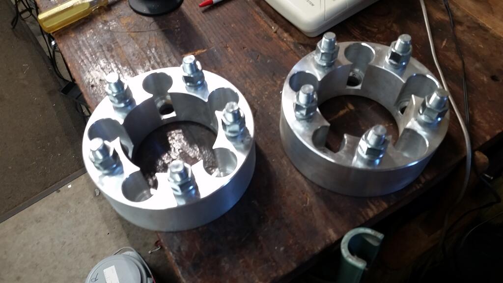

Achto 31,416 #6 Posted January 7 A set of these & you should not need to ream out the holes in your rim. Just get longer wheel studs. https://www.jegs.com/i/JEGS/555/65058/10002/-1 4 Share this post Link to post Share on other sites

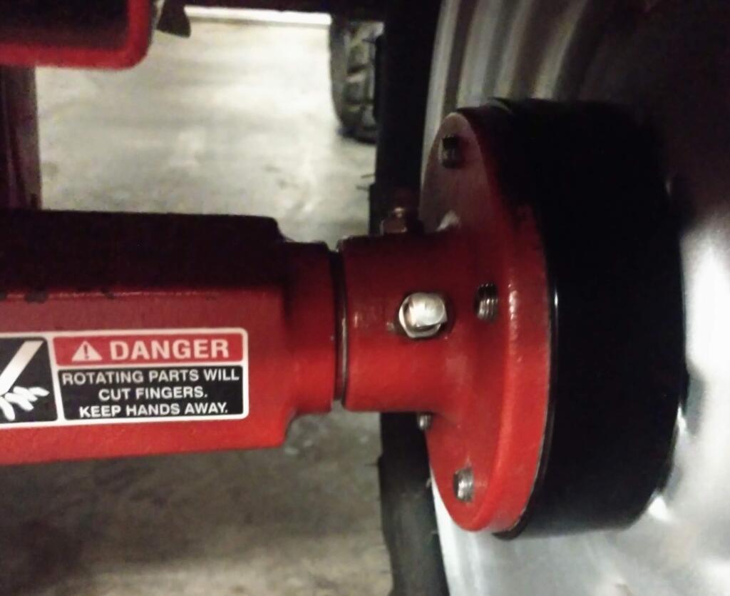

lynnmor 8,700 #9 Posted January 7 Is the end of your axle flush with the hub? Share this post Link to post Share on other sites
photoguy 163 #10 Posted January 7 I just drill the spot welds on wheel center move it in and plug weld easy if you have a Mig. Share this post Link to post Share on other sites
kpinnc 17,575 #11 Posted January 7 6 hours ago, Achto said: A set of these & you should not need to ream out the holes in your rim. Just get longer wheel studs. At 1/2 inch thick, those are not a bad option at all. 3 Share this post Link to post Share on other sites
sqrlgtr 2,395 #12 Posted January 7 (edited) 8 hours ago, Achto said: A set of these & you should not need to ream out the holes in your rim. Just get longer wheel studs. https://www.jegs.com/i/JEGS/555/65058/10002/-1 I use the same type but mine came from Miller tire and was a lot more $$$. Wish I had seen these earlier The ones I have are just for the small ford/Wheel Horse bolt pattern 5x4.5 Edited January 7 by sqrlgtr 2 Share this post Link to post Share on other sites
My_horse 89 #13 Posted January 7 When I bought my chains back in 2002 for the 314-8, they came with a 3/8” wheel spacer. I wasn’t comfortable with the amount of threads holding in the hub with the spacers on. I loosened the setscrews in the axle hub and slid it out 3/8”. 2 Share this post Link to post Share on other sites

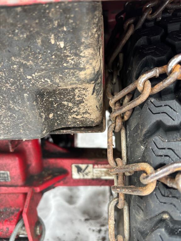

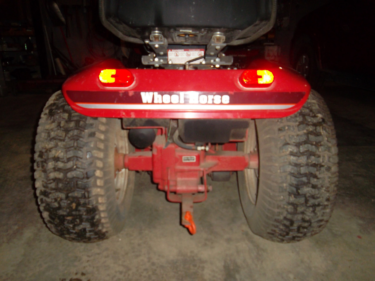

JerryLook 84 #14 Posted January 8 I was looking at spacers similar to the ones from Jegs. I think that’s the route I’m going to take. Here’s a pic to show how close the chains are. I think a 1/2” will give it enough clearance to be good. I appreciate all the input 2 Share this post Link to post Share on other sites

Lee1977 7,629 #17 Posted January 8 (edited) 17 hours ago, My_horse said: When I bought my chains back in 2002 for the 314-8, they came with a 3/8” wheel spacer. I wasn’t comfortable with the amount of threads holding in the hub with the spacers on. I loosened the setscrews in the axle hub and slid it out 3/8”. If your axle has a Woodruff key moving the hub out is not a good idea. The hub and axle was designed for the set screw to center on the woodruff key. If moved it tilted the key and will allow the hub to move on out in the direction the hub was moved. It isn't much but the set screw is only holding on one side. Edited January 8 by Lee1977 2 2 Share this post Link to post Share on other sites
JerryLook 84 #18 Posted January 8 That was probably a poor pic to post. I have already removed the chains and just threw one over the tire to show the clearance. The distance between the tire and gas shield is about one chain link width. Share this post Link to post Share on other sites
JerryLook 84 #19 Posted January 8 The tires that came on the tractor were more rounded on the tread section. These tires are the same size as stock, but have more squared off shoulders. Share this post Link to post Share on other sites
JerryLook 84 #20 Posted January 8 I just measured it and I have 5/8” clearance between the tire and shield. With no chains installed. 1 Share this post Link to post Share on other sites

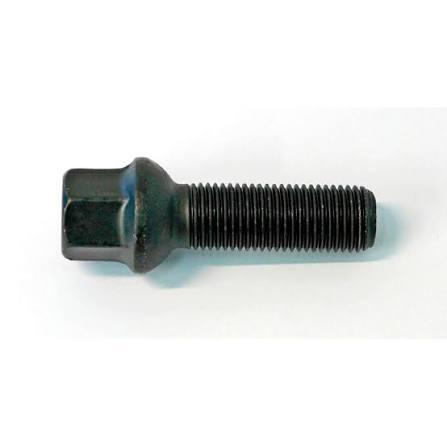

JerryLook 84 #24 Posted February 3 I’m thinking about getting hex head bolts and running them through the back of the hub, then using regular lug nuts to hold the wheels on. Do you think I can get away with 1 1/2” length bolts? I want the option to use up to an inch of spacers on each side. I’m having issues finding 7/16-20 bolts that are threaded to the head (no shoulder) in lengths longer than 1 1/2”. Share this post Link to post Share on other sites
Ed Kennell 45,524 #25 Posted February 3 42 minutes ago, JerryLook said: I’m thinking about getting hex head bolts and running them through the back of the hub, then using regular lug nuts to hold the wheels on. Do you think I can get away with 1 1/2” length bolts? I want the option to use up to an inch of spacers on each side. I’m having issues finding 7/16-20 bolts that are threaded to the head (no shoulder) in lengths longer than 1 1/2”. Buy a 3' length of 7/16-20 threaded rod and cut studs any length you need. Lock them to the back of the hub with a 7/16-20 nut. 1 1 Share this post Link to post Share on other sites
