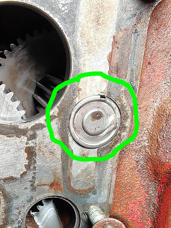

953 nut 63,519 #2 Posted Tuesday at 12:59 PM Here is a picture of the cam plate (upside down), the direction control linkage has a ball shaped arm that slides up and down in the slot of the cam plate, that in turn moves the Sundstrand's direction and speed output. Share this post Link to post Share on other sites
tmix61 92 #3 Posted Tuesday at 01:21 PM I don't see this plate I see where the shaft goes in and the fluid comes through the strainer Share this post Link to post Share on other sites
pfrederi 19,436 #4 Posted Tuesday at 01:44 PM The cam block and pin discussed in the manual are not involved with a divorced system as on your D200. Your D200 should be a piston to piston unit not a hydro gear. Share this post Link to post Share on other sites

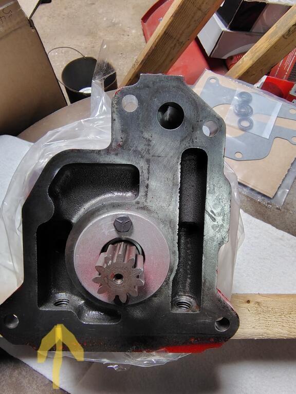

pfrederi 19,436 #10 Posted Tuesday at 02:19 PM (edited) 3 minutes ago, tmix61 said: Do you mean when you put the manifold tubing back on? Yes there was a washer under one of the front bolts that hold the manifold to the hydro motor. It is a sealing washer. Not sure it was designed to be reused... Edited Tuesday at 02:21 PM by pfrederi Share this post Link to post Share on other sites
tmix61 92 #11 Posted Tuesday at 02:25 PM Not sure which one you're talking about was it an o-ring? Are we talking about the upper middle small hole above the big one? Share this post Link to post Share on other sites
pfrederi 19,436 #12 Posted Tuesday at 03:03 PM No it was a flat crush type washer. It goes through the manifold into the top of the hydro motor (yellow arrow.) Share this post Link to post Share on other sites

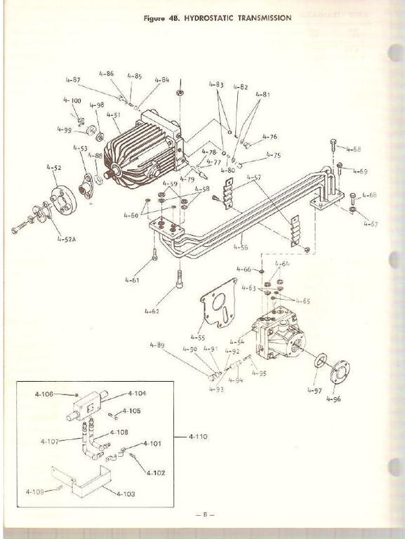

tmix61 92 #15 Posted Tuesday at 03:19 PM I don't see anything on the schematic Share this post Link to post Share on other sites
pfrederi 19,436 #16 Posted Tuesday at 04:23 PM You are looking at the wrong Schematic. The D series were somewhat different 4-67 and 4-68 bolt and washer 1 Share this post Link to post Share on other sites
