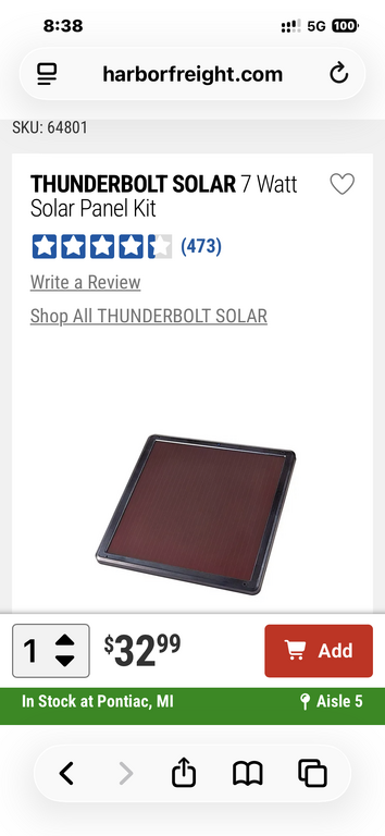

SylvanLakeWH 30,590 #11 Posted January 6 18 minutes ago, 1968Commando said: I don’t have access to electricity tho I used a solar battery maintainer on my boat that was docked remotely for years... worked great. Similar to this: Share this post Link to post Share on other sites
rjg854 12,842 #12 Posted January 6 1 hour ago, 1968Commando said: Okay will do the shutoff, I don’t have access to electricity tho get one of the solar maintainers Share this post Link to post Share on other sites
lynnmor 8,623 #13 Posted January 6 1 hour ago, SylvanLakeWH said: I used a solar battery maintainer on my boat that was docked remotely for years... worked great. Similar to this: Right now they have a 10 watt solar battery charger on sale for just $2 more, the benefit of this one is it prevents over-charging. Share this post Link to post Share on other sites
