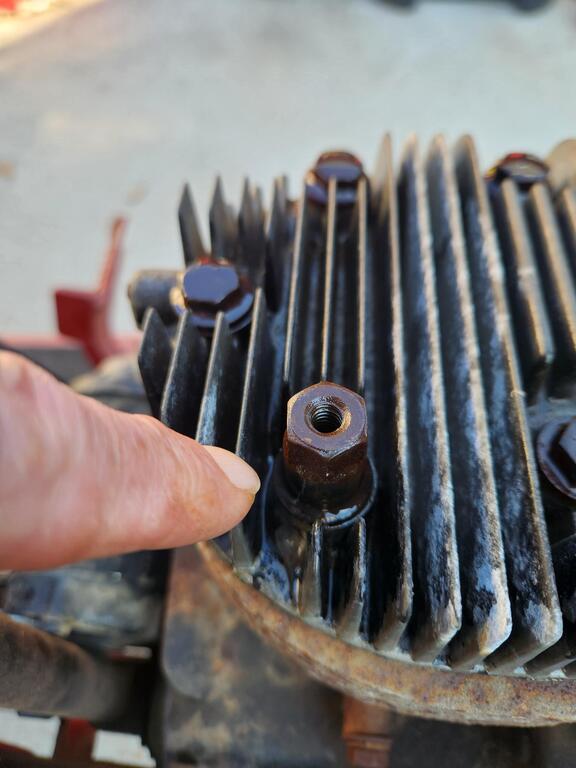

CD Long Jr 203 #1 Posted January 4 Is there a reason this head bolt is different? Share this post Link to post Share on other sites

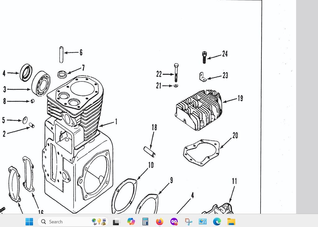

pfrederi 21,046 #2 Posted January 4 A lifting strap went on top of that bolt and was held on by a socket head bolt that threaded into the head bolt 4 1 Share this post Link to post Share on other sites
richmondred01 2,388 #3 Posted January 4 1 hour ago, CD Long Jr said: Is there a reason this head bolt is different? Magum engine for head tin 1 1 Share this post Link to post Share on other sites
