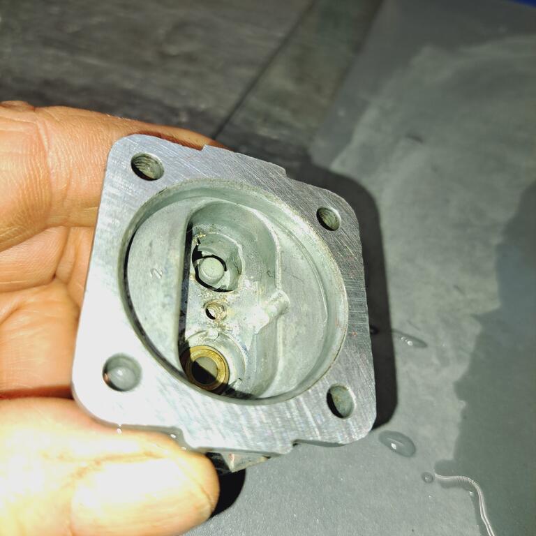

markseven 93 #1 Posted January 3 Mine fuel pump is leaking around the gasket it original . Tried tighten the screws still leaks . Do not want to buy an aftermarket one. Are they rebuildable and where to get the parts? 1 Share this post Link to post Share on other sites

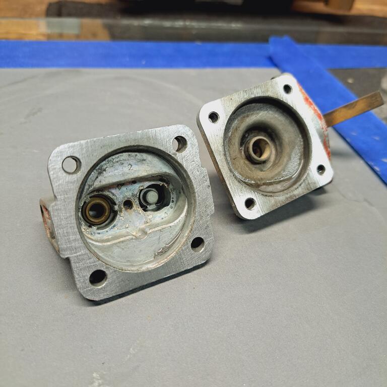

WHX?? 54,958 #6 Posted January 5 12 hours ago, markseven said: ordered the kit For the short money they are I keep one on the shelf. If the pump isn't too gunked up and check valves are good no need to buy a pricier then & now kit. I like to glass the pump halves as they can warp from over tightening. That said don't over tighten on a rebuild. 2 Share this post Link to post Share on other sites
kpinnc 17,149 #7 Posted January 6 23 hours ago, WHX?? said: like to glass the pump halves as they can warp from over tightening. That said don't over tighten on a rebuild. Just did the same on mine. Prolly gonna be next week before I order a kit. Complicated for what they are... Share this post Link to post Share on other sites
markseven 93 #8 Posted January 10 It starts insanity now with the new Diaphragm. Only problem is it still leaks . Share this post Link to post Share on other sites
markseven 93 #9 Posted January 10 On 1/4/2026 at 9:44 PM, WHX?? said: For the short money they are I keep one on the shelf. If the pump isn't too gunked up and check valves are good no need to buy a pricier then & now kit. I like to glass the pump halves as they can warp from over tightening. That said don't over tighten on a rebuild. Still leaks the diaphragm i ordered Wasn't exactly the right one. I had to slightly oblong the holes in The gasket in order for the four Bolts to go thru. Maybe this is causing the leak. What to you mean by glassing the two Halves?. Share this post Link to post Share on other sites

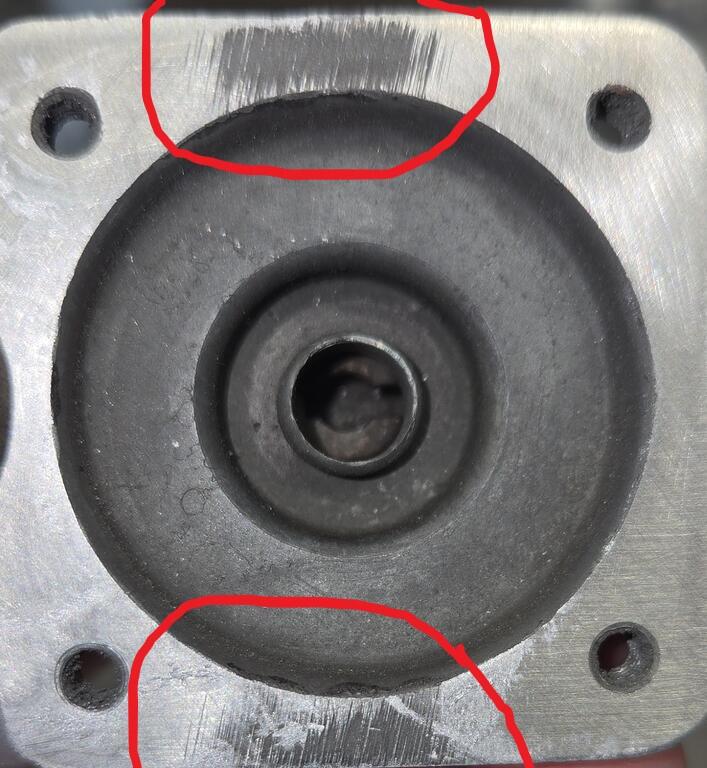

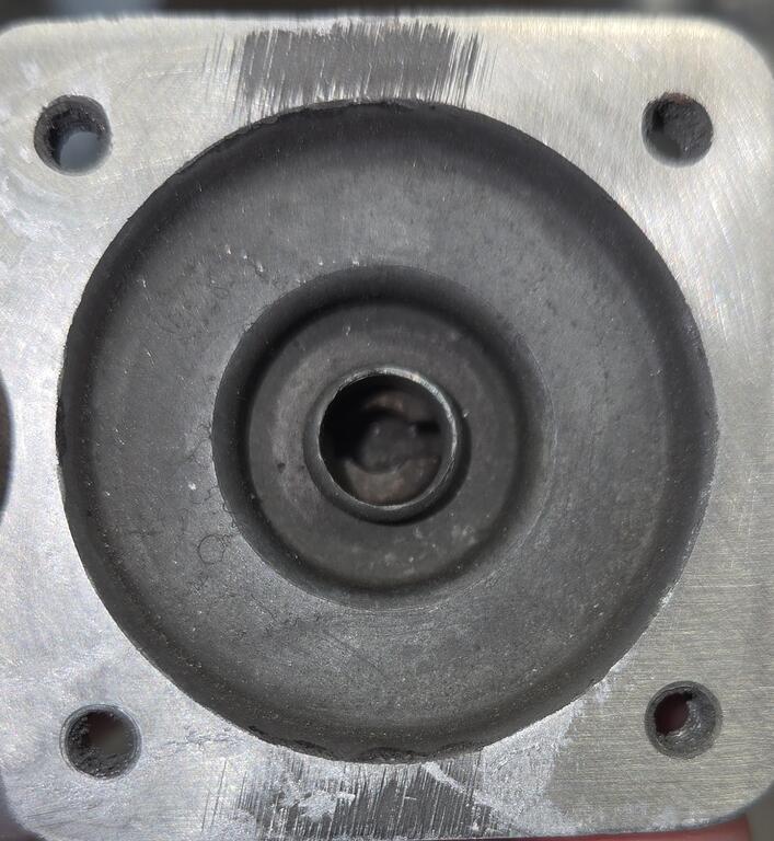

WHX?? 54,958 #16 Posted January 14 (edited) 3 hours ago, squonk said: Electric and don't look back. HAPPY MOTORING!! Not that I am admitting The Squonky is right but ... yeah some so us are as pure of tractor as we are of mind ... On 1/10/2026 at 12:14 PM, markseven said: What to you mean by glassing the two Halves?. It's a procedure where you have a piece of plate glass with a sheet of say 400 grit or better wet /dry emery paper taped to it. It provides a surface that you can sand the halves flat . Note KP's pic where the half is slightly warped. Glassing removes them. I prefer to do it wet as it floats away particles. Same procedure for glassing a head & plenty of you tubes on doing it. If you overtighten the the screws it will squeeze the diaphragm too much at the corners leaving a gap where those warped areas are. Extreme overtightening can even warp the halves further. On doing a head ... same principle headgasket.pdf Edited January 14 by WHX?? 2 Share this post Link to post Share on other sites
