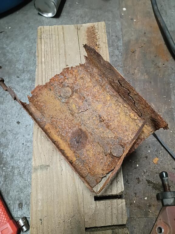

Got some more tear down done today and another batch of parts through the dip tank, im cleaning them up and hitting with some primer until I have everything ready to go back together. The only think I found that was in really tough shape was the battery tray. Anyone have one laying around they could part with? Otherwise I think I'd just make a replacement.

57 minutes ago, 855project said:
 battery tray. Anyone have one laying around they could part with? Otherwise I think I'd just make a replacement. imageproxy.php?img=&key=74de1d643bd8402f
I don't have an extra narrow one like that. Maybe check with the Redsquare vendors?  Or place a classified here?
8ntruck
Might be entertaining to put that tray in the tank and see if anything is left to pull out. :D

855project
I can do that, I'm pretty sure it's just rust holding rust together at this point but in the name of science we should know for sure
