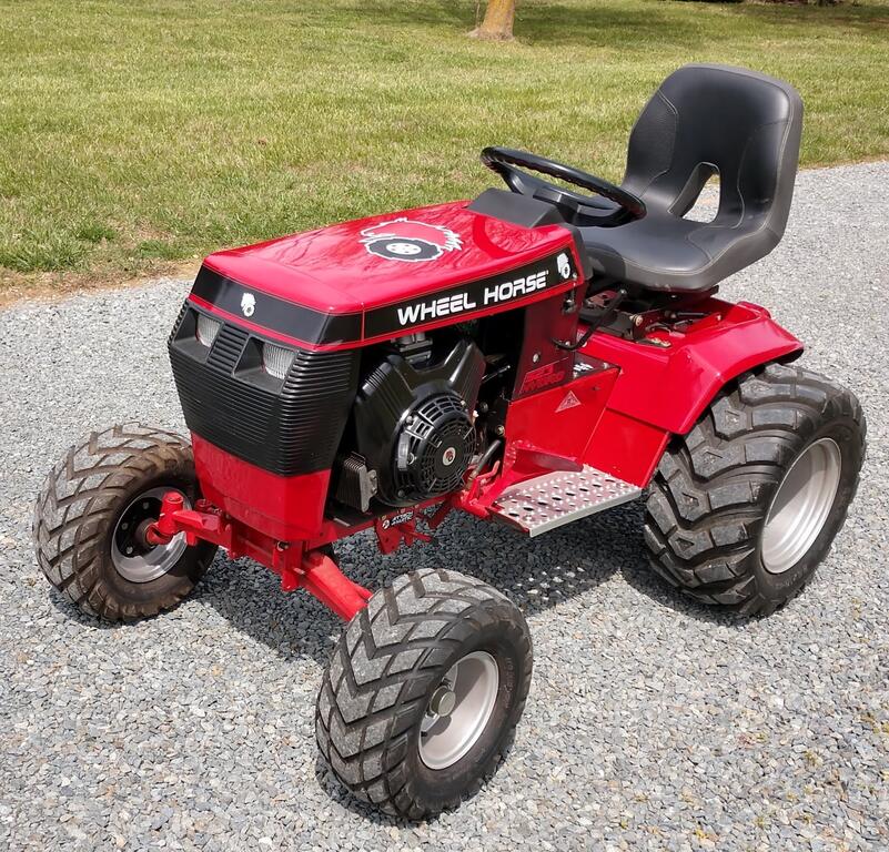

kpinnc 17,147 #3 Posted December 30, 2025 It should work just fine. Both tractors have the same center console shape and size. My "523-H" project machine had a 520-H hood early on. I swapped back to what came off a 518-H before painting. No fitment issues with either type. 6 Share this post Link to post Share on other sites
Keith R 31 #4 Posted December 30, 2025 6 hours ago, kpinnc said: It should work just fine. Both tractors have the same center console shape and size. My "523-H" project machine had a 520-H hood early on. I swapped back to what came off a 518-H before painting. No fitment issues with either type. That’s sharp I’m in need of decals soon. Thoughts on the patriotic ones ? Share this post Link to post Share on other sites
