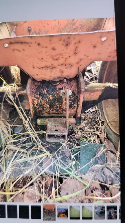

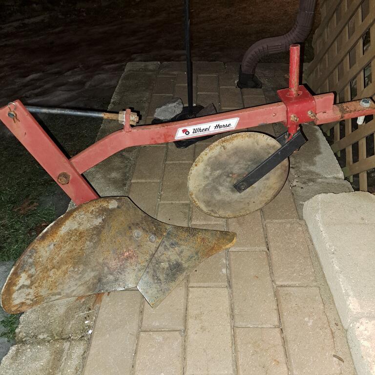

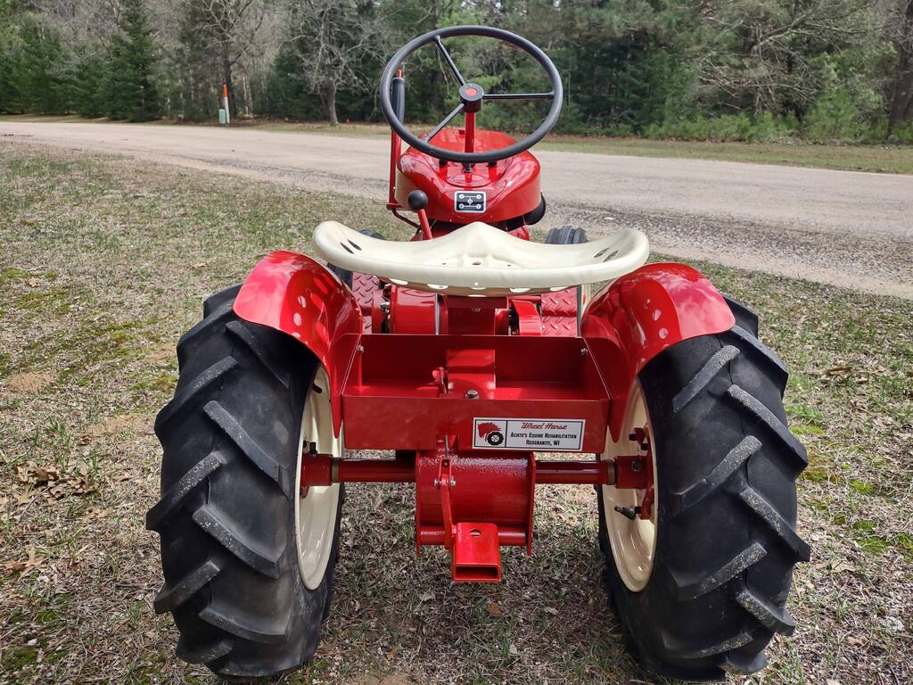

WHX?? 58,347 #176 Posted March 2 (edited) 2 hours ago, Eriks Red horse herd said: Yes it's a Wheel Horse plow Thanks Erik that does make sense. Now that I think of it my boy did mention something about a b hind when he got it. Can you confirm that mine is a plow? The one in post 162 Also is it safe to say a any plow with a slot hitch is a plow or were their other brands of 4 Wheel tractors that used a slot hitch? Edited March 2 by WHX?? 1 Share this post Link to post Share on other sites
Eriks Red horse herd 133 #179 Posted March 10 (edited) Differently a Wheel Horse PP8 the second pick is from a RJ-35 brochure 1956. There was also other manufacturers that copied the slot hitch hook up but there plows look different. Here is my 1961 Jacobsen Chief 100 the y copied a lot of Wheel Horses designs including the slot hitch. Just changed a thing or two to not get in trouble for copy right infringement. Notable things is slot hitch, transmission, lift lever, front axle. Edited March 10 by Eriks Red horse herd 1 2 Share this post Link to post Share on other sites

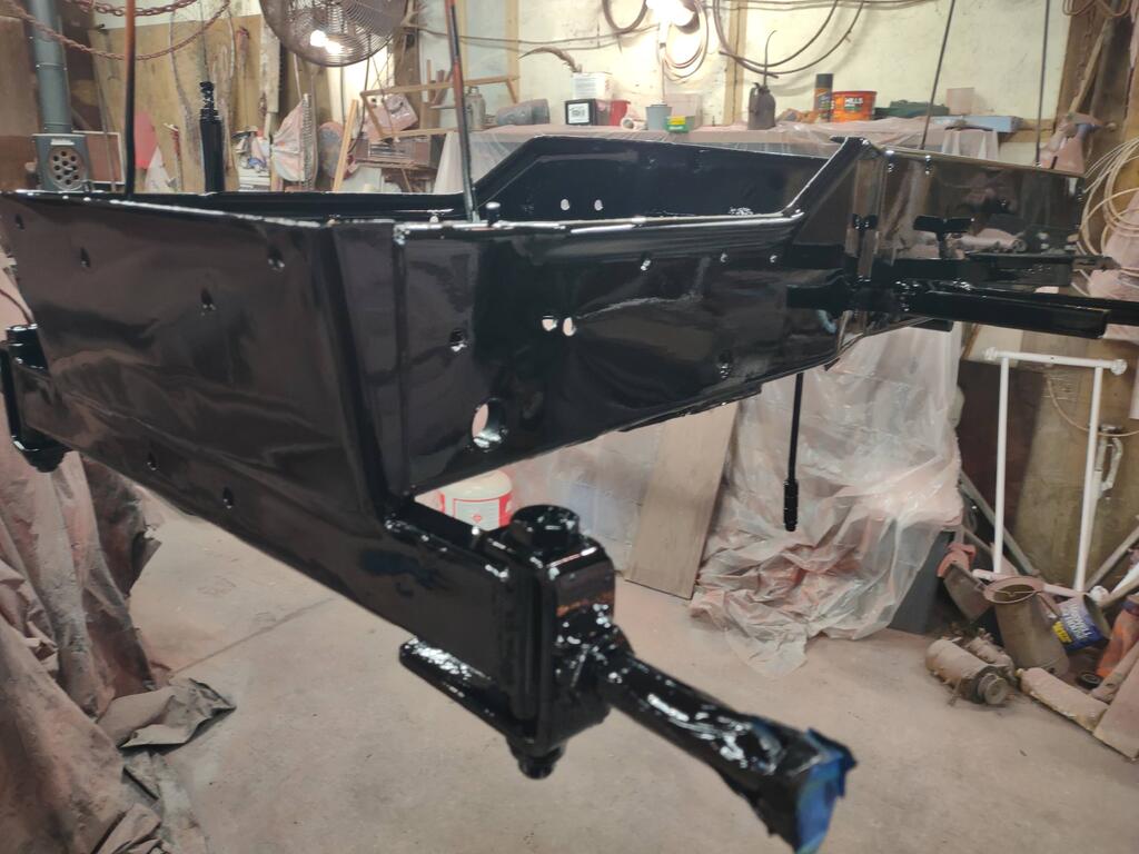

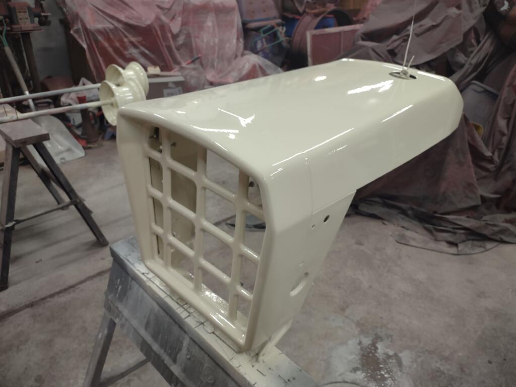

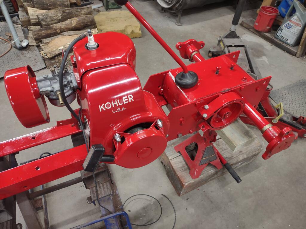

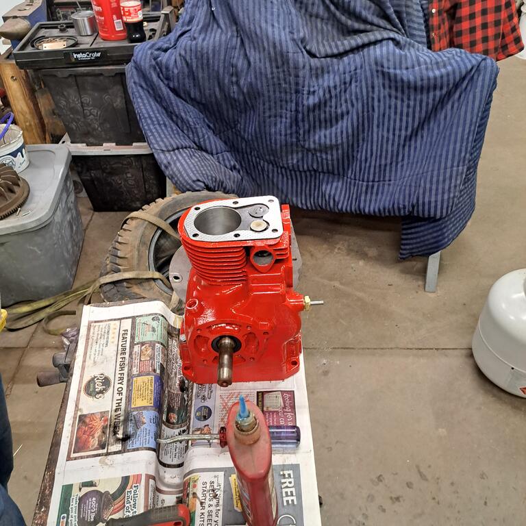

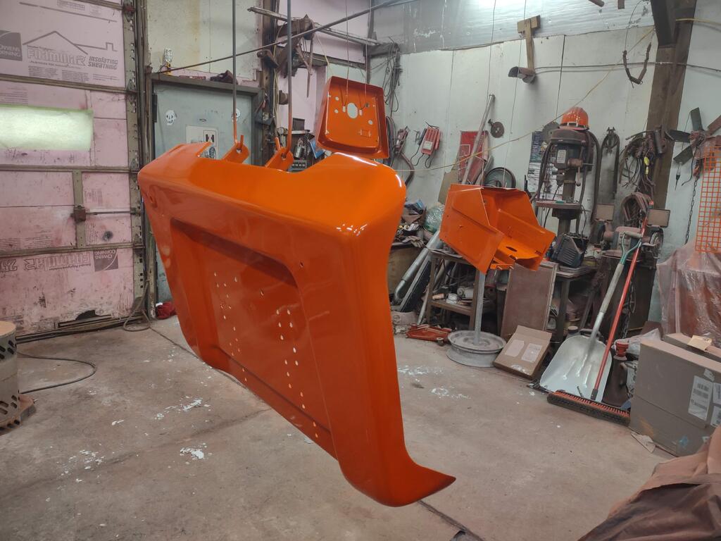

Achto 32,938 #180 Posted March 23 (edited) Been almost a month since my last post on this subject. Sooo what the heck has Dan been up to?? Well I posted some sheet metal for a C.C. that I painted black. After that I moved on to a Simplicity. Some body work followed by some white paint. More body work follow by some orange paint. This concluded the most of the Simple City side project. Rest of the Cub Cadet showed up, and I finished the rest of that up this morning. And finally I get to get back to work on my 401 project again. Spent the rest of my day assembling part of the engine. I managed to find as set of NOS OEM rings for this engine. Piston that was in the engine only had 3 rings. The NOS OEM set had more rings than a guy can collect on the first level of Sonic the Hedge Hog. . 1 in the top groove, 3 in the second groove and 4 in the third groove. @WHX?? Stopped by & gave me a hand. Thanks Jim!!! Hope to get back on track with this project. Should have more to show the next time I check in. Edited March 23 by Achto 2 5 Share this post Link to post Share on other sites

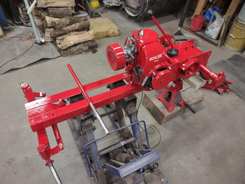

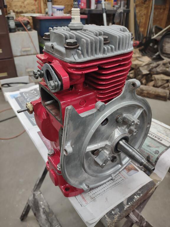

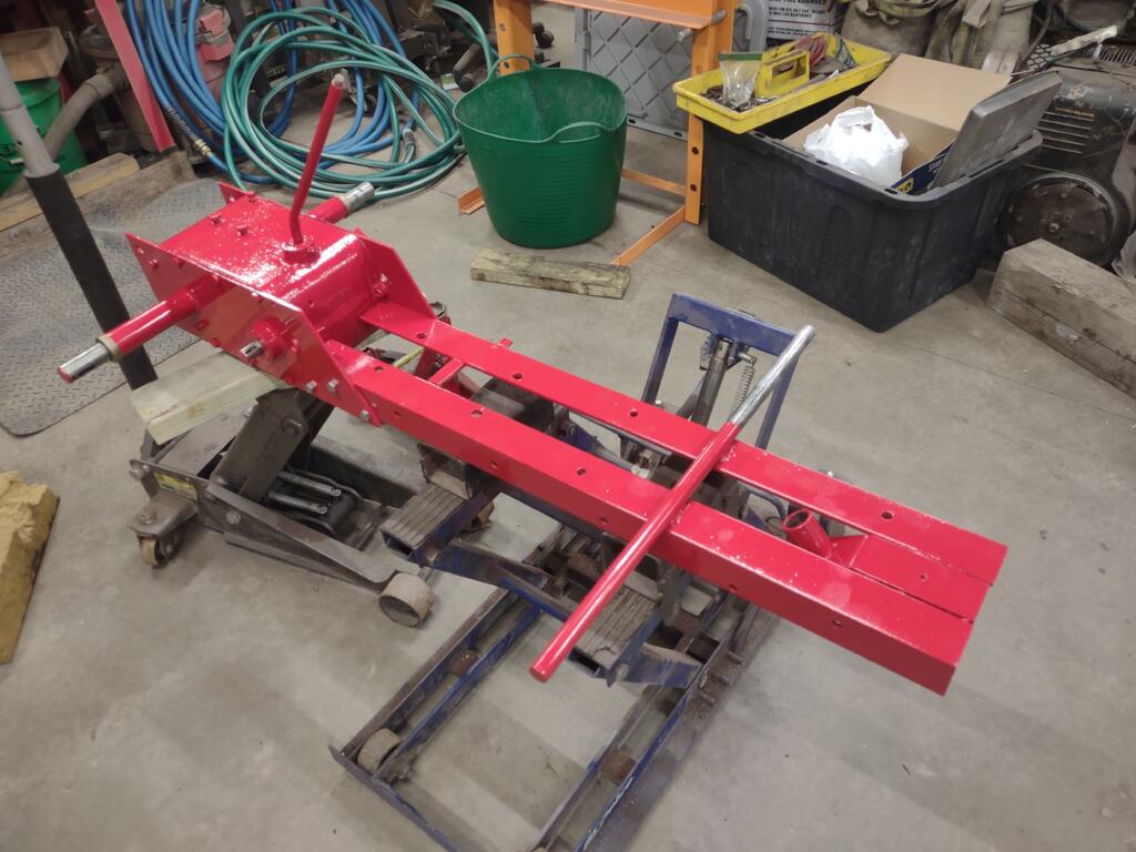

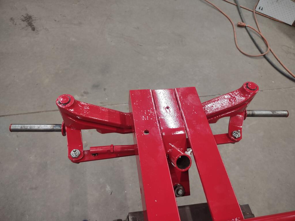

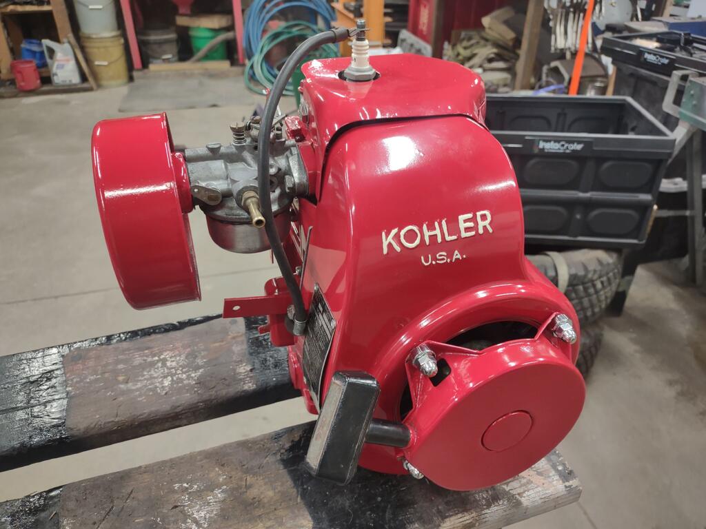

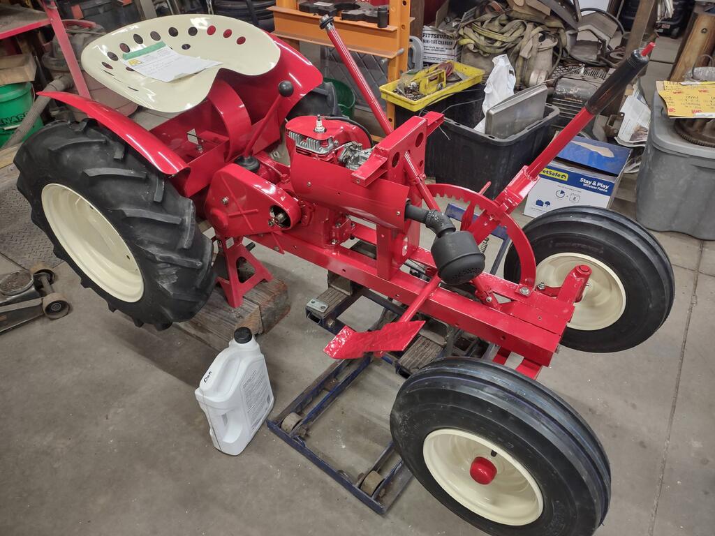

Achto 32,938 #182 Posted March 29 I was able to work on my tractor today. Given this fact I have some progress to share with y'all. Started by going back to work on the engine. Ignition components installed. Engine buttoned up and ready to mount on the frame. With the engine ready I moved on to the chassis. Front end assembled. All the fixen's installed on the tranny. Where I left off for the day. Tune in tomorrow for more progress, hopefully. 1 12 Share this post Link to post Share on other sites

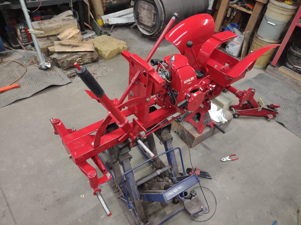

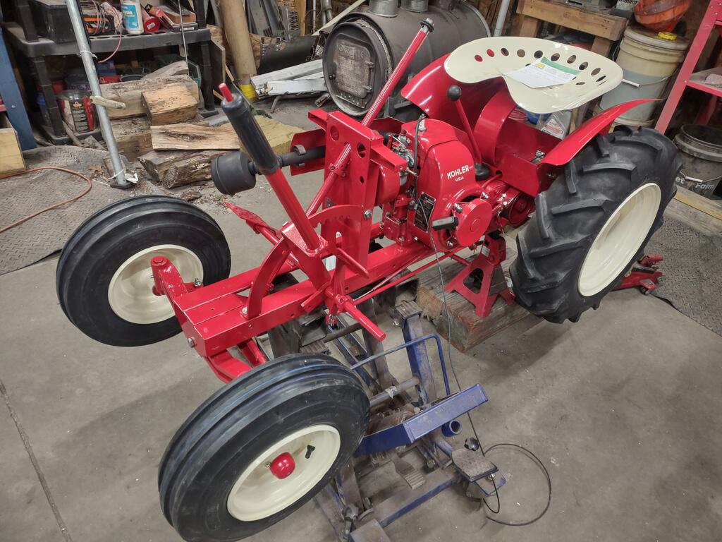

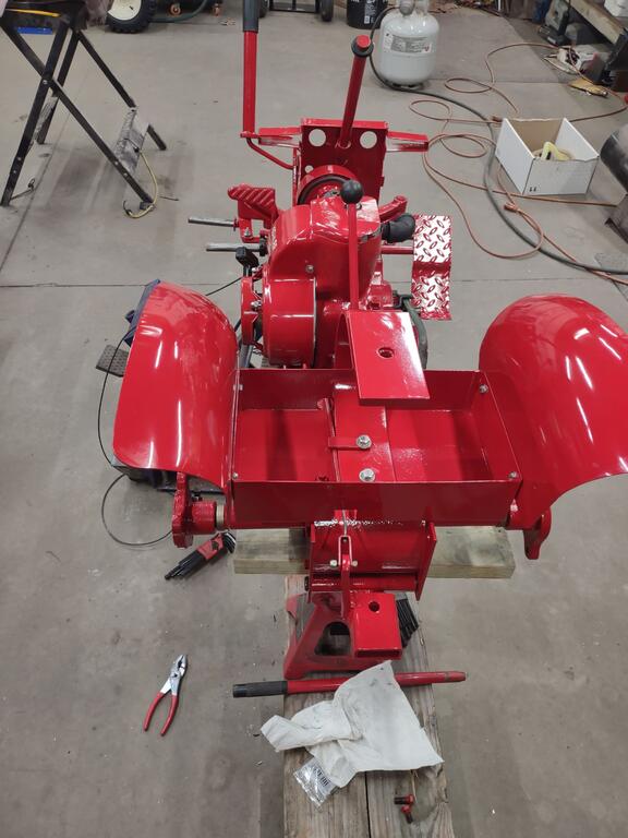

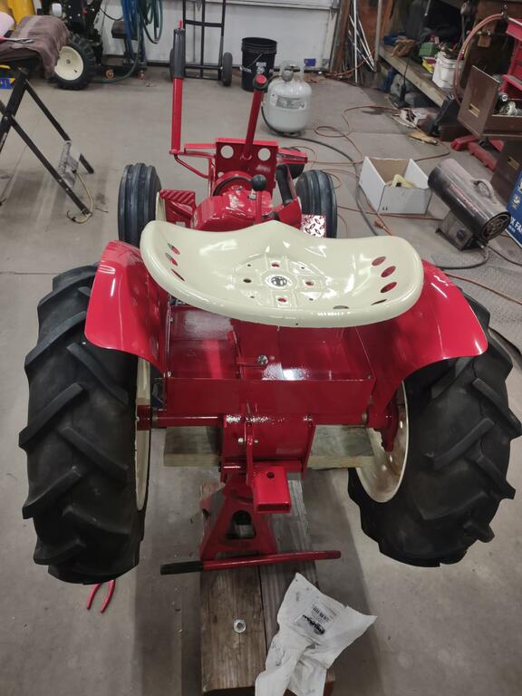

Achto 32,938 #184 Posted March 29 More progress today. Did not get it finished but I'm definitely in the home stretch. Should be able to finish this up with another days work. Maybe It will be ready for some Easter glamor shots. 1 10 Share this post Link to post Share on other sites

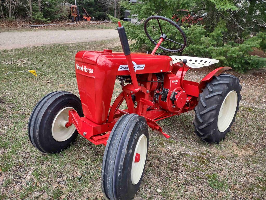

Achto 32,938 #188 Posted April 4 (edited) Well I managed to finish the assembly process today. Sorry no glammer shots, I will get some as soon as the monsoon season is over here in Wisconsin. I also got it running although the results were less that satisfactory. It idles excelent but it does not take to having the throttle pulled very well. Any amount of throttle and it wants to die. I can coax the RPM up by pushing the throttle open manually but it does not like to stay at higher RPMs. Runs even worse when it gets warm. Messed with the carb, cleaned the points several times with no good results. Pulled the rope soo many times that I have the infamous blister between me fingers. So after some head scratching, I'm thinking that I may have a bad condenser. ? If anyone else has any ideas, I'm all ears. As for the condenser change, I'm thinking about moving the condenser out in the open instead of keeping it under the flywheel. Edited April 4 by Achto 4 Share this post Link to post Share on other sites
sqrlgtr 4,192 #189 Posted April 4 This may not be even close to your problem but I had an 8hp that would not take any throttle hardly at all and had sumin to do with the guvner but for thelife of me I cant remember what I had to do to it but it runs great now. A condenser would be easy enough to swap out with one from a good runner. 1 Share this post Link to post Share on other sites
jeremi3210 759 #190 Posted April 5 44 minutes ago, Achto said: So after some head scratching, I'm thinking that I may have a bad condenser. ? If anyone else has any ideas, I'm all ears. If the carb in nice and clean thats what I'd do, as far as moving it thats not a bad idea I hate pulling flywheels. 1 Share this post Link to post Share on other sites
wallfish 20,738 #191 Posted April 5 2 hours ago, Achto said: I'm thinking that I may have a bad condenser. ? If anyone else has any ideas, I'm all ears. The symptoms seem to point that way 2 Share this post Link to post Share on other sites

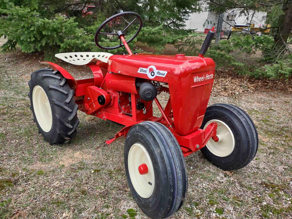

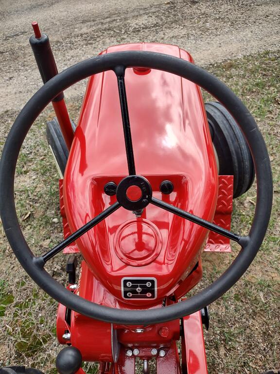

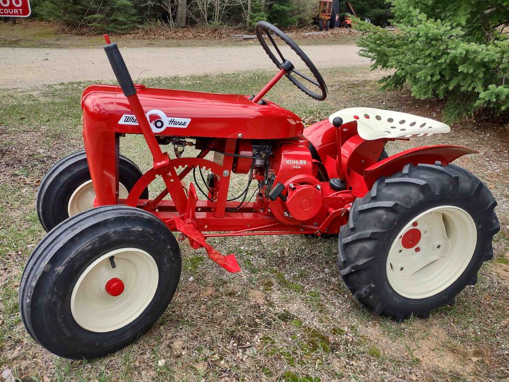

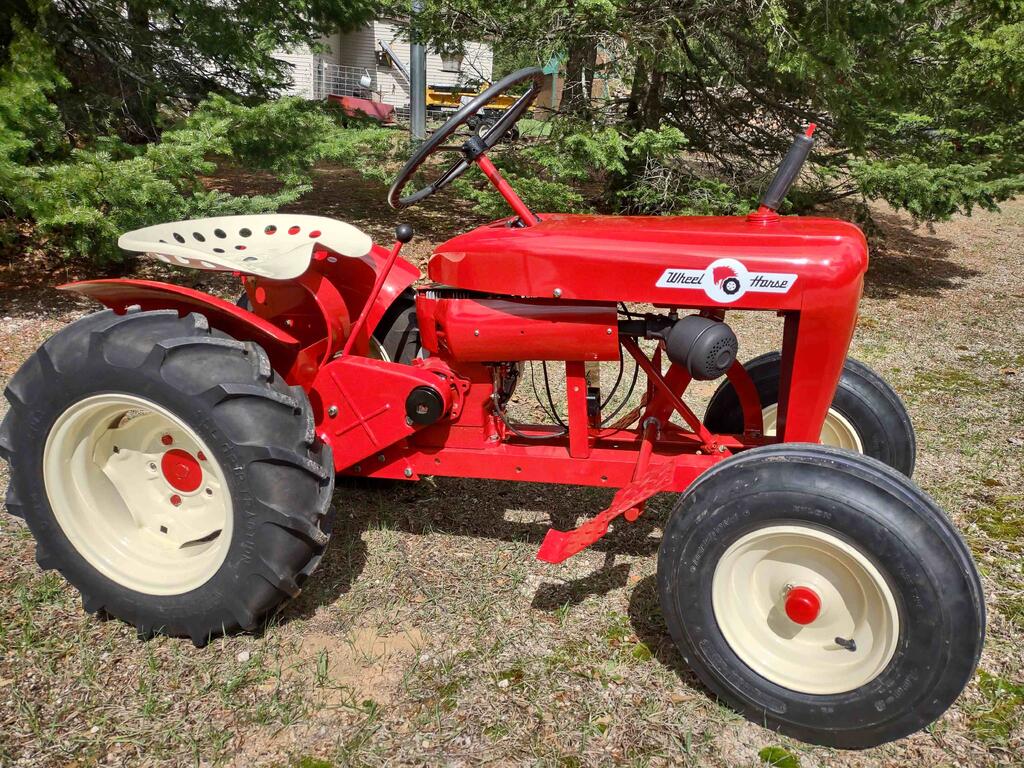

Achto 32,938 #192 Posted April 18 (edited) Finally able to wrap this project up. Well, almost. will get into that at the end of this post. First we'll take a look back at where I started. And finally some pictures after a few hours work. Thanks for following along. Sure looks purty, just wish I could get it running right. I spent a fair amount of time trying different things with the engine today, but I just can't seem to get it to run good at high RPMs. Been a while since I've had an engine kick my but like this. I know that I have to be missing something, just wish that some type of epiphany would hurry up & hit me. Edited April 18 by Achto 1 14 Share this post Link to post Share on other sites
sqrlgtr 4,192 #193 Posted April 19 Excellent all but the not running correctly. Excuse my ignorance but does this engine have points? 2 Share this post Link to post Share on other sites
Achto 32,938 #194 Posted April 19 39 minutes ago, sqrlgtr said: Excuse my ignorance but does this engine have points? Yes it does, in fact it has a brand new set of Kohler points. Also had a brand new Kohler condenser. 1 Share this post Link to post Share on other sites
WHX?? 58,347 #195 Posted April 19 Yep but the condenser ... which is brand new ... is behind the flywheel. Points which is like most others is right out front. He claims he played with everything ... including himself ... to get it to run right. Did you try tea bagging?!?!?!? I have no idea Dan but gotta be a a points/ condenser thing. Just don't see how it could be magneto related. I almost think you have two problems that are making diagnosis difficult. Maybe carb/ignition ? FYI guys it had a NOVAR pointless on it before resto and ran what Dan OK?? 5 1 1 Share this post Link to post Share on other sites
sqrlgtr 4,192 #196 Posted April 19 Well if you two cant digure it out Im probably of no use to ya. Coil? 3 Share this post Link to post Share on other sites
WHX?? 58,347 #197 Posted April 19 Ok not sorry here Bro but looking at the before pics how could you have stripped that girl from her working cloths? Oh that's right you like seeing girls naked ... need I drop a pic of the Saturn? 2 3 Share this post Link to post Share on other sites
Achto 32,938 #198 Posted April 19 6 minutes ago, WHX?? said: had a NOVAR pointless on it before resto and ran what Dan OK?? Started hard but ran ok once running. 2 Share this post Link to post Share on other sites
mudmowerdiesel 236 #199 Posted April 19 2 hours ago, Achto said: Finally able to wrap this project up. Well, almost. will get into that at the end of this post. First we'll take a look back at where I started. And finally some pictures after a few hours work. Thanks for following along. Sure looks purty, just wish I could get it running right. I spent a fair amount of time trying different things with the engine today, but I just can't seem to get it to run good at high RPMs. Been a while since I've had an engine kick my but like this. I know that I have to be missing something, just wish that some type of epiphany would hurry up & hit me. Awesome job 1 Share this post Link to post Share on other sites
kpinnc 19,065 #200 Posted April 19 3 hours ago, Achto said: And finally some pictures after a few hours work. I'm a bit too big to comfortably drive a Surburban, which is why I sold my RJ and my 551. Your restoration makes me question my decision. It looks awesome! 2 1 Share this post Link to post Share on other sites
