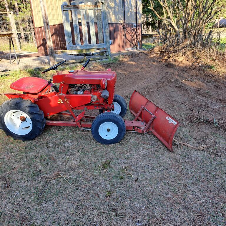

WHX?? 58,052 #102 Posted February 8 I gotta believe this plow is original to the tractor??? 2 5 Share this post Link to post Share on other sites
squonk 48,062 #103 Posted February 8 (edited) 33 minutes ago, WHX?? said: I gotta believe this plow is original to the tractor??? I thought they came with the side shifter model BD4271 with the foot pedal release. I know the 64 604 we had had the plow you pictured with the 702. Maybe they used both and was a buyer's choice? Edited February 8 by squonk 1 Share this post Link to post Share on other sites

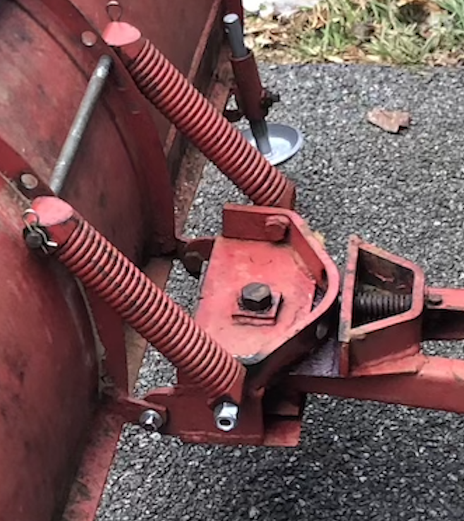

Handy Don 17,459 #104 Posted February 8 (edited) ’63 Blade was the last model with the foot-pedal release for rotation and the last time the quadrant was open at the top with close-spaced holes for three positions. Also first time trip springs had cast iron end-pieces. Blade Dozer 42in 1963 BD-4263 newer.pdf Starting in ’64, quadrant was enclosed (top and bottom) with handgrip actuated rotation release. Blade Dozer 42in 1964 BD-4264.pdf ’63 also last to have welded-on skid holders Edited February 8 by Handy Don 1 Share this post Link to post Share on other sites

Handy Don 17,459 #109 Posted February 8 4 hours ago, WHX?? said: I gotta believe this plow is original to the tractor??? Depending on when the tractor sold or the plow bought.... That’s a ’64 or later plow (enclosed quadrant, handgrip rotation release) 2 1 Share this post Link to post Share on other sites
peter lena 10,046 #110 Posted February 8 @Handy Don love that plow swing quadrant , a tuned up swing lever , unless you already have it , makes those swing with ease also like the blade slide disks , ever try a spring on those ? love experimenting with anything , the more you use it , the more detailing you can add . just out plowing last nights sub zero snow , powder dry snow , plowin fool , more seat time . pete Share this post Link to post Share on other sites

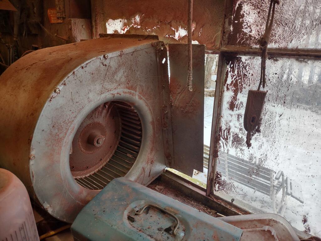

Achto 32,630 #111 Posted February 9 (edited) On 2/8/2026 at 7:57 AM, WHX?? said: Show 'Fish a pic of the exhaust fan Dan! It was an old POS furnace fan I rigged up in a window. Can't believe it still runs. High tech air exchange unit. Professionally installed by an HVAC expert. As you can see by the surrounding area, it has had a fair amount of paint fumes run through it. I remove it every now & then and clean the big chunks off with a blow gun. BTW - I know you are retired and all now @WHX??. I was just wondering if this thing is still under warranty? It quit on me once today, started back up after it sat for about 5 min. Edited February 9 by Achto 7 Share this post Link to post Share on other sites
SylvanLakeWH 32,457 #112 Posted February 9 Looks like cheap curdeseum junk to me... did you get the warranty in writing? Not that the installer can read or write... 3 Share this post Link to post Share on other sites

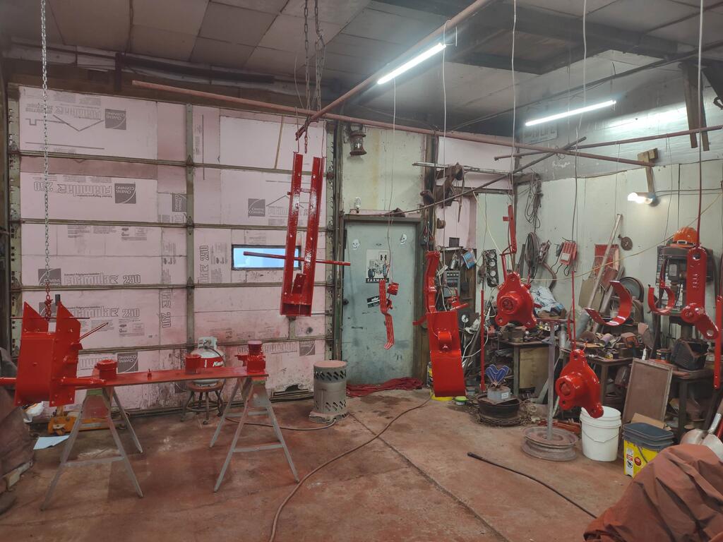

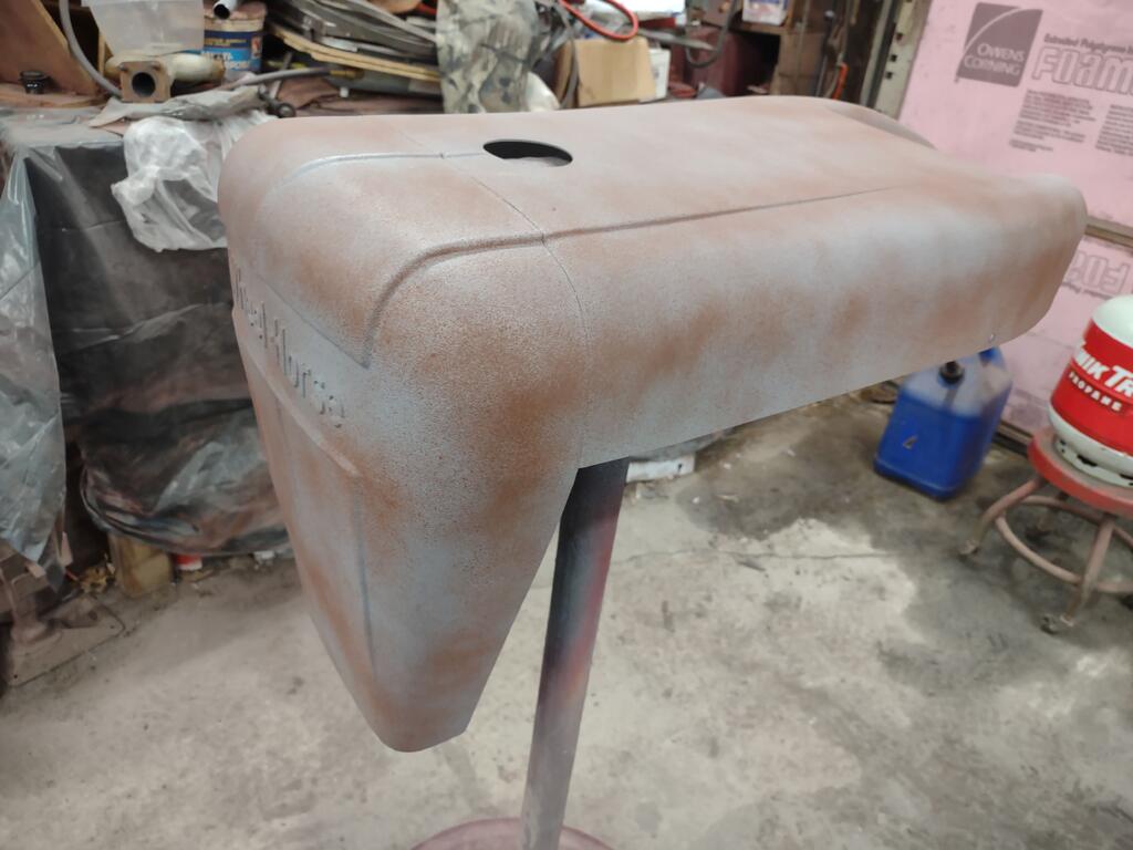

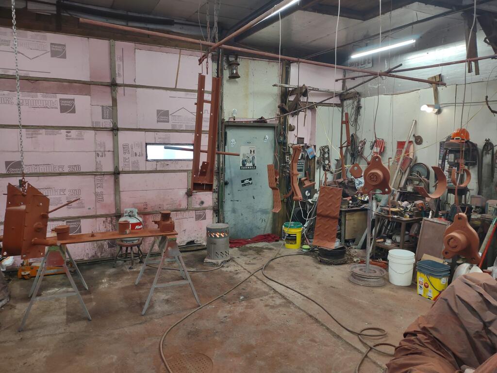

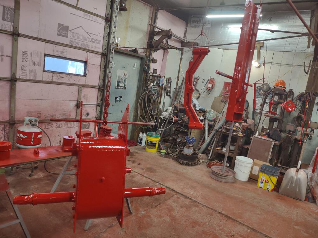

Achto 32,630 #113 Posted February 9 (edited) The sheet metal that I primed gray yesterday received a mist coat red oxide today. This will serve as a guide coat when I'm wet sanding. Sand all the red oxide off and you know you are finished. Out with the rims & primed sheet metal, in with all the rest of the parts that need to be painted red. First 2 coats of red oxide enamel primer. Then sit back for an hour and wait for the primer to flash off completely. ( Waiting is my least favorite part of painting ) Finally time to let the red fly. @wallfish Yesterdays gray floor is now red. Edited February 9 by Achto 13 1 Share this post Link to post Share on other sites
SylvanLakeWH 32,457 #114 Posted February 9 (edited) Breathe deep the gathering red, watch lights fade from the work room's dread... Oh wait, wrong song... Looking good @Achto!!! Edited February 9 by SylvanLakeWH 1 2 Share this post Link to post Share on other sites

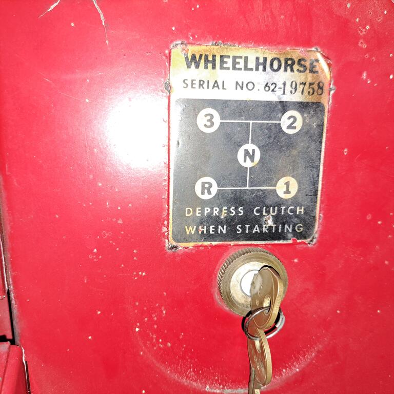

gwest_ca-(File Mod) 12,483 #115 Posted February 9 8 hours ago, Handy Don said: Depending on when the tractor sold or the plow bought.... That’s a ’64 or later plow (enclosed quadrant, handgrip rotation release) Is the serial number 40819? Share this post Link to post Share on other sites
WHX?? 58,052 #116 Posted February 9 25 minutes ago, gwest_ca said: Is the serial number 40819? Best pic I have and since sold the tractor but sure looks like 40819. Just for the files Garry a 502. 2 Share this post Link to post Share on other sites
gwest_ca-(File Mod) 12,483 #117 Posted February 9 Best pic I have and since sold the tractor but sure looks like 40819. Looks like a 1964 serial number. 1 Share this post Link to post Share on other sites

squonk 48,062 #121 Posted February 9 16 hours ago, Achto said: High tech air exchange unit. Professionally installed by an HVAC expert. As you can see by the surrounding area, it has had a fair amount of paint fumes run through it. I remove it every now & then and clean the big chunks off with a plow gun. BTW - I know you are retired and all now @WHX??. I was just wondering if this thing is still under warranty? It quit on me once today, started back up after it sat for about 5 min. I would call a reputable local HVAC mechanic and have him pull that blower and clean it so you can save some energy. Don't let him rip you off! 5 Share this post Link to post Share on other sites
