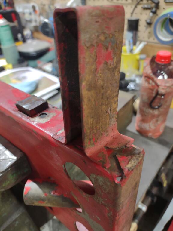

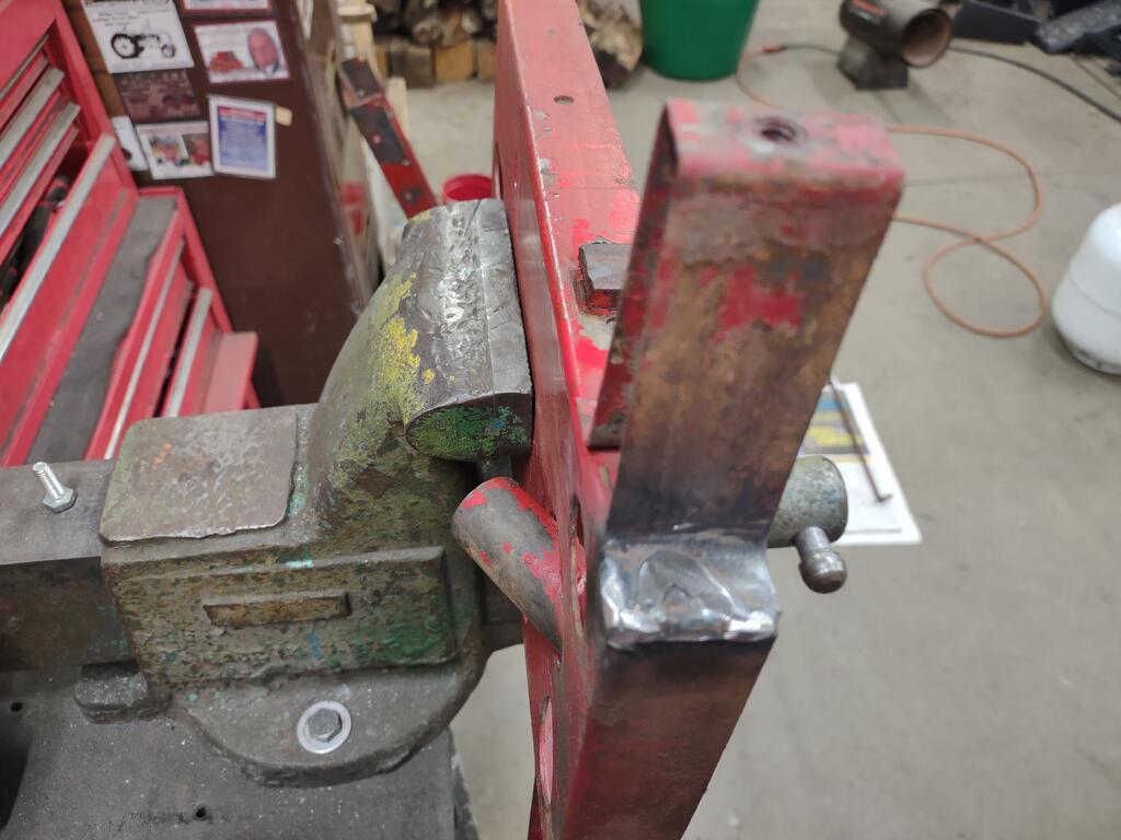

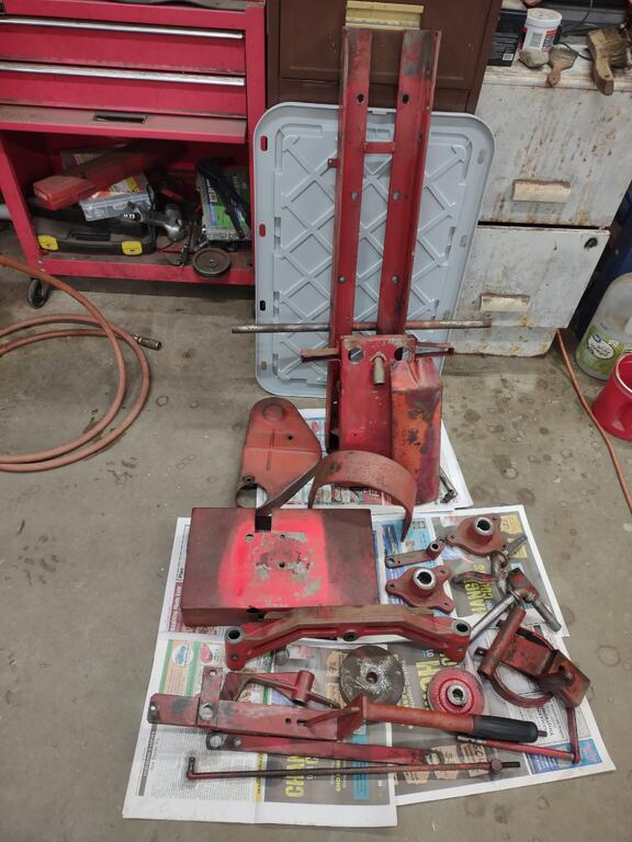

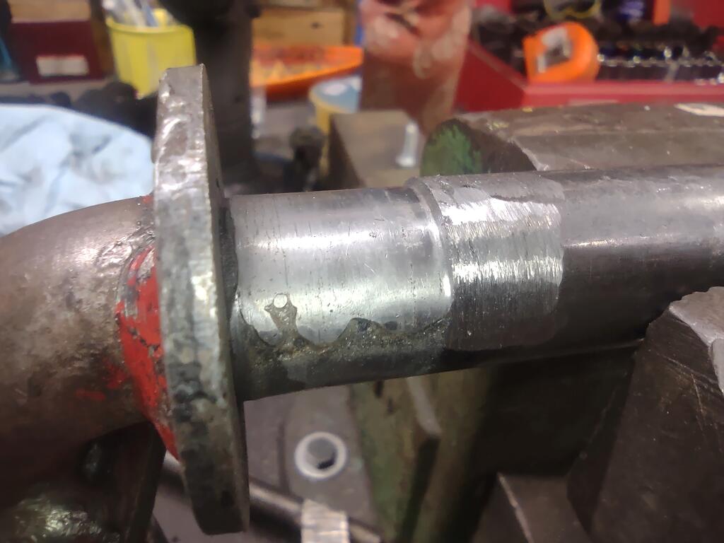

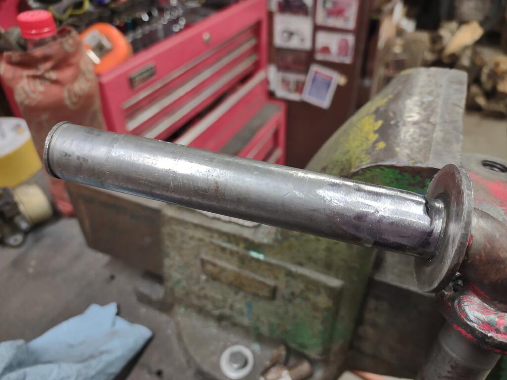

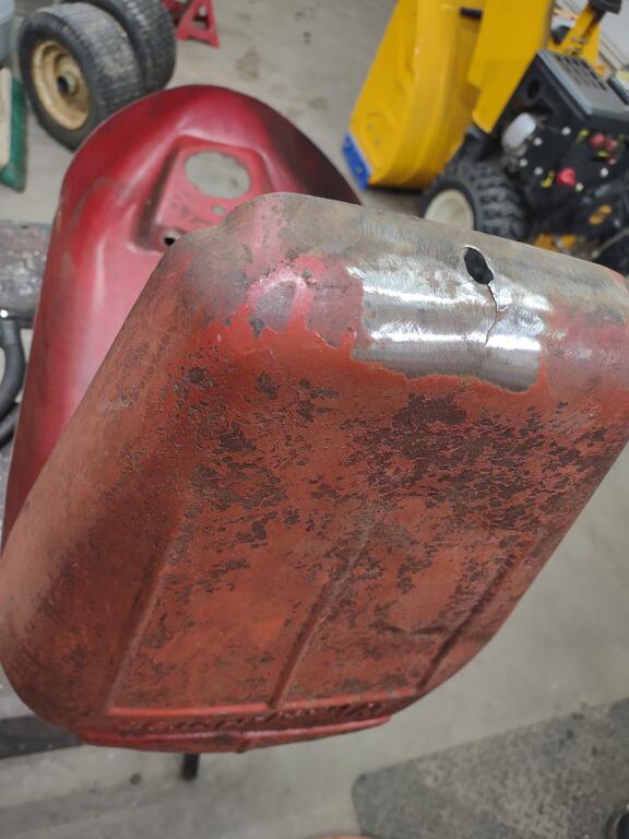

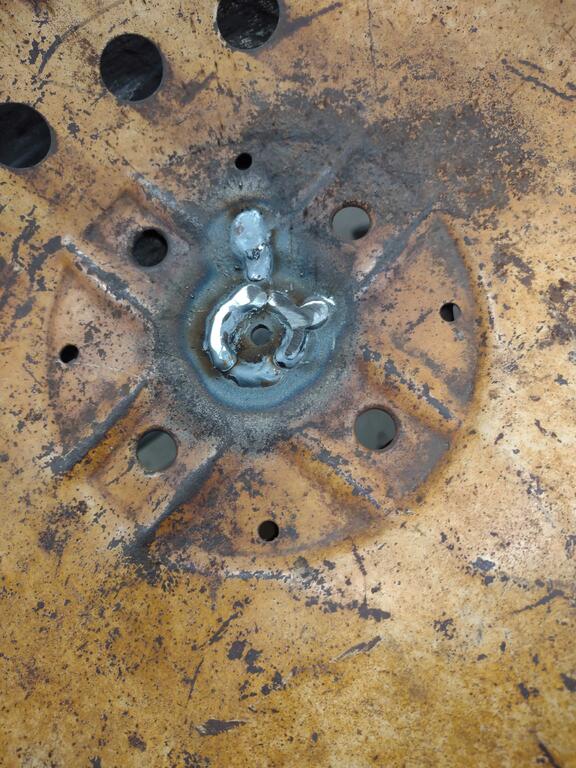

Achto 32,630 #29 Posted January 1 (edited) Happy New Year everyone !!! With the day off I figured I'd take advantage of getting paid to work on my own stuff. A little progress report for y'all. First off I degreased the parts so that they would be ready for the blast cabinet. With the dishes done it was time to move on to repairs. First off get the drag link that a PO welded to the fan gear removed. Hood stand had some fatigue cracks that needed to be addressed. Tool box also had some fatigue cracks. Drilled some holes at the end of the cracks, beveled them out & welded them up. @AlexR was recently asking about spindle repairs. The spindles on this tractor had some pretty severe wear. I welded these then trimmed them back down to size with a grinder & a file. Bearing now fits snug on the spindle. That's all for today. Edited January 1 by Achto 3 12 1 Share this post Link to post Share on other sites
kpinnc 18,939 #30 Posted January 2 4 hours ago, Achto said: That's all for today. Excellent work sir! I've done some of those spindle repairs. I know exactly how much grinding and filing goes into getting them back to round and even. One of my 701 spindles took more than once to weld and grind back true. 2 Share this post Link to post Share on other sites

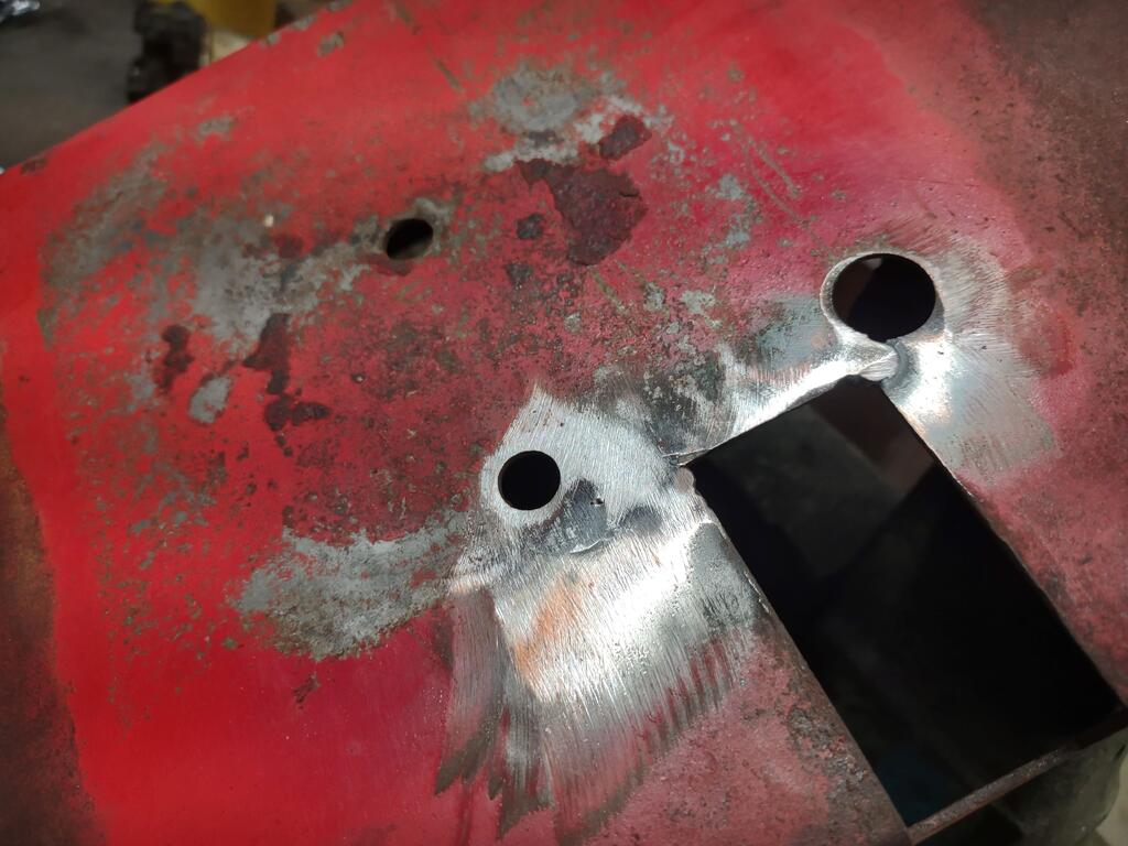

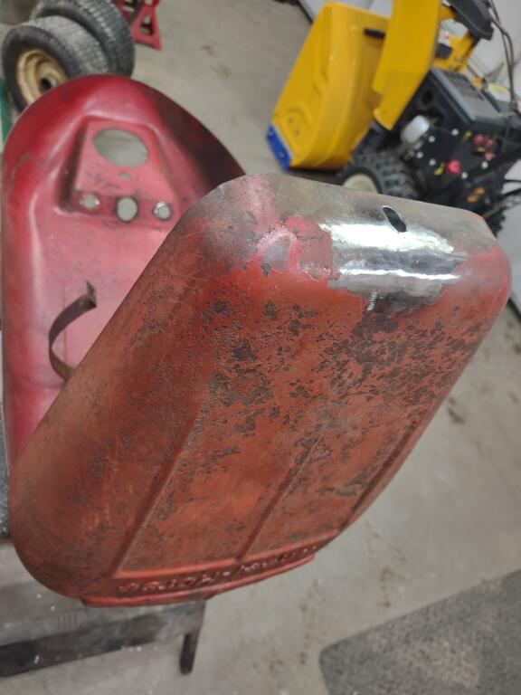

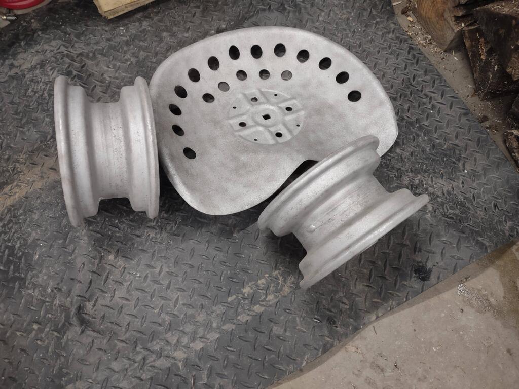

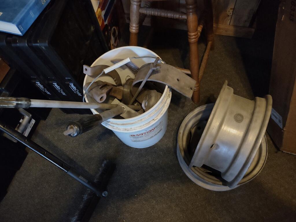

Achto 32,630 #34 Posted January 5 (edited) More sheet metal repair. The bolt hole in the seat was busted out, fact it was so big the the head of a 1/2 carriage bolt would drop right through it. I used a hole saw to make a washer out of 10ga sheet metal. Welded this washer in place plus took care of a couple of stress cracks. Ground all the welds smooth, Squared the hole to fit a 1/2" carriage bolt. The seat and front rims then made a trip through the blast cabinet. Moved on to the hood which had some cracks around the front mounting hole, plus plenty of dents. Spent a couple hours with a hammer in my hand bouncing back & forth between the anvil, a sand bag, and some hand dollies to get it as straight as I could. It will still need some minor body filler work to be perfect. After it was straitened out I drilled some holes at the end of the cracks, beveled the cracks out, weld & grind. Other than that all I have to show is a bucket full of sand blasted parts. Edited January 5 by Achto 2 10 Share this post Link to post Share on other sites

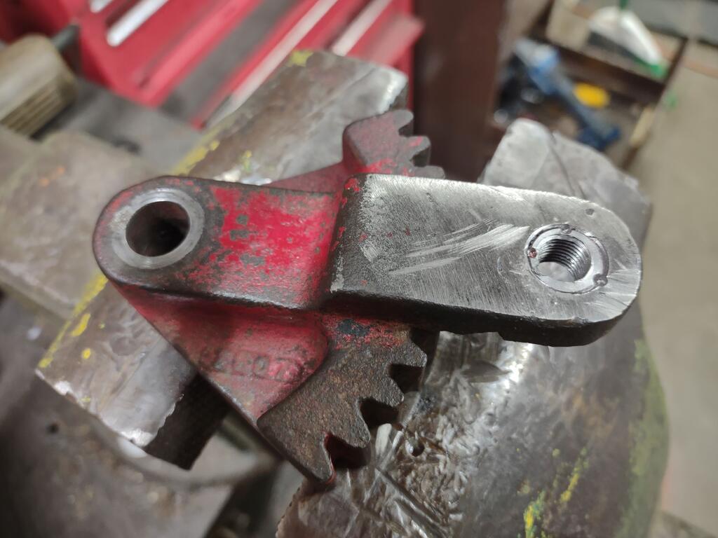

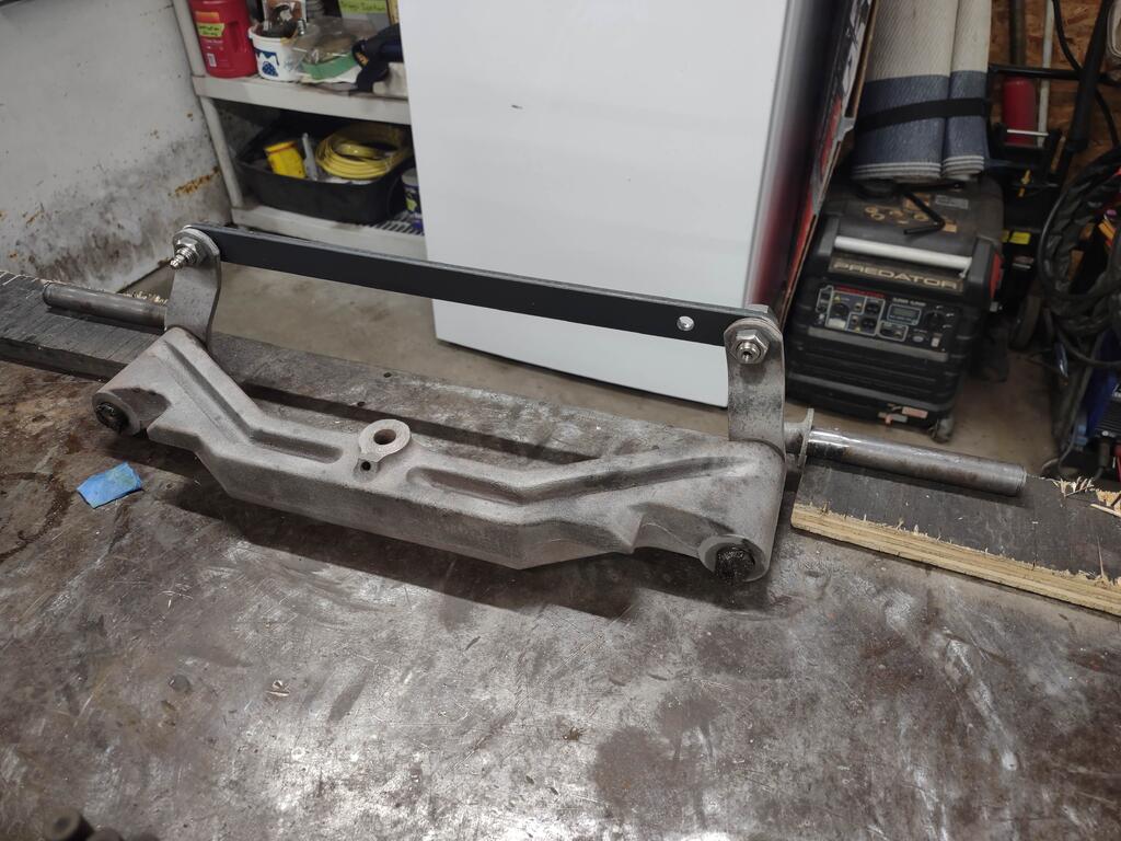

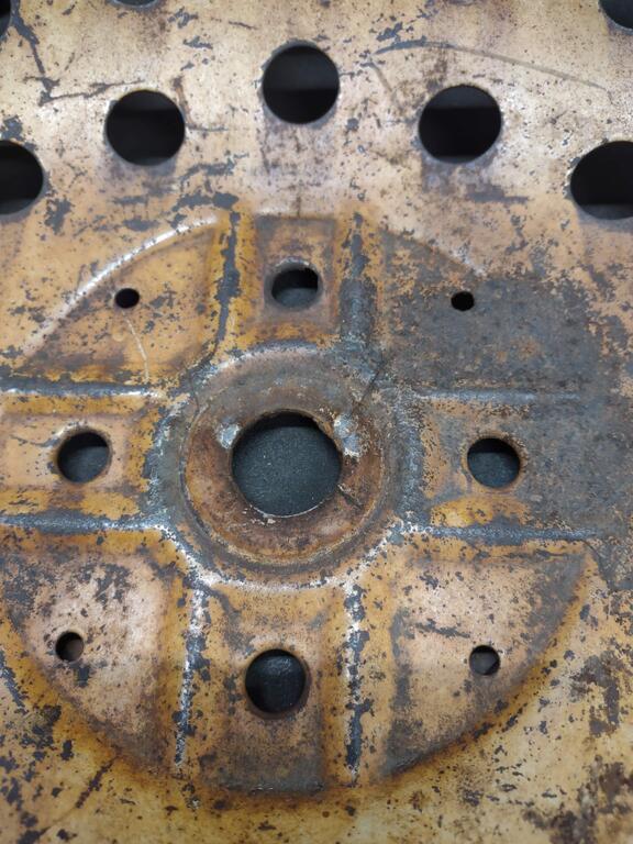

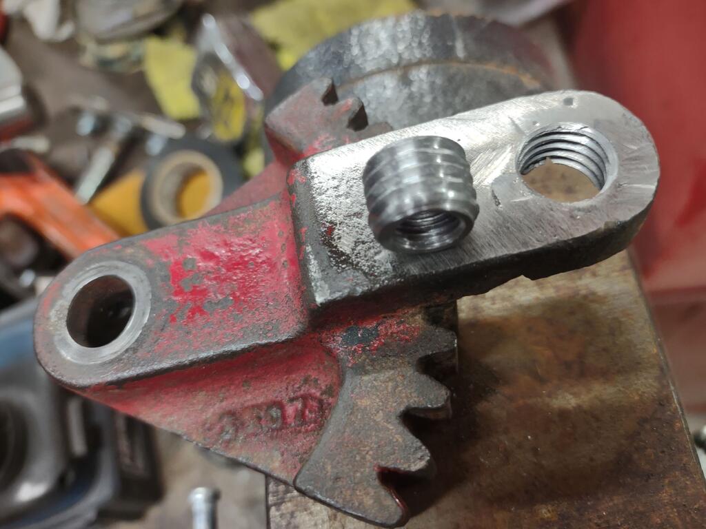

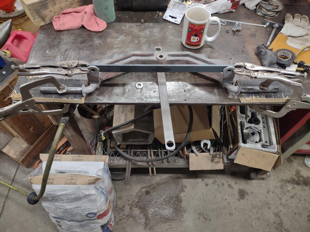

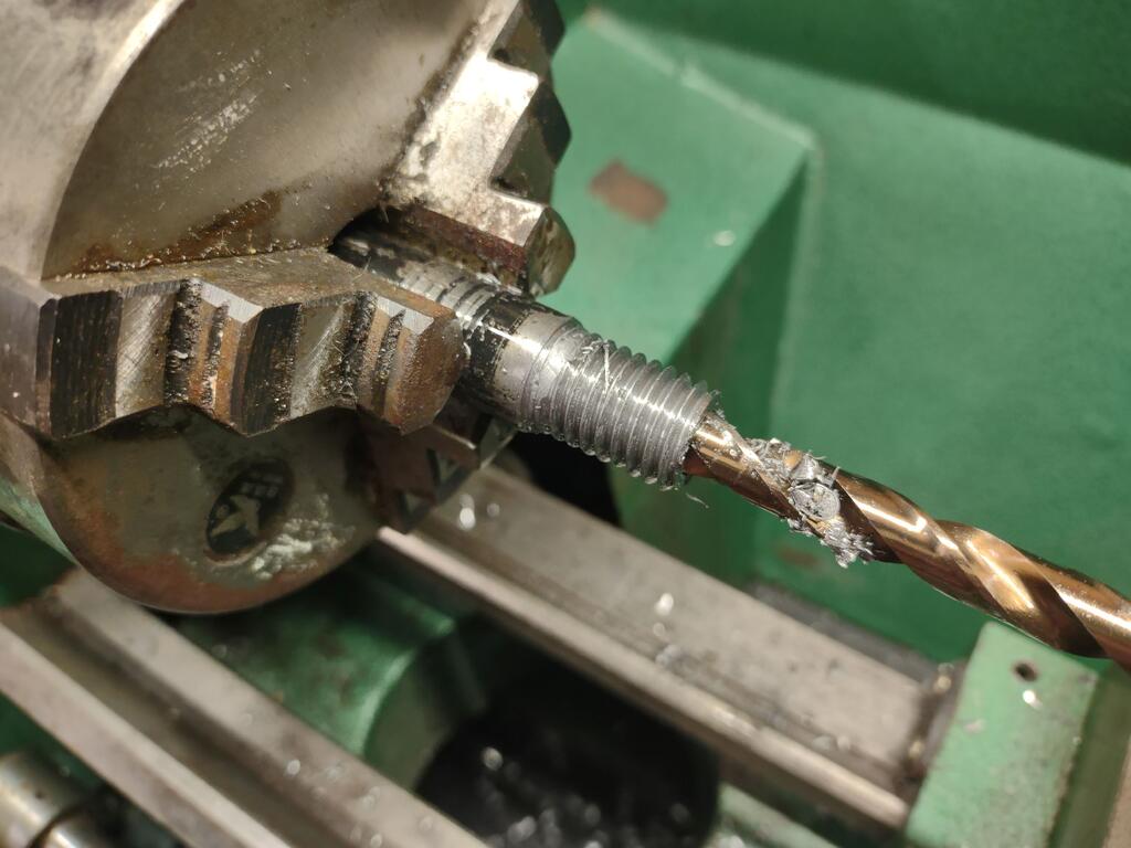

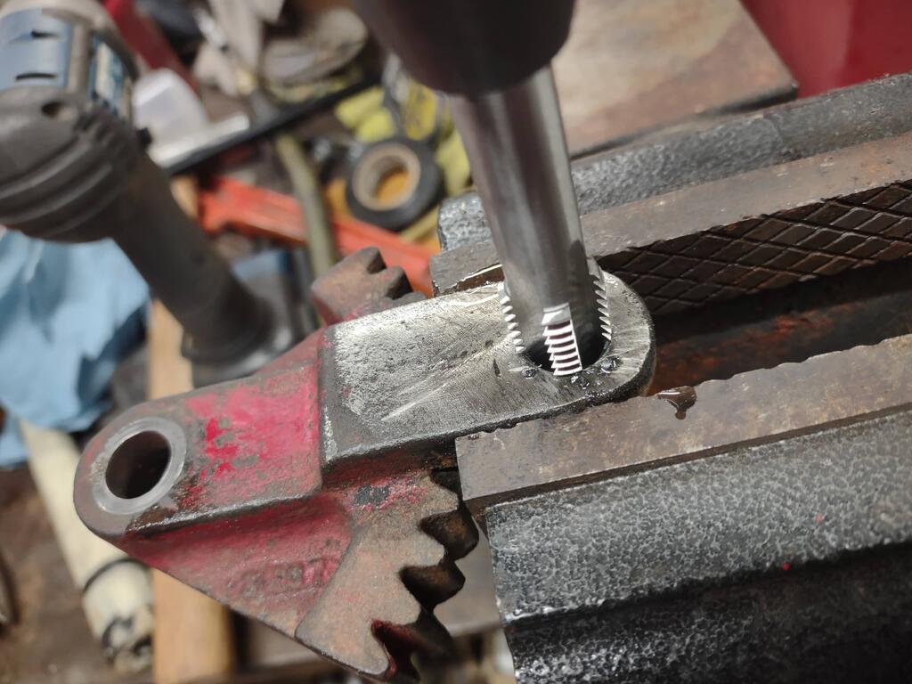

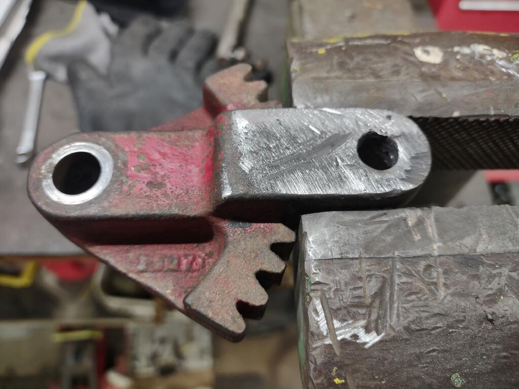

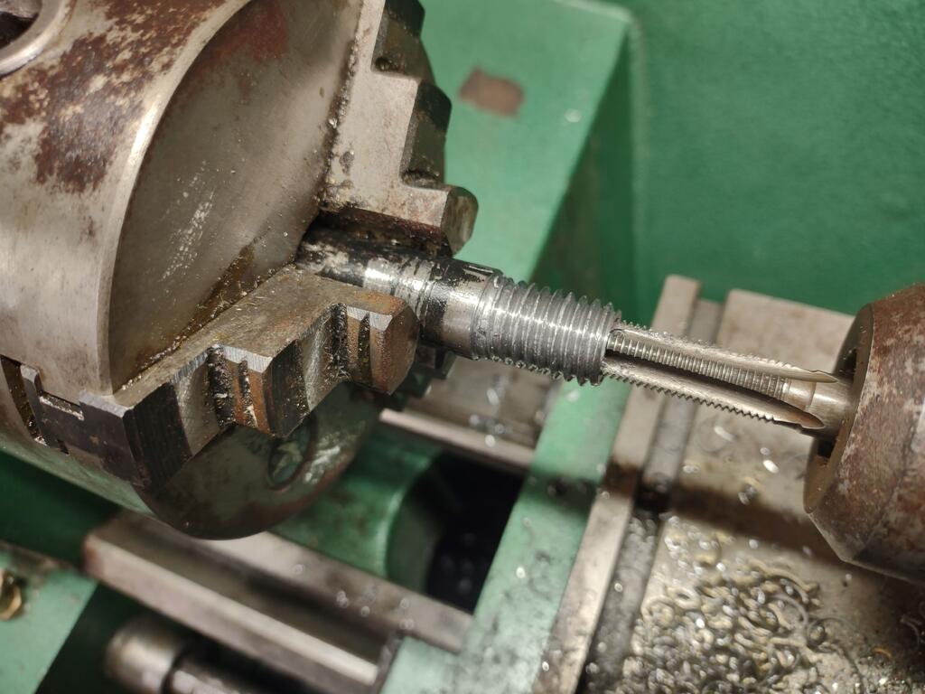

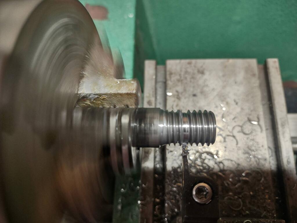

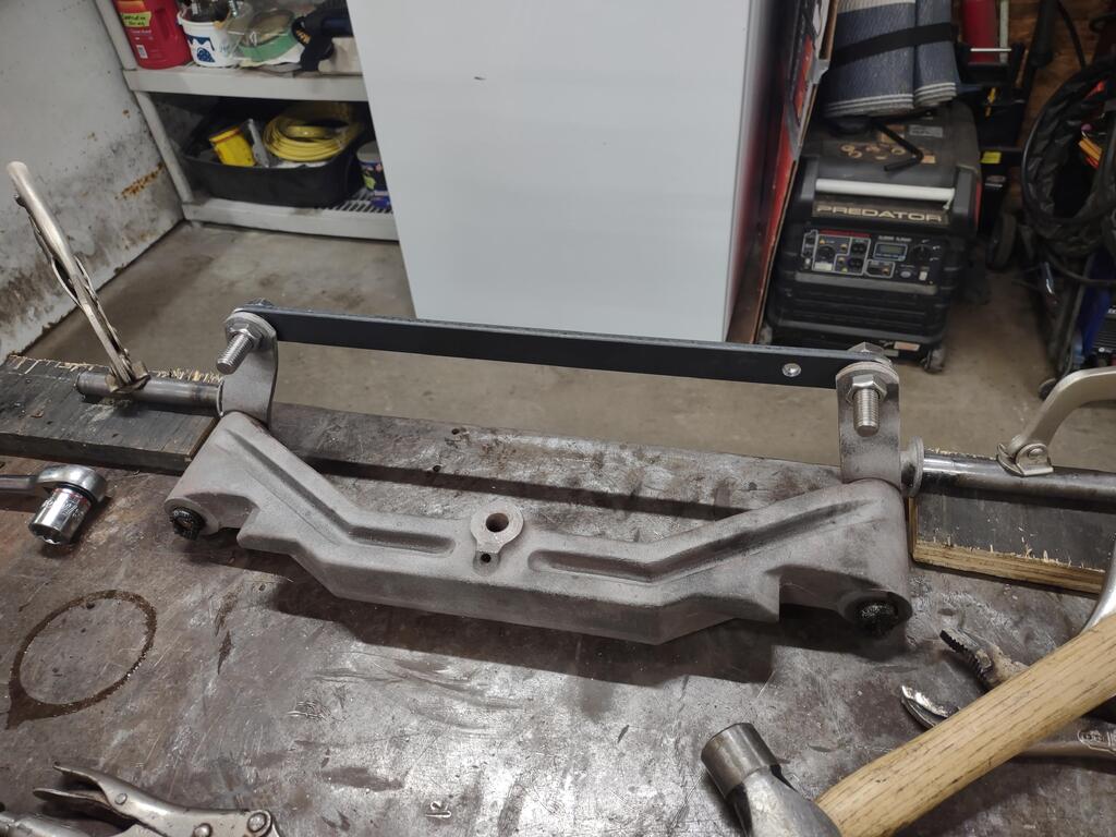

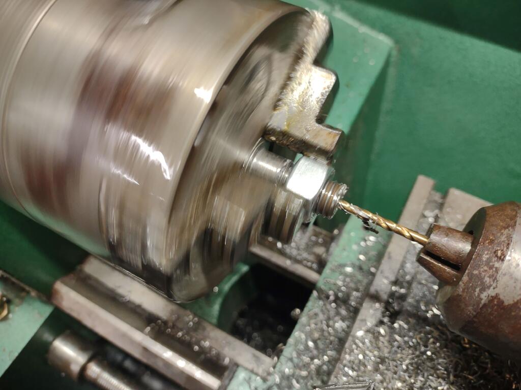

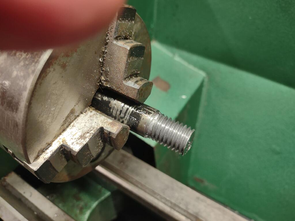

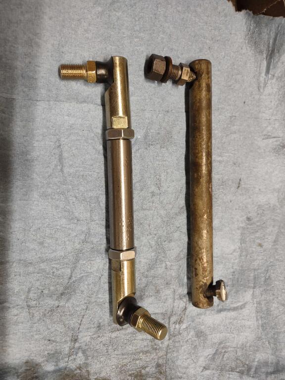

Achto 32,630 #38 Posted January 11 (edited) Todays adventure - rebuild the steering system. To start off I turned a portion of 5/8" stock down to 9/16" and threaded it to 12 pitch. Next drill a hole in it and tap the inside of it to 3/8-24. Then use a parting tool to cut it to length. OK, what am I building here ?? Remember the fan gear that the PO messed up by welding the drag link to it? The hole in it was too large for a heal-a-coil. So I tapped the hole in it to 9/16-12. What I made was an insert to repair the require 3/8-24 hole in the fan gear. Inserted with Loctite plus I peened the edges to ensure that it does not move. Next - take a peace of 5/8" x 4.5" stock, turn a 15/16" length of each end down to 7/16" and thread it to a 20 pitch. One new drag link. Now for the tie rod that was butchered up. First off, position the front axle and spindles so that everything is held strait. Then cut a 1" x 5/16" flat bar to length. Use a transfer punch to mark the outer holes. Drill the 1/2" holes in each end and the 3/8" hole for the drag link and test bolt things together. Looking good, now it was time to turn the two 1/2' bolts into part #3949 clevis pins. Cut to length and then drill an 1/8" hole 1" deep into the end of the bolt. Drill & tap the end to 1/4-28 to a depth of 3/8" for a grease zerk. Drill an 1/8" cross hole to meet up with the 1/8" length wise hole so that grease can get to the pivot point. Front end repaired & almost ready for some paint. Edited January 11 by Achto 21 Share this post Link to post Share on other sites

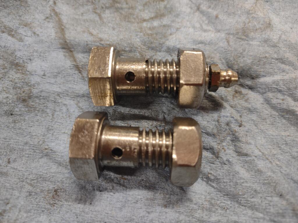

kpinnc 18,939 #40 Posted January 11 2 hours ago, Achto said: Front end repaired & almost ready for some paint. Just awesome. I tried to make a set of stainless pivot bolts on the 701. My tooling just isn't tough enough for stainless so I reused the originals. 2 Share this post Link to post Share on other sites

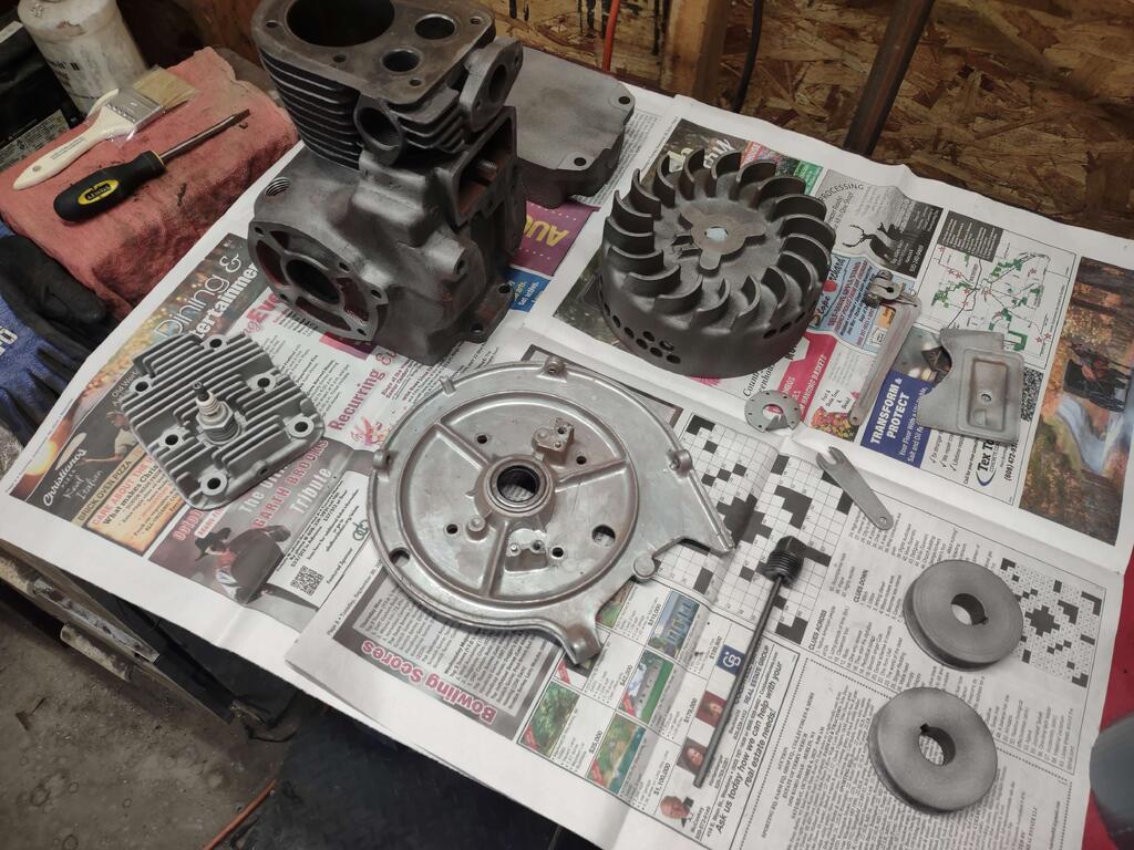

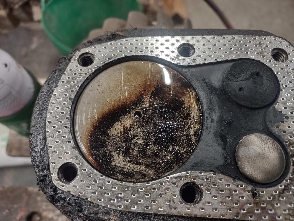

Achto 32,630 #41 Posted January 12 Not very picture heavy today. One of today's goals was to clean the engine up to prepare it for paint. Part of that goal was to investigate the oil seepage from the head gasket. When I pulled the head, this was the scene. Way too much piston wash for my tastes, not to mention the small puddle of oil laying on top. Given this knowledge, well.. this happened. Thanks to @WHX?? for helping me tear the engine down. Measurements were taken and it looks like it will need a new set of rings & some gaskets. Not a planned event in this resto but nothing that can't be fixed. 7 2 Share this post Link to post Share on other sites
WHX?? 58,052 #42 Posted January 12 Ready for gaskets, rings & red... 2 1 Share this post Link to post Share on other sites
