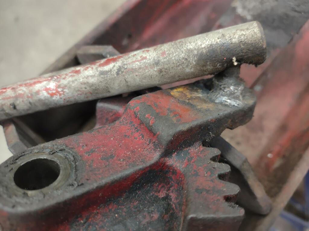

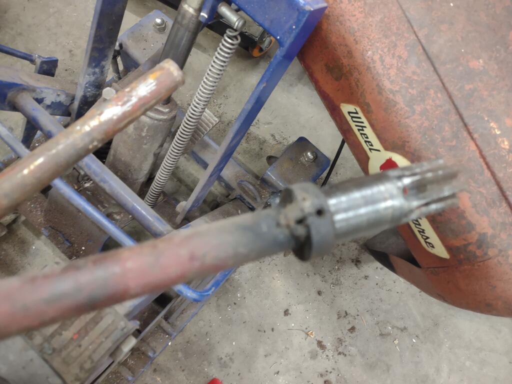

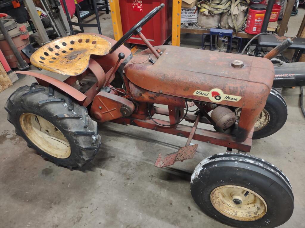

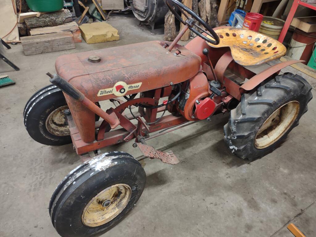

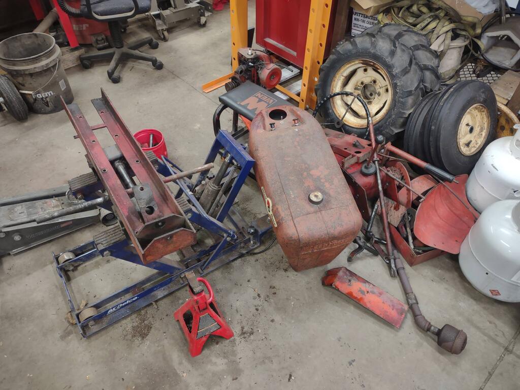

Achto 31,309 #1 Posted December 29, 2025 (edited) Here I go again. As the title says, this years project is a 401 Suburban. Will start off with some ground 0 pics. Next step that I was happy about was my Christmas Miracle. The steering wheel came off without special tools or much resistance. When I bought the tractor it had a Nova ignition module on it. Starting it was sometimes a challenge so I wanted to switch it back to points before disassembly. Happy to say that it starts much better on points than it did with the Nova module. With this accomplished it was time to move on to tear down. A couple of hours later & I had a pile of parts. I went through the transmission shortly after I bought the tractor because it had a 3rd gear issue, so that will not have to come apart again. The engine runs good with no smoke, so hopefully it will not need a rebuild. It does appear to be seeping oil from the head gasket, so I will pull the head to change the gasket. Will also inspect cylinder condition as long as it's open. Now for some P.O. surprises. Lets just say that some people should not be allowed to play with welders. First, when a lock collar cracks I guess one should grab the welder & tack it in place. Drag link issue?? Lets burn that in place too. I'm sure there will be a few more surprises. Feel free to come along for the show. Edited December 29, 2025 by Achto 8 14 Share this post Link to post Share on other sites

clueless 3,360 #10 Posted December 29, 2025 So how did you remove the steering wheel? 1 Share this post Link to post Share on other sites
Achto 31,309 #11 Posted December 29, 2025 11 minutes ago, clueless said: o how did you remove the steering wheel? Soaked it with Sea Foam Deep Creep a week before trying. Roll pin drove out easily. Turned the wheel all the way to the left, gave an extra nudge and it spun on the shaft. Spun it a few times on the shaft & it pulled right off. Easy peasy. 8 3 Share this post Link to post Share on other sites
wallfish 19,498 #13 Posted December 29, 2025 Nice to start out with a complete tractor. All of those little goodies which typically go missing on those tractors can get expensive and time consuming to hunt them down. 5 2 Share this post Link to post Share on other sites
