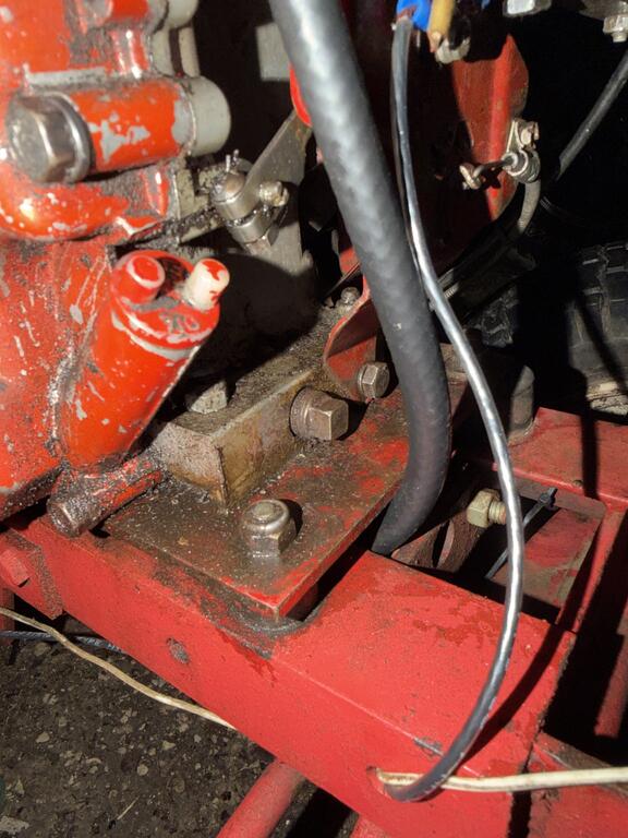

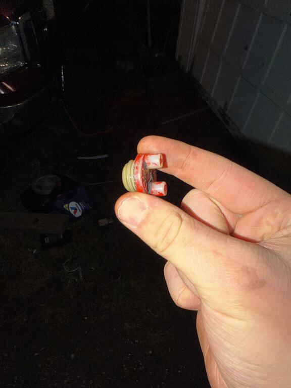

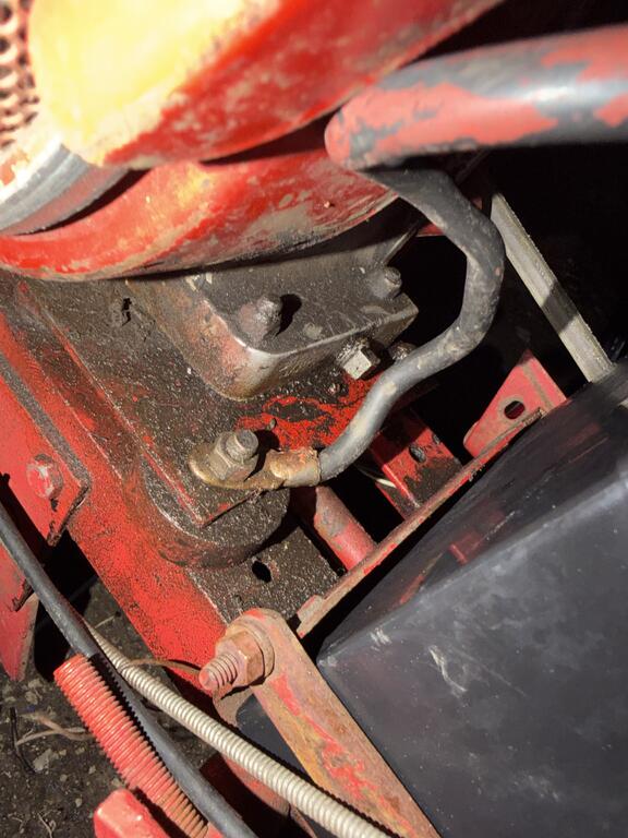

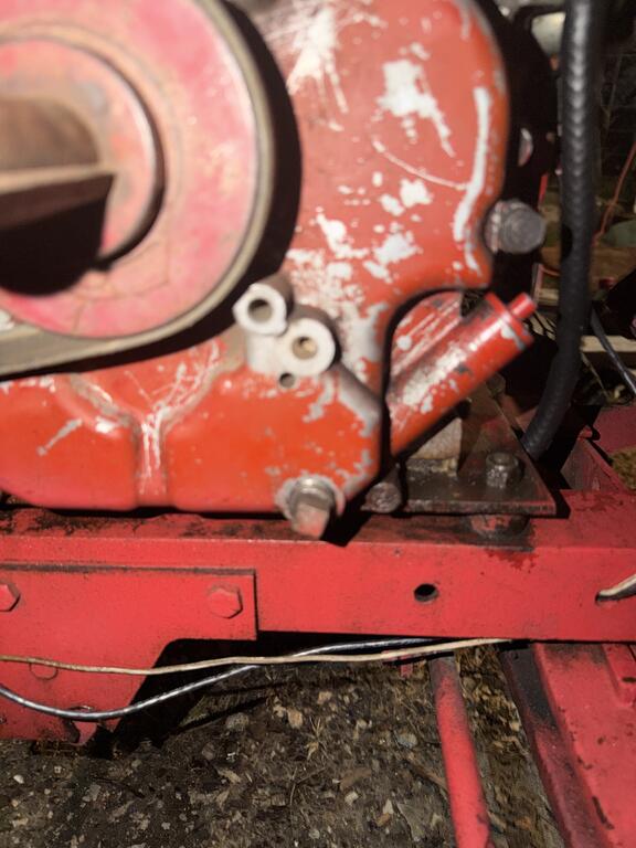

I am helping a friend repair his wheel horse 800 special (Briggs and Stratton magnetron 190434). He bought it from someone who had no business owning one. Anyways I found 3 plugs, one on the front of the engine, one on the right side of the engine, and one on the rear. The fill cap doesn’t have a dipstick. I believe the engine is dry, but I am confused on how I am supposed to check the oil. I will submit photos.
photo one (front plug/fill stem)image.jpg.ef3a8b23a8eb650c1f3ba276c6b9abf9.jpg

It's likely the plastic fill plug that shows the "Full" level.
It should be filled to the bottom of that hole.

Engine oil is Sae 30.     Not 10w30.  Full is when the oil starts to drip over the fill hole.

Just to supplement spot on answers above...
Many B&S engines had multiple ports so that at least one each of fill and drain would be accessible when they were mounted for use. The ones with the plastic caps are indeed the “Fill” ports and the ones on the bottom are the drains.
