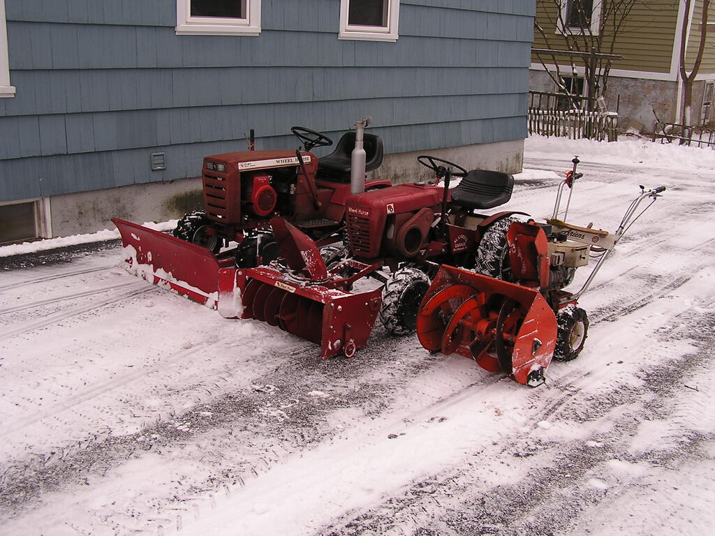

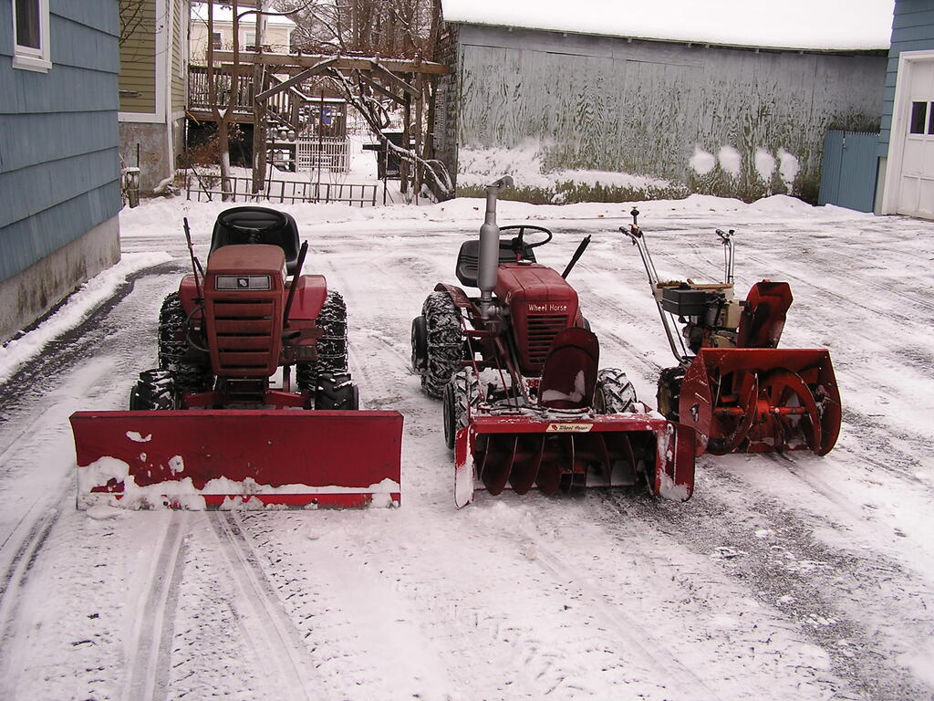

ri702bill 11,617 #1 Posted December 27, 2025 We got a few inches of the white stuff today, daytime temps in the 20's. Used all three of the seasoned "Snow Angels" - 1979 C81, 1964 854 8 Speed, and the 1976 Ariens 24" Snow-Thro. The Snow Shovel not shown has only 8 years on the job, gets an "Honorable Mention" ... 7 12 Share this post Link to post Share on other sites

sqrlgtr 2,395 #6 Posted December 28, 2025 7 hours ago, ri702bill said: We got a few inches of the white stuff today, daytime temps in the 20's. Used all three of the seasoned "Snow Angels" - 1979 C81, 1964 854 8 Speed, and the 1976 Ariens 24" Snow-Thro. The Snow Shovel not shown has only 8 years on the job, gets an "Honorable Mention" ... Great looking crew you got their Bill. Glad to hear they don't eat much either . 1 Share this post Link to post Share on other sites
ri702bill 11,617 #7 Posted December 28, 2025 24 minutes ago, sqrlgtr said: Great looking crew you got their Bill. Glad to hear they don't eat much either . They all have had their share of upgrades & modifications; they all have earned a place in the garage (the shovel has yet to get that respect!) 1 Share this post Link to post Share on other sites

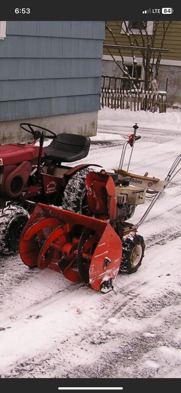

Terry M-(Moderator) 2,295 #8 Posted December 28, 2025 @ri702bill I like your older Ariens blower!! 2 Share this post Link to post Share on other sites
ri702bill 11,617 #9 Posted December 28, 2025 Terry - a little history on that unit. I received this from my sister and BIL back about 1982. It was his grandfather's, bought new and used to remove snow on the large driveway & walkways at the two 3 deckers he owned. My first modification - installing a steel backer and the two broom clips to hold a snow brush. The replacement skids now are thin pressed steel that are worn out after two seasons (yes, they are double sided and you can reverse them) so since there is enough height adjustment, I shape a strip of 1/4 x 1-1/4 Hot Rolled Steel to make a shoe & tack weld those on. The latest addition was to swap the still running but tired H60 with a nice freebie HH70 - huge difference! And I love having the plastic fuel tank as it will never rust. The original electric start H60 is now on my Troy Bilt chipper. Prior to acquiring my FIL's 702, this was the only gas-powered snow removal tool I had to clear my drive & walks for 10 years or so. About 2008 or so, I got another one - its all-original twin sister! It resides at my rental property. Remember that these were nicknamed the "Cat Killers" - NO safety features at all. You clutched it to switch speeds and to stop. Let the lever go and it takes off by itself if it is in any gear other than Neutral.!! Kind of like a 502! 4 Share this post Link to post Share on other sites

ri702bill 11,617 #13 Posted December 29, 2025 The troublesome component of these old machines is the Helicon Gear - the 1-piece gearbox input shaft / worm gear. NLA and used ones are pricey. Share this post Link to post Share on other sites
