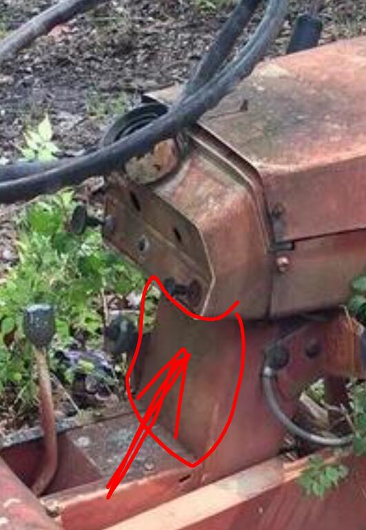

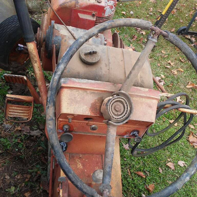

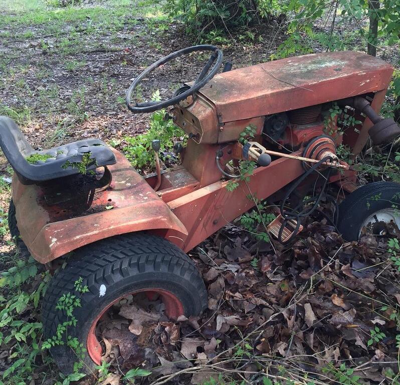

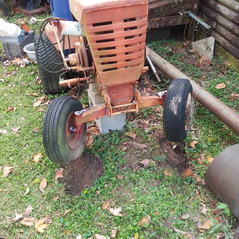

groundhog47 447 #1 Posted December 24, 2025 (edited) In 2017 Traded for unknown Wheel Horse, pictures will follow. It has set in my back yard as unloaded and I have searched all data I could find but have found members here have an eye for detail beyond printed data. Believe I have it narrowed to 1055, 1056, or maybe 1057. How I know it is 10 hp elude me, but in suntanning for last 6 yrs. in my back yard may have bleached engine decal if it had one when it arrived. It is 4 (edited) sp and came with a rope start cord in toolbox under seat fender. Rear axles locked up and shifter will only go back and forth, water probably filled transaxle. Anyway now that I'm getting back to normal, I see potential. Thanks for any help, and as said researched ALL DATA I could find Oh,yes vin ID plate/sticker on tractor and engine missing, painted over, or otherwise missing. Edited December 25, 2025 by groundhog47 5 Share this post Link to post Share on other sites
ebinmaine 77,245 #2 Posted December 24, 2025 Is there an ID tag here? 1 Share this post Link to post Share on other sites
groundhog47 447 #3 Posted December 24, 2025 (edited) 5 minutes ago, ebinmaine said: Is there an ID tag here? None unless painted beyond visibility, not even a raised portion for the sticky type tags. Edited December 24, 2025 by groundhog47 additional reply Share this post Link to post Share on other sites
ebinmaine 77,245 #4 Posted December 24, 2025 14 minutes ago, groundhog47 said: None unless painted beyond visibility, not even a raised portion for the sticky type tags. I think it should be a riveted tag? But I'm not sure. @WHX?? or @Achto Do you know? 2 Share this post Link to post Share on other sites

groundhog47 447 #6 Posted December 24, 2025 (edited) 3 hours ago, ebinmaine said: I think it should be a riveted tag? But I'm not sure. @WHX?? or @Achto Do you know? That was my thinking also. I will try a light rub of acetone in that area, don't have much to lose i suppose. And no tag plate on engine but see a remanence where coil would be affixed. Edited December 24, 2025 by groundhog47 additional reply 1 Share this post Link to post Share on other sites
kpinnc 17,117 #7 Posted December 24, 2025 3 hours ago, groundhog47 said: Believe I have it narrowed to 1055, 1056, or maybe 1057. I would agree. Probable 1055 or 1056. 3 Share this post Link to post Share on other sites

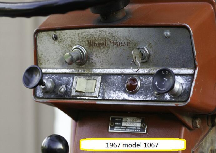

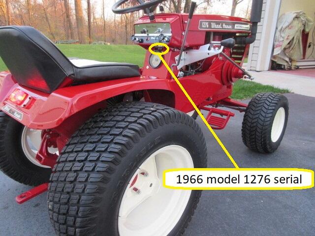

gwest_ca-(File Mod) 11,992 #9 Posted December 24, 2025 1965 VIN plate location 1966 1967 4 Share this post Link to post Share on other sites
groundhog47 447 #10 Posted December 24, 2025 11 minutes ago, gwest_ca said: 1965 VIN plate location 1966 1967 I will more closely inspect the tag areas, but did not notice any rivets or holes. That also rules out1067. Share this post Link to post Share on other sites
Achto 30,935 #11 Posted December 25, 2025 4 hours ago, groundhog47 said: Believe I have it narrowed to 1055, 1056, or maybe 1057 A 1057 would have had a cut out in the hood for head lights. If it did not have head lights, then the white plastic cover plate would have been installed. A 1056 would not have a cut out in the headlight area. A 1055 would not have the headlight cut out and would be a short frame with a length of 61 inches instead of the 65" length that the 2 above have. 3 Share this post Link to post Share on other sites
WHX?? 54,834 #12 Posted December 25, 2025 (edited) Steering wheel says long frame '67. Only models with that wheel were 953/1054 and 66 - 67 longs. Might find a very early 68 Raider with one. BTW those steering wheels are hen's teeth these days. Big battery box is pointing to a 10 or 1257. Very few mid sixties used it... 1076, 1077 & long frame gear jammer '67s. The motor has a tin on it that is not right for the year.. Should have a wrap around on the backside. Any ID plate on the motor that's readable? Dash tag is prolly gone but yes the two rivet holes would be there. Edited December 25, 2025 by WHX?? speeling 3 1 Share this post Link to post Share on other sites
WHX?? 54,834 #13 Posted December 25, 2025 27 minutes ago, Achto said: A 1057 would have had a cut out in the hood for head lights. Only six speeds had headlights in 67 Dan. 3 Share this post Link to post Share on other sites

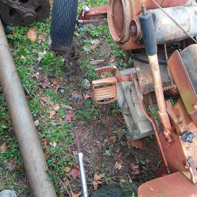

953 nut 64,049 #14 Posted December 25, 2025 That PTO tells me it is a 1057 as well as the mule drive adapter. 1 Share this post Link to post Share on other sites
groundhog47 447 #15 Posted December 25, 2025 36 minutes ago, WHX?? said: Steering wheel says long frame '67. Only models with that wheel were 953/1054 and 66 - 67 longs. Might find a very early 68 Raider with one. BTW those steering wheels are hen's teeth these days. Big battery box is pointing to a 10 or 1257. Very few mid sixties used it... 1076, 1077 & long frame gear jammer '67s. Tag is probably gone but yes, the two rivet holes would be there. I'm thinking someone is still smirking about the missing ID plates, but I don't give up easily. If they messed up ID on trans, which only removes the 1055, I'll still be guessing. Share this post Link to post Share on other sites
WHX?? 54,834 #16 Posted December 25, 2025 6 minutes ago, groundhog47 said: I'll still be guessing Guessing's over it's a a 10 0r 1257 fer sure. What yer plans for it? Even with the chunks missing that steering wheel is definitely restorable. 2 Share this post Link to post Share on other sites
oliver2-44 11,211 #17 Posted December 25, 2025 Those 7 slot hoods are not real common. Do it that helnarrow it down any? Share this post Link to post Share on other sites
Retired Wrencher 6,422 #18 Posted December 25, 2025 11 hours ago, WHX?? said: Steering wheel says long frame '67. Only models with that wheel were 953/1054 and 66 - 67 longs. Might find a very early 68 Raider with one. BTW those steering wheels are hen's teeth these days. Big battery box is pointing to a 10 or 1257. Very few mid sixties used it... 1076, 1077 & long frame gear jammer '67s. The motor has a tin on it that is not right for the year.. Should have a wrap around on the backside. Any ID plate on the motor that's readable? Tag is prolly gone but yes the two rivet holes would be there. I agree with you @WHX?? On the steering wheel I have only see that style on the 67`s. I have had two like that. May be a late change in 67? 1 Share this post Link to post Share on other sites
WHX?? 54,834 #19 Posted December 25, 2025 56 minutes ago, Retired Wrencher said: May be a late change in 67? Yes late 67 early 68. The 4785 was discontinued and replaced by the ones found on many tractors since. WH61-90 _399c Replacement Steering Wheel.pdf Share this post Link to post Share on other sites
adsm08 4,185 #20 Posted December 25, 2025 (edited) 14 hours ago, pfrederi said: 855...856??? Not an 8XX series tractor. Not as it sits anyway. Correct hood and fender pan, not an 8HP engine, looks like a 10HP maybe? PTO controls are also not correct to a K181 from that era. An 855/6 would have had a foot control, not a hand control as shown. That also points to a 10HP I believe. Edited December 25, 2025 by adsm08 Share this post Link to post Share on other sites

SylvanLakeWH 30,546 #22 Posted December 25, 2025 While the experts prognosticate on the tractor's original pedigree, please post the seat in the ugly seat thread. It has a very nice green patch... every little bit helps with global warming... 8 Share this post Link to post Share on other sites

groundhog47 447 #24 Posted December 25, 2025 17 hours ago, Achto said: A 1057 would have had a cut out in the hood for head lights. If it did not have head lights, then the white plastic cover plate would have been installed. A 1056 would not have a cut out in the headlight area. A 1055 would not have the headlight cut out and would be a short frame with a length of 61 inches instead of the 65" length that the 2 above have. I leaned toward headlight portion of grill but could find no pics of 1055 0r 1056 to lock it down. I'll check the frame length. 1 Share this post Link to post Share on other sites
groundhog47 447 #25 Posted December 25, 2025 17 hours ago, WHX?? said: Steering wheel says long frame '67. Only models with that wheel were 953/1054 and 66 - 67 longs. Might find a very early 68 Raider with one. BTW those steering wheels are hen's teeth these days. Big battery box is pointing to a 10 or 1257. Very few mid sixties used it... 1076, 1077 & long frame gear jammer '67s. The motor has a tin on it that is not right for the year.. Should have a wrap around on the backside. Any ID plate on the motor that's readable? Dash tag is prolly gone but yes the two rivet holes would be there. Yep, and sad the wheel at spokes have damage. Think I have 1 in other storage . Sold all my NOS ones. No engine ID decal or plate nor rivet holes. None on dash location, not even a humped portion where could be painted over. 1 Share this post Link to post Share on other sites
