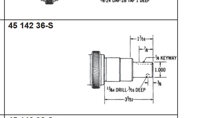

pfrederi 19,875 #5 Posted December 24, 2025 (edited) I don't think you can make this work with on your WH .. Shaft is way too short that spec # uses 4514236 crank (picture) most WHs have 3-1/2 to 4" shafts not 1-7/16 Edited December 24, 2025 by pfrederi Share this post Link to post Share on other sites
C_Owens 2 #6 Posted December 25, 2025 7 hours ago, pfrederi said: I don't think you can make this work with on your WH .. Shaft is way too short that spec # uses 4514236 crank (picture) most WHs have 3-1/2 to 4" shafts not 1-7/16 This was info I was looking for and couldn't locate. I would only need the drive belt pully but was not sure if shaft would be long enough. I appreciate it.. 1 Share this post Link to post Share on other sites
