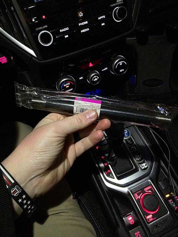

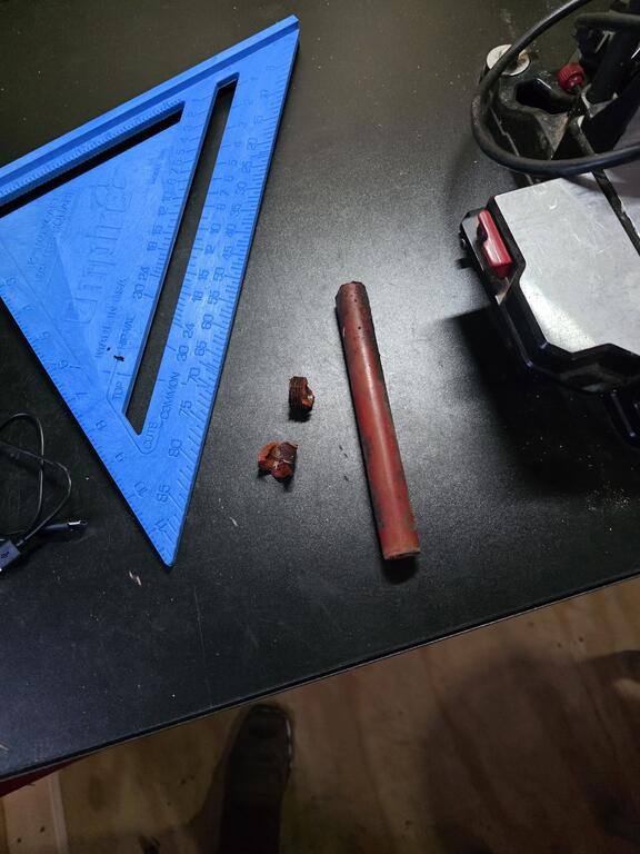

1987_WHEEHORSE312 82 #1 Posted December 14, 2025 Hey Guys! Merry almost Christmas! I went to check my transfluid earlier on my 312 and the dip stick tube broke off. Got the end removed and that is good. Now I have an empty hole. Can I put a bolt in it to get me through the winter, or had anyone had any luck making a dipstick tube? I'd rather not get a replacement one if there are other options as I'd rather do metal piping if possible. Let me know your ideas. I need something asap as its my plow tractor and its winter time. Also peep the new shed/shop! Thanks! 3 1 Share this post Link to post Share on other sites

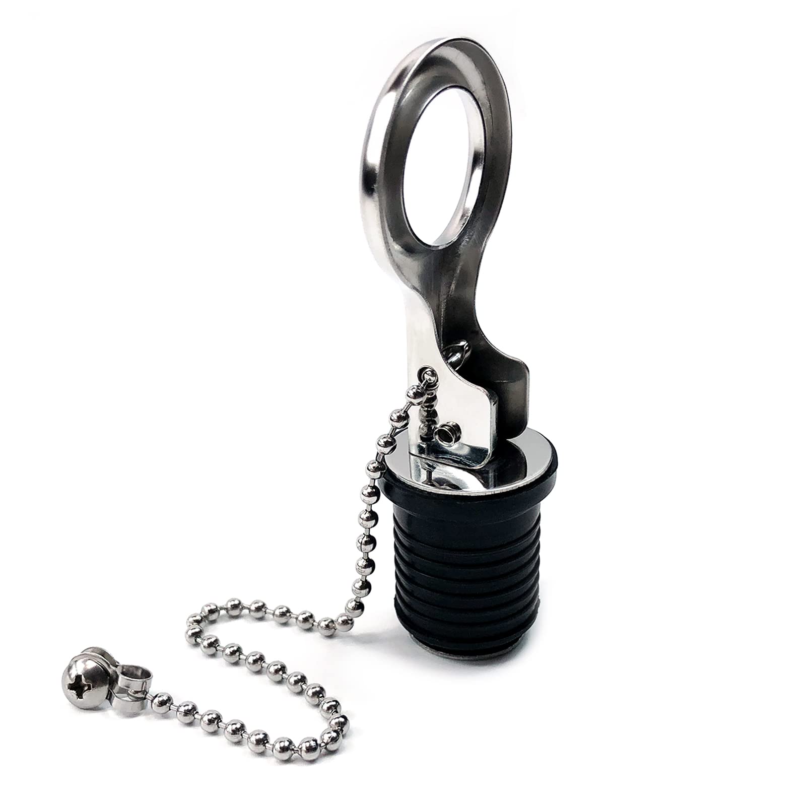

stevasaurus 23,631 #11 Posted December 14, 2025 A regular cork will work to get you through the winter. 1 1 1 Share this post Link to post Share on other sites
Ed Kennell 45,304 #12 Posted December 14, 2025 9 minutes ago, stevasaurus said: A regular cork will work to get you through the winter. or a transom plug. 2 Share this post Link to post Share on other sites
Bill D 2,677 #13 Posted December 14, 2025 1/2" pipe plug should fit. 2 Share this post Link to post Share on other sites
1987_WHEEHORSE312 82 #14 Posted December 14, 2025 7 minutes ago, Bill D said: 1/2" pipe plug should fit. 1/2 inchx8 inch black metal pipe does too! Just used that as an experiment and it works perfectly 3 1 Share this post Link to post Share on other sites
Bill D 2,677 #15 Posted December 14, 2025 I've often wondered if a piece of galvanized 1/2" pipe could be cut to the same length as the dipstick tube and used to replace a broken plastic dipstick tube? Anyone here try it? Would the dipstick seal snug in the tube? 1 Share this post Link to post Share on other sites
1987_WHEEHORSE312 82 #16 Posted December 14, 2025 2 minutes ago, Bill D said: I've often wondered if a piece of galvanized 1/2" pipe could be cut to the same length as the dipstick tube and used to replace a broken plastic dipstick tube? Anyone here try it? Would the dipstick seal snug in the tube? Yes I just did, home depot sells them 8 inches long just like the OEM tube length is. Works perfect. 5 3 1 Share this post Link to post Share on other sites
