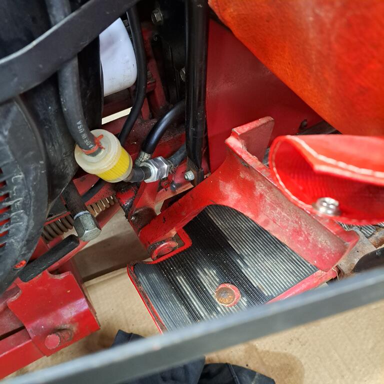

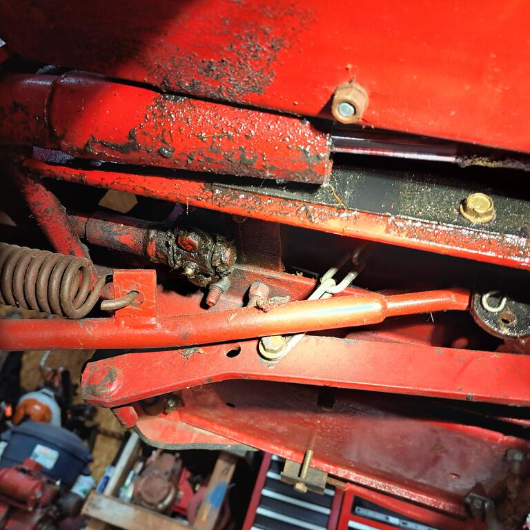

WHX?? 53,286 #1 Posted yesterday at 02:14 PM On one of my single purpose snow machines. Been leaking for quite awhile & I have a kit to fix it. Not sure if I want to lay the tractor up to fix it or not. I fear if oil can come out dirt & crap can get in. Is it a job to get it out and rebuild? Got a cab on it and the left side would have to come off along with the floorboards and covers. Is it a a pain to get the hoses off or can a guy do it in place? If not do the hoses have to come off at the valve or the cylinder? Trying to get some info before I tie into it. Cab discomboobled for oil change. Sure does make a mess on the under carriage. Share this post Link to post Share on other sites
JoeM 9,302 #2 Posted yesterday at 02:26 PM I did one on the machine by taking out the pin and lowering it down, but the floor board and side panel was off. Taking off the clevis on the rod end can be a little of a challenge. Probably not dirt getting in since it is pressurized. Unless it is running out, lever b till spring. could wrap it in an pig mat until you get to it?? the hoses are o-ring and come out easy, 1 2 Share this post Link to post Share on other sites
WHX?? 53,286 #3 Posted yesterday at 02:30 PM 1 minute ago, JoeM said: ever b till spring. If I lever b till spring I'm gonna procrastinate and put it away and do nothing ... 3 Share this post Link to post Share on other sites
WHX?? 53,286 #4 Posted yesterday at 02:33 PM 4 minutes ago, JoeM said: clevis on the rod end Guessing the clevis is screwed on the rod end? I have a extra cylinder from a parts machine guess I should play with it first maybe. 3 Share this post Link to post Share on other sites

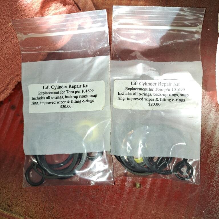

lynnmor 8,232 #7 Posted yesterday at 03:46 PM Does your cylinder kit include o-rings for the hose ends? You might be getting a nice oil bath from there. Share this post Link to post Share on other sites

ri702bill 10,557 #11 Posted yesterday at 06:12 PM 3 hours ago, WHX?? said: dirt & crap can get in. Probably not. The oil is under pressure and is getting by the rod seal, only thing outside is atmospheric pressure. And it is a horizontal application... "Cleanup in Aisle 5" !! 2 Share this post Link to post Share on other sites

Handy Don 15,139 #14 Posted yesterday at 07:22 PM (edited) 4 hours ago, WHX?? said: Guessing the clevis is screwed on the rod end? I have a extra cylinder from a parts machine guess I should play with it first maybe. Some are screwed on and some are welded. First, though, get a good look at the rod end exit of the cylinder and be sure the end cap is held in with a spring clip. More than a few cylinders are welded together and we’d hear the “Navy" blue language all the way here on the east coast if you got into it before discovering that. I also vote for let ‘er be but set yourself some real penalty for not having it done before the Big Show! Edited yesterday at 07:22 PM by Handy Don 1 Share this post Link to post Share on other sites

lynnmor 8,232 #21 Posted 20 hours ago 3 hours ago, WHX?? said: You tell me I think I got the kit from you. Got a couple one for the shelf. They are included, see "fitting o-rings" I didn't see our transaction after a very brief search. You should be good to go. 1 Share this post Link to post Share on other sites

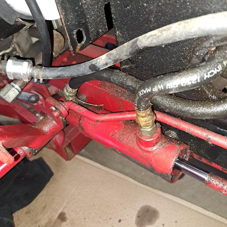

WHX?? 53,286 #22 Posted 16 hours ago Not going to rebuild at this time. Seems the control valve is leaking quite abit so not even sure if the cylinder is. Maybe just running down on it. Maybe even a hose leaking. Going to clean it up as best can, leave the covers off and see if i can spot exactly where it is. Keep an eye on the oil level. I have a spare valve so maybe look that over and use it. 1 Share this post Link to post Share on other sites

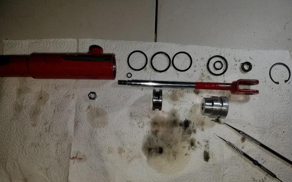

JoeM 9,302 #23 Posted 9 hours ago (edited) If your valve spool is leaking, the lift valve has two o-rings on the spool. 5/8 od x 3/32 thick. You have to remove the internal snap ring opposite the lever and the spool pulls out that direction. It is easier to hold the valve on to get more room to get on the snap ring. I fixed a leak-r last week. l was able to remove the spool with the valve on the machine. But it did not have the onan engine it has a replacement kohler mag. Some of those valves are a devil to get off. Edited 9 hours ago by JoeM 1 Share this post Link to post Share on other sites

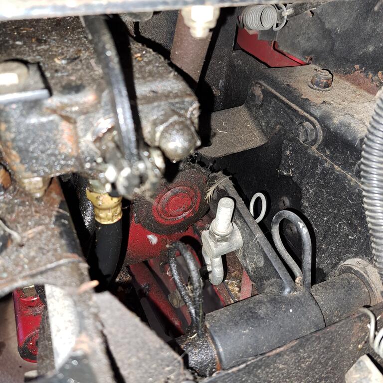

lynnmor 8,232 #24 Posted 6 hours ago Looks like hoses or their o-rings. If you need to drop the valve, remove the battery and it’s tray, then you will see two holes that a skinny 7/16 socket can be lowered to the two bolts, hold the other end with an end wrench. 1 Share this post Link to post Share on other sites
Brockport Bill 2,122 #25 Posted 6 hours ago are you asking about a leak of the lower cylinder by the foot rest --- or the main valve unit inside the hoodstand? The lower cylinder is relatively easy to remove and install new O rings in it -- however the main valve unit inside the hoodstand on my C175 was brutal to remove ( i did new O rings and new hoses ) 1 Share this post Link to post Share on other sites
