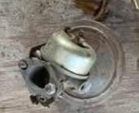

FLtractor 110 #1 Posted December 13, 2025 (edited) Carb off a 1962 Cub cadet.. will this work on 856? Need more better info? All i have so far is picture Edited December 13, 2025 by FLtractor Share this post Link to post Share on other sites
pfrederi 19,727 #2 Posted December 13, 2025 If it was an 8hp Kohler Cub it probably will fit...Choke may work backwards 1 Share this post Link to post Share on other sites
ri702bill 11,128 #3 Posted December 13, 2025 (edited) Look inside the carbs - yours first - behind the choke plate. Up on the top there is a 2 digit number like 20 or 22. That refers to the airflow sizing. The larger the number, the more it flows. Replacing yours with an undersized K91 style is a waste of money. Externally they are the same & look the same... Edited December 13, 2025 by ri702bill Share this post Link to post Share on other sites
Howie 900 #4 Posted December 14, 2025 That looks like a Tecumseh carb to me. Share this post Link to post Share on other sites
